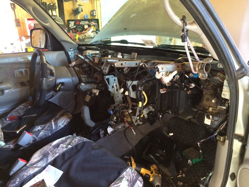

    Wasn't AS bad as a I thought, but I don't wanna do it again. Heater core replacement. However I am learning more about this truck than I would have with the other one, and the power and economy of the 3.4 is fabulous and I am really getting to enjoy the auto trans. Sometimes I think it would be COOL to swap to the 5 speed, but not worth the hassle. I am really getting to the point that I want to add some larger, more aggressive tires, but I think I will be waiting until after Christmas for that. :(

    It's like a scene from a TV show like ER or something - all guts in the operating room. Put some "easter eggs" back in there for some new owner one day to find if they ever tear it down like this. Like a little treasure map rolled up and zip tied to some part deep down in there, that leads them to a steel nickle or something you hide. Be cool! Or is that just my wired thinking? :D Every concrete block wall I have ever built - I toss in a few pennies or nickles in a block that does not get core filled, just in case some future dude tears it down and goes "Holy hell, a 100 year old nickle!!!" Better yet, "Blimeny, a 500 year old extruded metallic form of payment!"

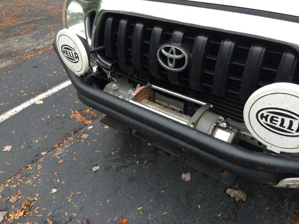

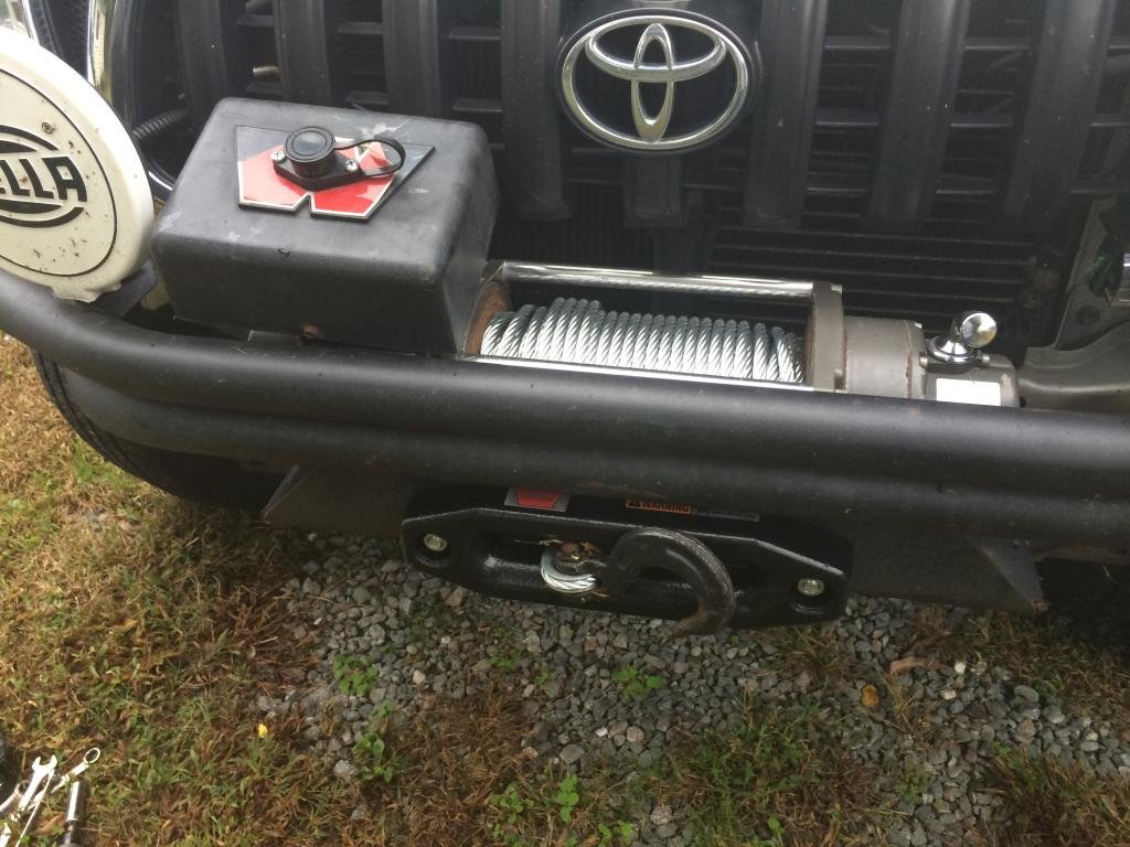

    Got the winch fully installed with new cable and Warn steel Hawse fairlead.
    It is a little noisy running in and out, but I will break it down this winter and rebuild it.

    Sweet. Didn't need to cut your grill too!

    No John, it has been cut. I don't think you can mount the solenoid box without it. I didn't feel like adding abunch of extra work and money to do dash switches right now and also didn't really see a good spot in the bay for the box either. Gives me a reason to pull and paint the grill black now:)

    Ha, I guess you just measure/ cut better than I do. Looks great.

    Thanks bud. I used a small Japanese style pull saw and it fit great between main parts of the grill. Trimmed a little at a time until it fit well.

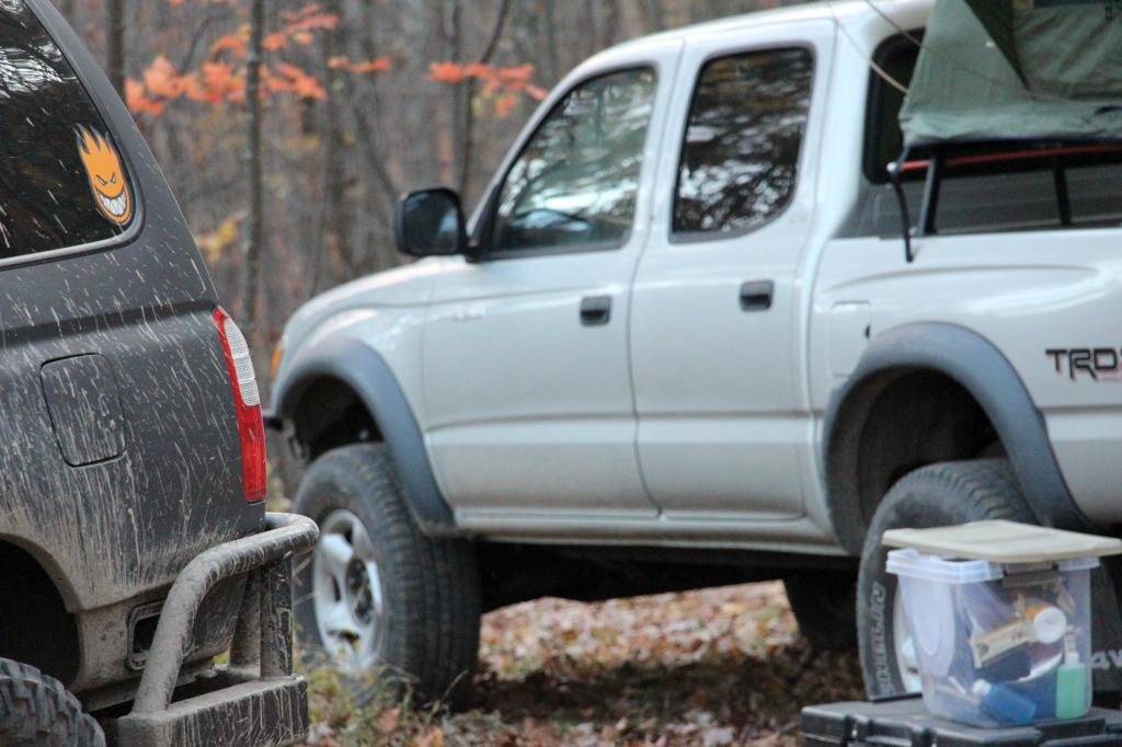

    Some fun use of the truck finally...
    We had two gens of Tacoma and two of 4Runner there this wekend. '03 and '14 Tacoma and '95 and '98 'Runner.
