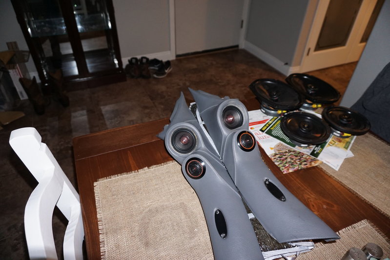

    A pillars are filled, just need to make some grills for the 3's. Old Memphis speakers next to the pillars.

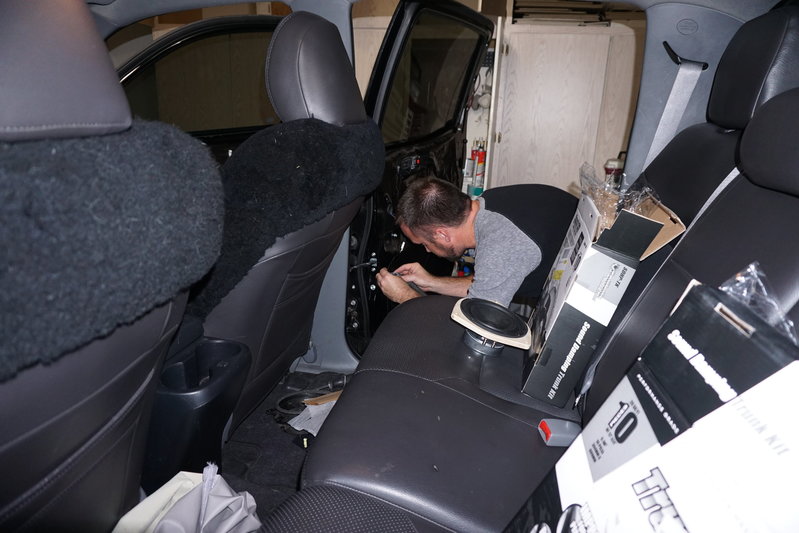

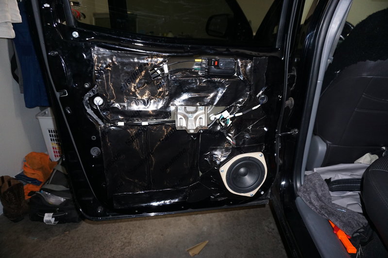

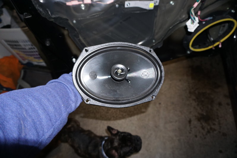

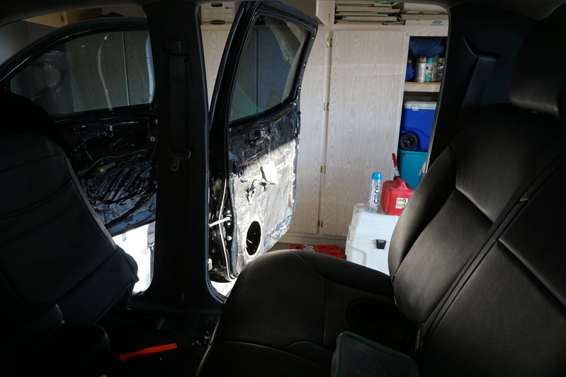

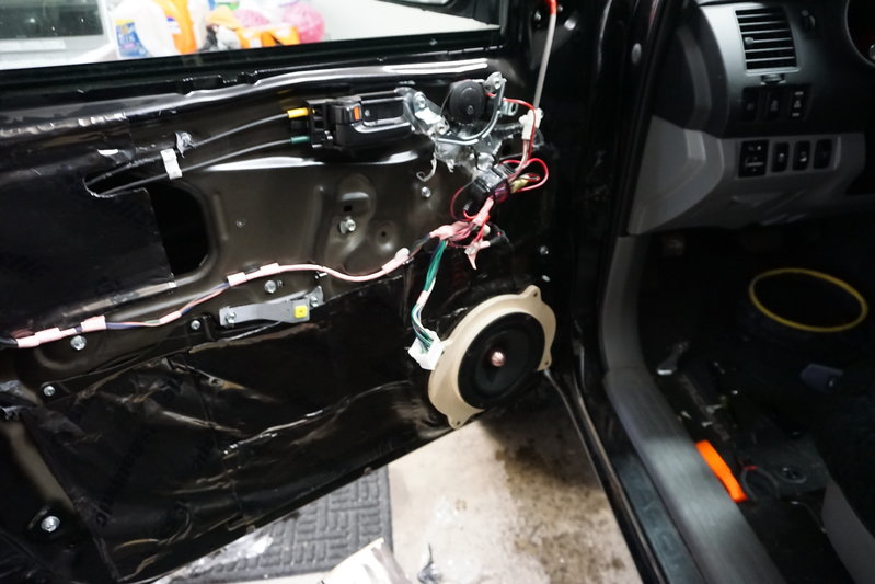

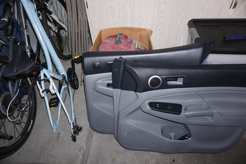

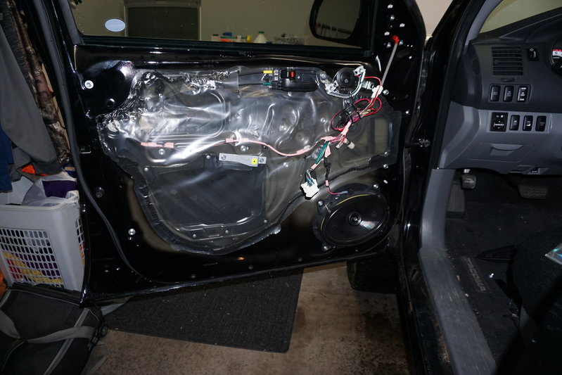

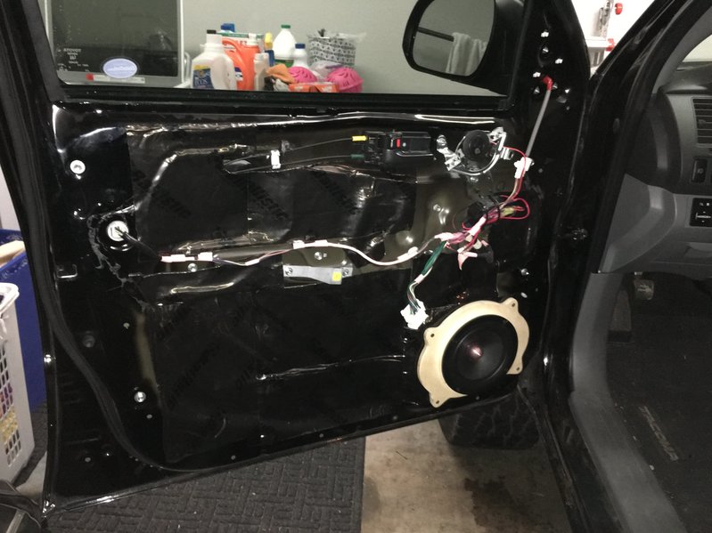

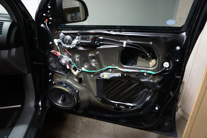

    Back door is almost done I need to drill a whole in the door panel and run wire for the tweeter.image.jpg
    The tweeter was taken out later and I forgot to take a picture before I put the door panel back on.image.jpg
    My usual shop fired the guy who did my system last. Usually they put more sound deadening on the doors!image.jpg
    Starting to put sound deadening.

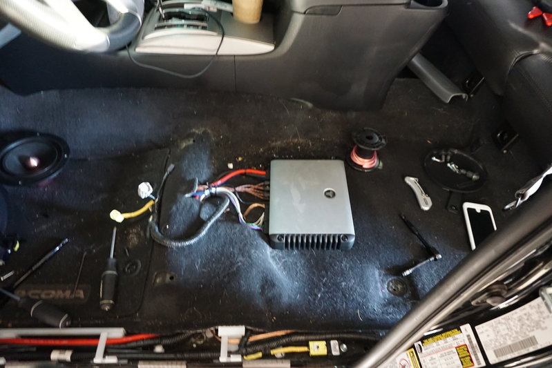

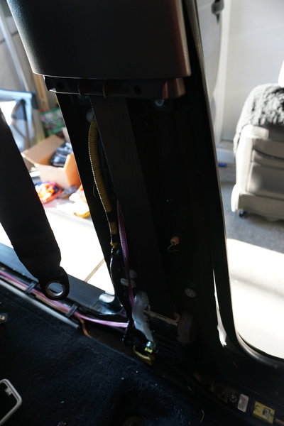

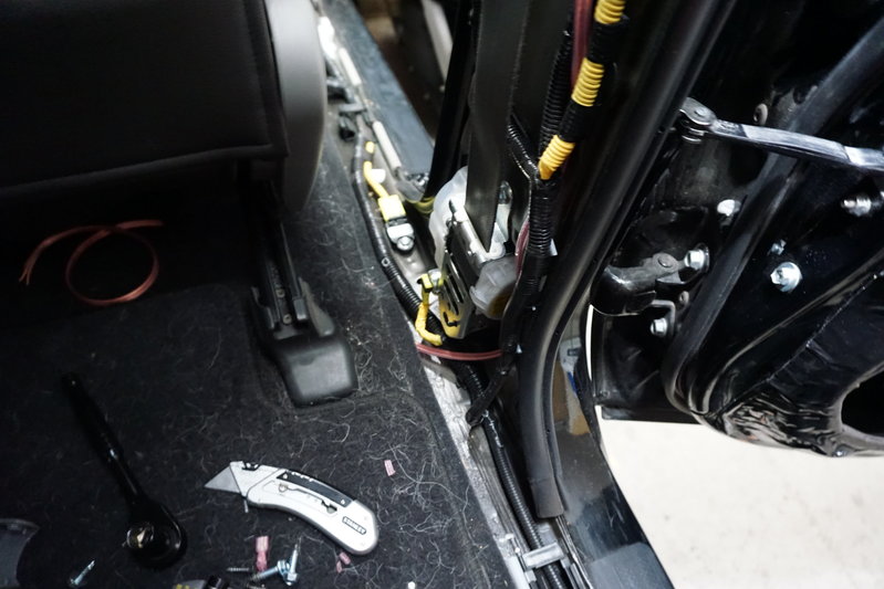

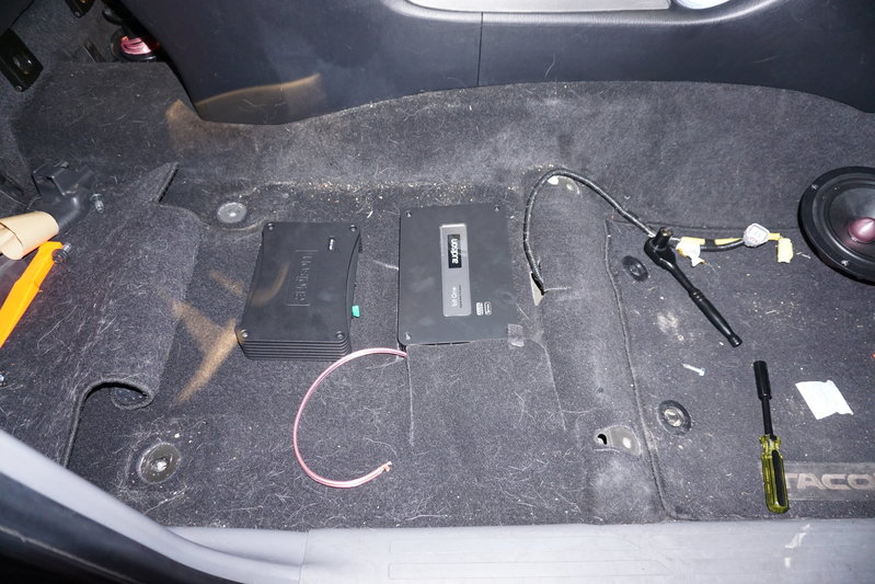

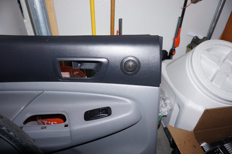

    Did a few things today in the two hours of free time I had. @zinger i decided to pull the speaker adapters back out and painted them black, after I put the door panels back on I could see the wood and didn't like it. image.jpg
    Ran my speaker wire to the location of my prima amp.
    Tweeter wire for the driver side.
    Bit one and prima amp are going under passenger seat.
    The old HD 900/5 amp. I'm going to put the arc 2 channel amp along with my distribution block right here. I'm going to have a 0 gauge to the block, 8 to 3 of the amps and a 4 going to the mono block. I'll probably have a 10 to the bit one.

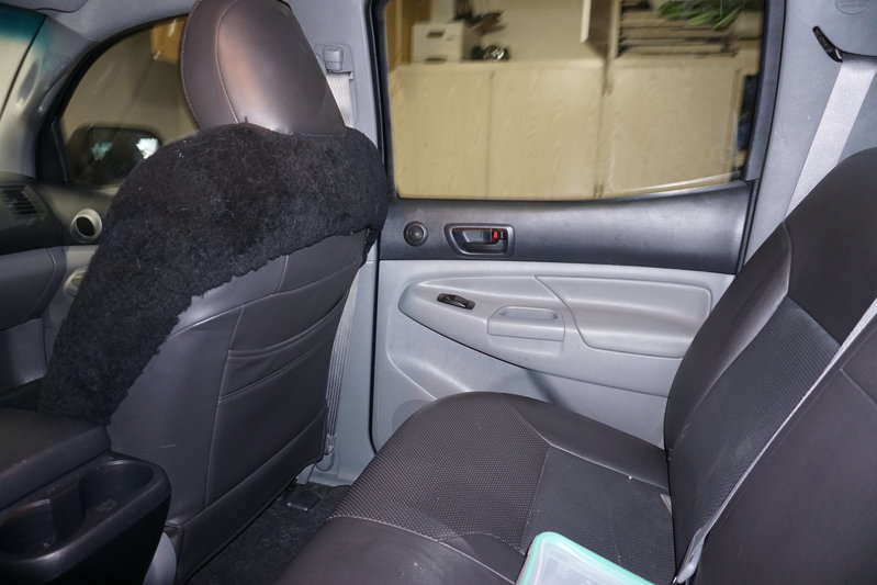

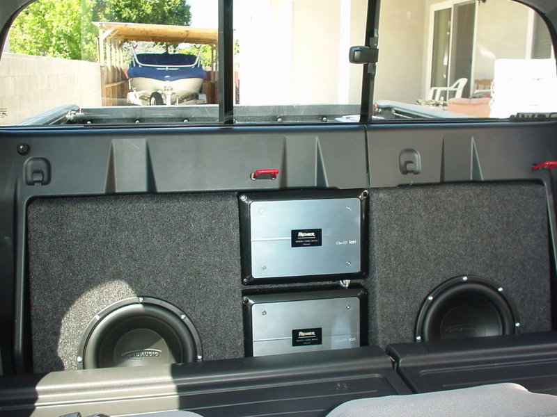

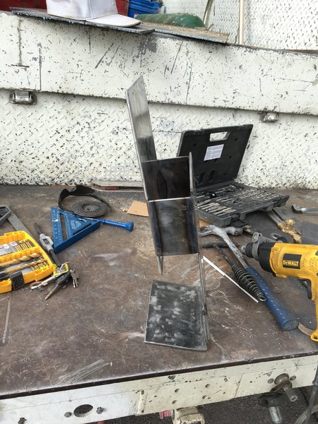

    I have a really good installer that usually does my stuff, but there was so much going into this that I couldn't see spending what they want to charge. I am going to bring it to them to design my box and amp rack. I designed and built one, but I didn't like it once I put it in the truck.
    Here's the rack I made, but once I get the box in there, there won't be any room to adjust anything.image.jpg
