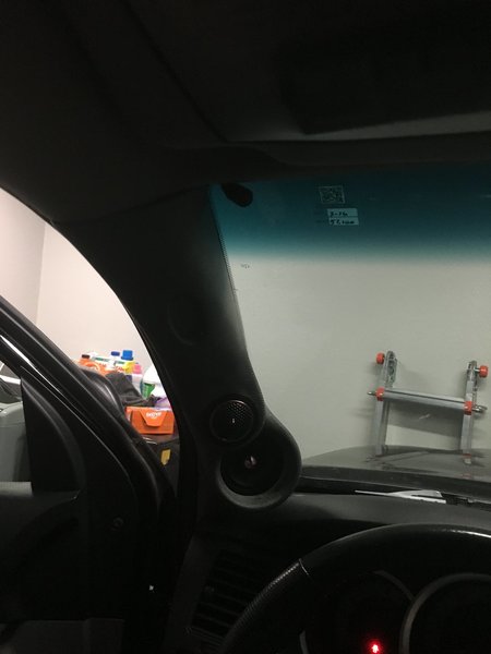

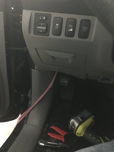

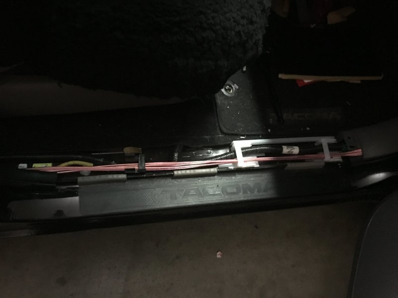

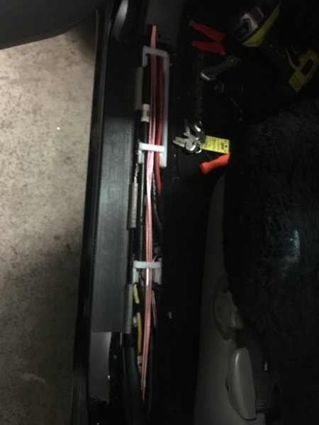

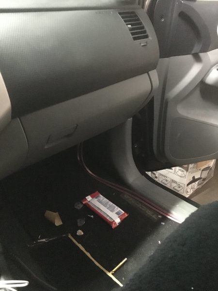

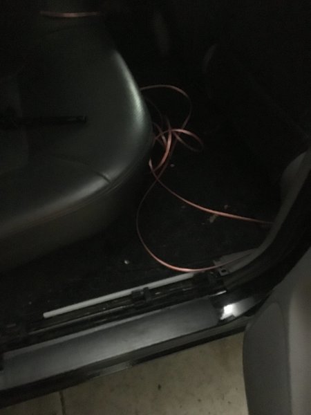

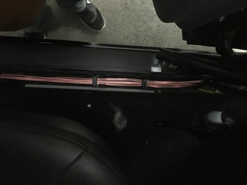

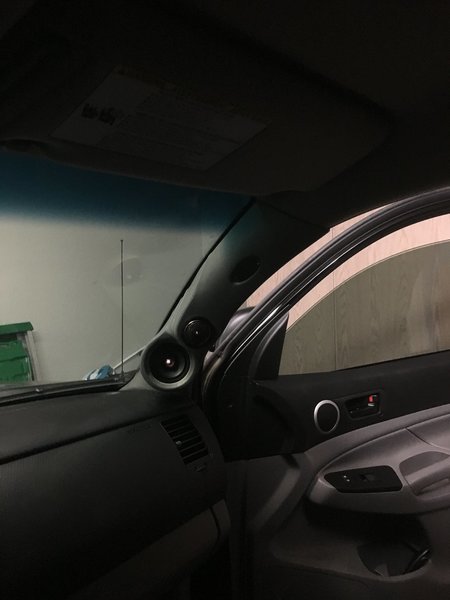

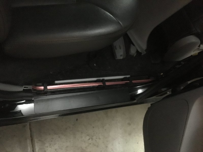

    Update....had a little time to fiddle with the A-pillars a little bit. Ran all the wire to the back of the truck for the Phoenix Gold amp. I'm starting to worry that I won't have enough space for the amp power wires along the running boards. I may have to run the 8 along the driver side, then have the 4 go back to the console, over to the passenger side and back......what a pain
    Anyways, hers some pics!image.jpgimage.jpg image.jpgimage.jpg image.jpgimage.jpg image.jpgimage.jpg image.jpg

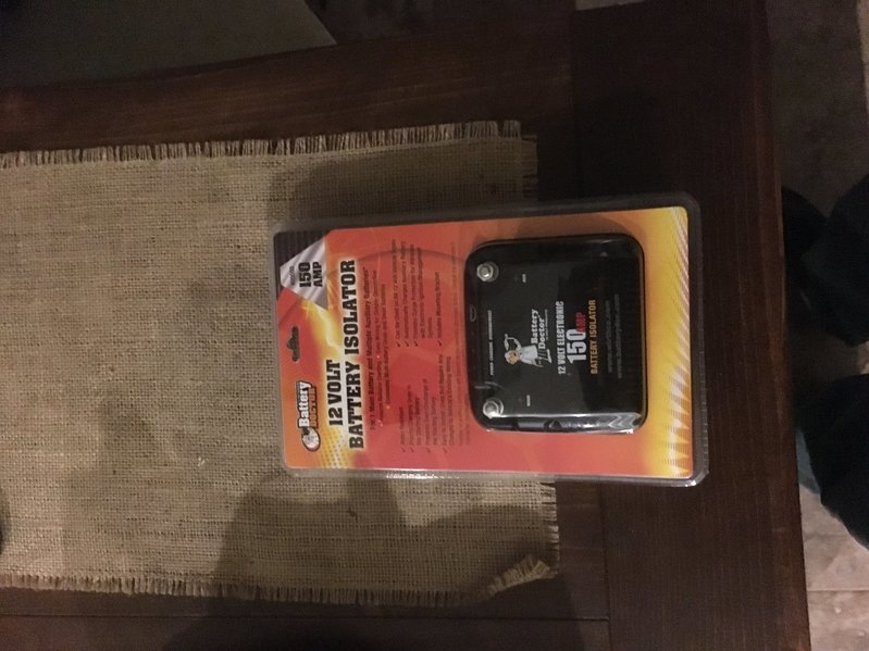

    i prefer my wires down the centre.

    Looking good. Where did you get those pillars?

    I got them from another member in the forum. He got them from top acoustic. From what I understand they are difficult to get from them because they don't ship. (They are grime Taiwan)
