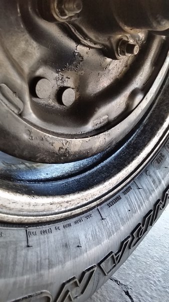

    20161113_124622.jpg it happens again this is my 3rd time doing this jod . this time smell like grease only no no differencial oil yet . i know is my bearing going to try again .:frusty: any advice guys ? i dont want to take it to steelership . i got an oem seal now .

    There's 2 seals on these trucks. An inner and an outer. To replace the outer you have to remove the wheel bearing which is a bitch. I would only use OEM seals, but you may have a burr or an warped axle shaft killing the new seals. Could also be damaging them on install if you put any weight on the seal.

    Thanks for ur response . the first time i did the work i change the outside seal . but the bearing is going out sooner . it work good for a month . so maybe i need a axle shaft ?

    Only thing I can think of is either an improper bearing install, bent shaft, or poor quality bearings. If I were you guys I'd stay either OEM or try to get some timken bearings and races. I think rockauto sells the Timkin bearings
