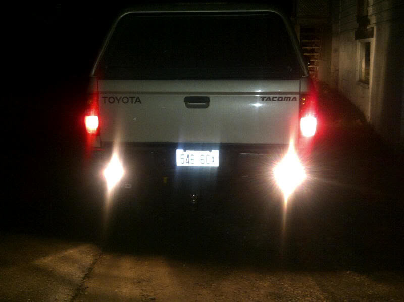

    My 1st gen reverse lights do not really light up the area behind you so I decided to install my own lights.
    Now I can see when backing up!!

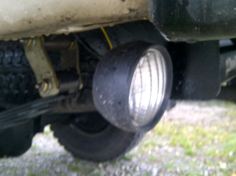

    These are just low wattage tractor lights in rubber casings:

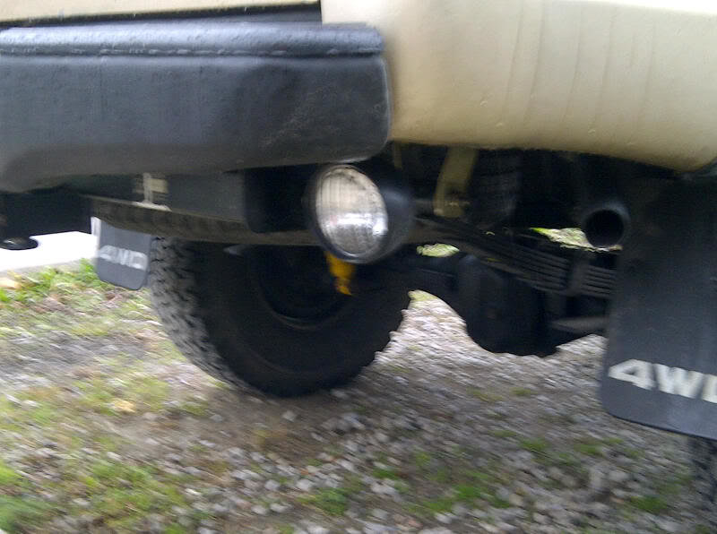

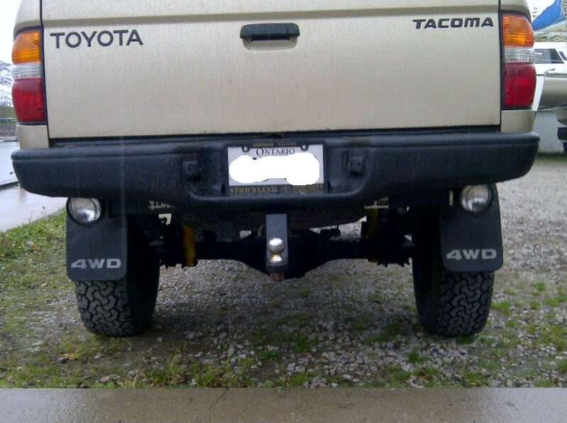

    Drilled holes in my trailer hitch frame for a mounting location:
    Did not wire to the actual factory reverse lights as I wanted them on a toggle to use as auxiliary lights as well.
