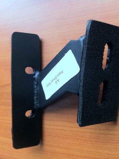

    Pic of new mount for those interested. the mount sits fully in the channel vs hanging over either edge on the original design.

    I know this is an old post but I just a thought.... The brackets that mount to the roof line look pretty simple. If someone was able to measure and share the sizes of those brackets, I'm certain several of us could fabricate our own brackets. Then we would have the option to mount other, less expensive brands of baskets.

    Do you own a tape measure? yank the channel covers and measure the holes....
    There are 4 different brackets, all of them are specialized to their location.

    I would measure your own or make sure you account for a little margin if you take measurements from someone else. I found when designing my roof racks that the holes varied slightly from truck to truck on where they were in the channel. Not by much but if you are trying to be precise you will want to check.

    More interested in seeing what the measurements are in between the 90 degree bends and the overall height of the bracket. I may have to go and buy a tape measure though, lol...

    x2 A few years ago I had a candid conversation with the owner of BajaRack, Sergio at his office in San Diego, and he intimated to me the exact same thing. i.e. variability from the Toyota factory.
