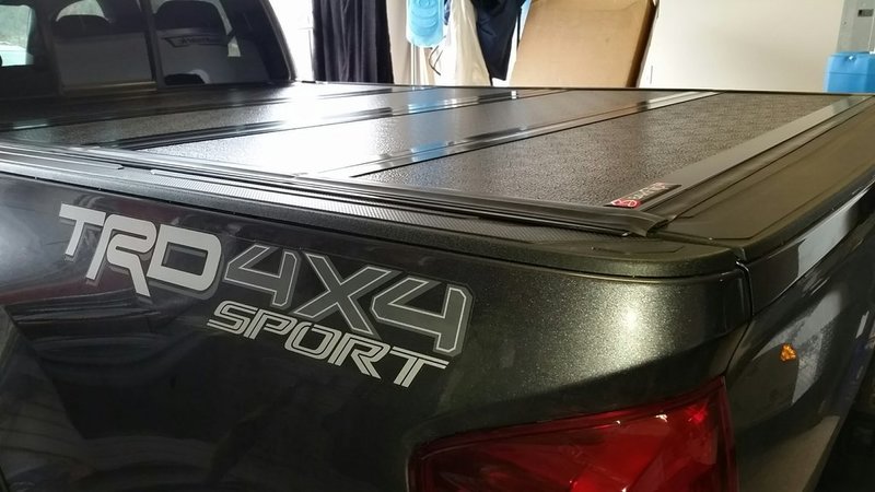

    Sorry to hear all the issues out there. Had an enjoyable F1 long bed install here in Massachusetts. Couldn't slip a piece of film in there at the tapered end. All the parts came in the package too. So I was excited right off the bat. Not saying there isn't a problem with some of the installs I've read about on this forum, but I'm def satisfied (for now). We shall see in the spring when the rains come. Good luck to guys.

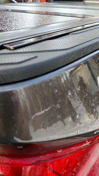

    Well after all of this I am not unhappy with my install either. Of course I shouldn't of had to spend as much time reworking the tailgate end of the gasket but in the end I don't think I could really have asked for too much more.
    Yes all the proper parts were there.
    Yes there is a slight slope to the last section of the side rail cap.

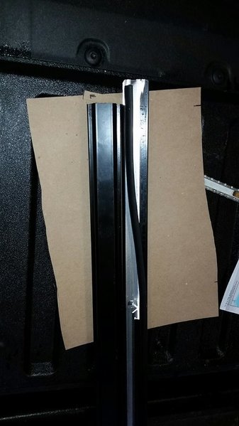

    The gasket causes the last section of the rail to ride up on the cap kick out. So I marked out cardboard template tracing the curve of the kickout.
    Then I hit the rail with the heat gun for a bit to release the gasket adhesive. Once the gasket was free I re-routed it to follow the curve on the cardboard template. You will note the gasket does not go whole was to the end of the rail now that it must travel a greater distance. Maybe this will be a problem later, maybe it won't.

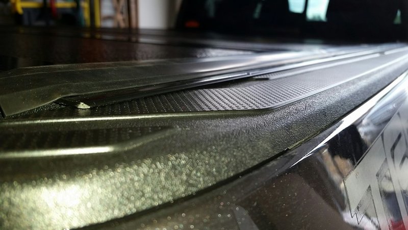

    Other than the slope to the rail leaving not even 1/32 of a gap I think it's sitting about as good as it's gonna get. As the weather warms up I will try to readjust the back mounts and snug them up on the gasket more
    I think the whole gasket rework took me about and extra 45 minutes to measure, mark up a template, cut it out and move the gaskets.

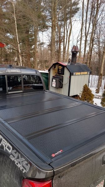

    FedEx dropped off a replacement pair of rails for the Revolver X2 today. Weather was perfect for installing it, cool 66F and plenty of sunshine. Not being much of a DIY person, the install probably took me longer than it will take most. Took a drive to a local Harbor Freight to buy a T30 drive bit and a ratchet bit driver that would on the torque wrench I bought; cost roughly $38 for all the tools.
    Good news is the delivery was a matching set, no defects, rubber seals in place. Bad news is I didn't get it perfectly evenly lined up. I'm probably going to leave it as shown below.. too much effort to do it over. Gonna take the Tacoma to get washed for the first time since I bought it back in December. Will post if the cover leaks.
