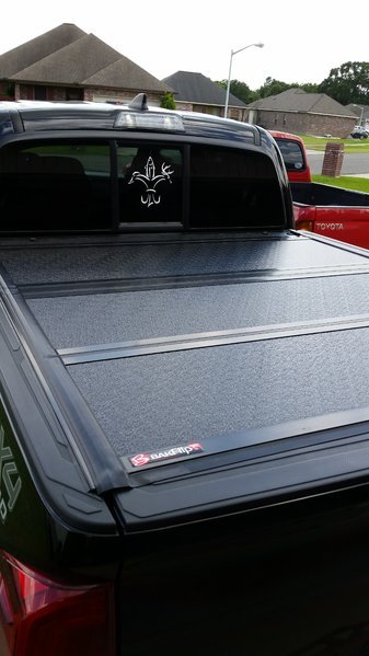

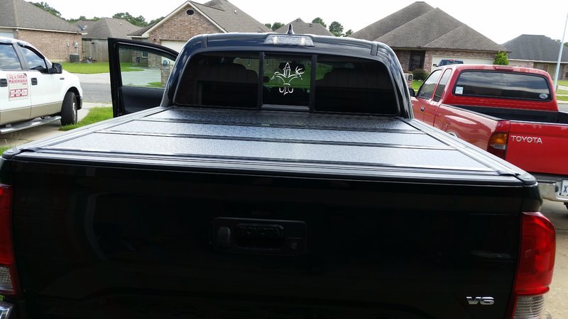

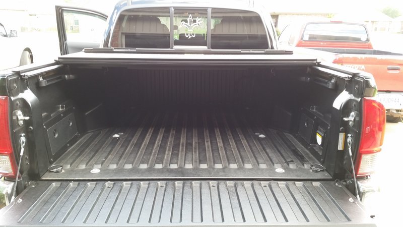

    Got my bakflip fibermax this week thanks to Morrie "https://www.tacomaworld.com/members/rockinroad.41734/"
    Great customer service gave me a good deal and had my cover and pop a lock from him in in less then a week!
    Install was easy but took my time with tge heat we have here took me 4 hours! On the pop a lock I followed the directions of one of the members on her since it didn't come with any. Routed the wire to the passenger kick panel on the video he showed to spike the greend wire from the actuator to the red and blue to green on my trd off road that was backwards! Lock when I unlock the doors and unlock when I lock em! Swapped the wires and all works good!

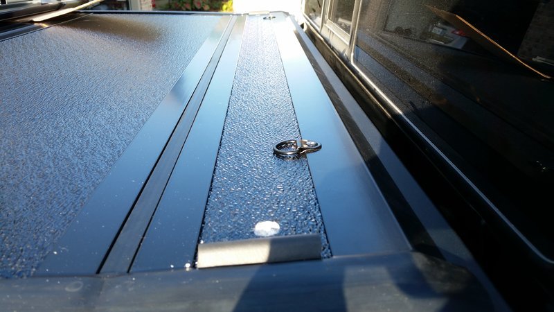

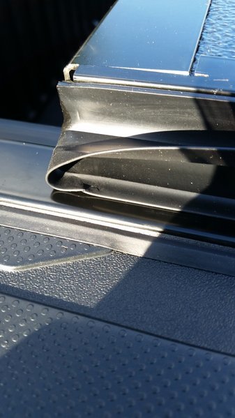

    On the right rail system rubber seal that was a little tare I didn't know if it was serious enough and if I should call back about it I sure don't want to send the cover back! Also I thought there was a clip and a strap to to hold the panels in open position but it didint come with any just 2 little hoops shown in the pictures
