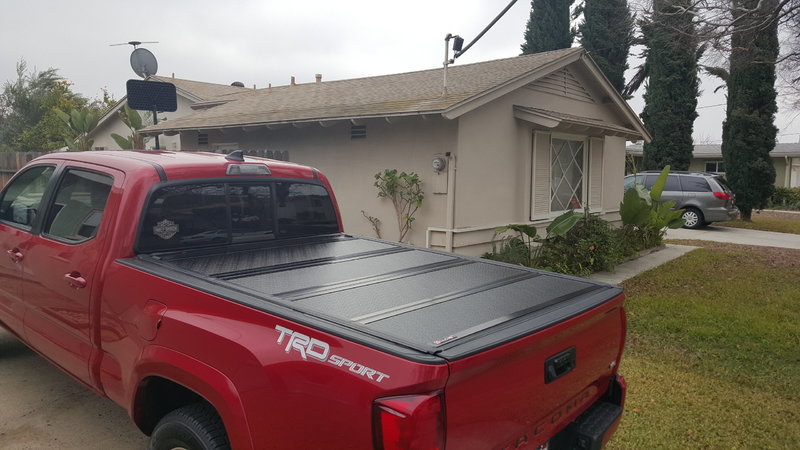

    Put it on in less than an hour but have to take the wife to the DR. Love the new rail system and will post when I get back home. Will also comment on the install. In the mean time... here's a pic

    Can we please get some pictures of the inside bed rails!!!!!

    Your truck is dirty. Go do a car wash test. LOL

    Ok, so I am back. The 2 boxes arrived from FEDEX with no damage. The panels are packed in formable foam so there is no plays in the box. Great pack job. 20160118_125351.jpg 20160118_125357.jpg The instructions have a 16 Tacoma(long bed) addendum that is fairly easy to understand. I was expecting the old rail and was surprised by the new system. The only tools required is a torx 30 and a utility knife. Pull off the head rail an instal the side foam so it doesn't leak there. Istall the top rubber to the header and then to the rails. Remove the 5 screws for the existing rails and install r brackets onto the new rails. Hold them up and install into the existing holes with the new screws. Then attach the original rails to the 5 brackets with new screws. Once that is done you put the top on, align and tighten down. Fits like a glove.
