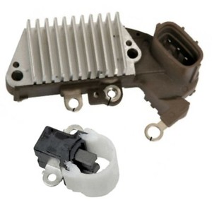

    A 2000 Tacoma still has a voltage regulator. If the alternator is good and it isn't charging the battery that is the first thing I would look at.
