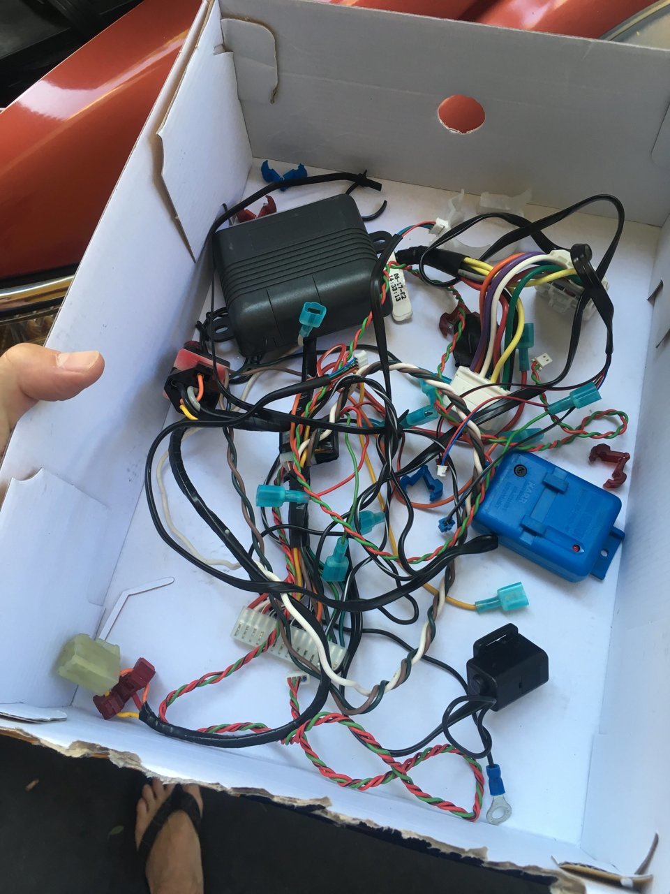

    A delayed update on my parasitic drain situation. I ended up taking my truck to a local retired "master" Toyota technician. He only takes on little projects which he thinks are fun for a bit of cash.
    So, it turns out my totally stock '03 was not actually "stock" after all. I had an aftermarket alarm system which I assumed to be part of the original factory system (I couldn't tell any difference as it used the same stock key fob and I never questioned it). Even though I had narrowed down the circuit to the "Dome" circuit, he felt the best corse of action was to get it back to stock (as it practically was). So after the basic electrical checks passed, most of which I had already done, he commenced to remove the aftermarket alarm. (interesting side note, he said that dealerships often subcontract out things like aftermarket subsystems (i.e., alarms) even though the work is carried out at the dealership by different technicians. That sounds pretty crazy to me, but I'm not too familiar with that world)
    Here's the photo of the "tumor" he pulled out from under my dash in a matter of minutes... Doesn't look like much, but when you think about how tight the space is under the dash it adds up quickly. It was cool to watch him identify cables that should not be there in a matter of seconds--pretty impressive. I would never think about cutting out wires from under the dash in modern vehicles.
    It has helped a bunch in how long I can keep it parked without jumping it, but I think there is more to go... I need to recheck the present parasitic draw, but it's 80% better.

    kind of a "standard" practice at dealerships when the factory didnt have an alarm. In my day it was Clifford, the kind with the number keypad. It was the job of F & I guy to up sell the alarm at an obscene markup and if you insisted that it be removed, they removed the fuse that activated it and kept the FOB.

    @Glamisman, Yeah, I got the feeling he didn't like the fact that the dealership was doing it. He didn't speak too highly of the quality of work that would come out of the subcontractors--apparently my alarm wiring was a clear case of this. I'm sure this isn't the case at all dealerships but he wasn't a big fan of that and he worked 30+ years at one. (by the way, he couldn't speak highly enough of the 1st Gen Tacoma in general)
