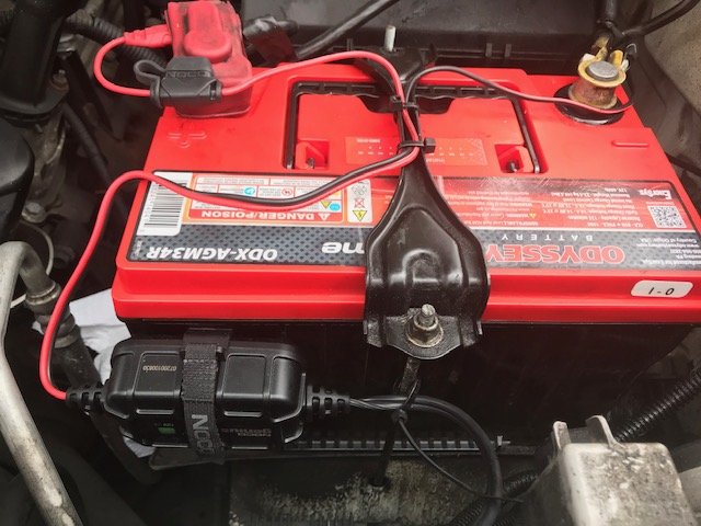

    Odyssey extreme group 34R. 4 years this January and still going strong...
    Added the 1 amp diode mode to boost the charge voltage to the 14.6 volts this AGM desires. I used the original hold down bracket but had to grind of the original J hook on the back side and use a generic threaded version to accommodate the increase in height
    Original toyota battery lasted 2 years. It died at the top of my street at the grocery store. Since its a down slope to my house I just put it in neutral and coasted down and into my driveway :thumbsup:
    Update ... Now 5.5 years and still going strong

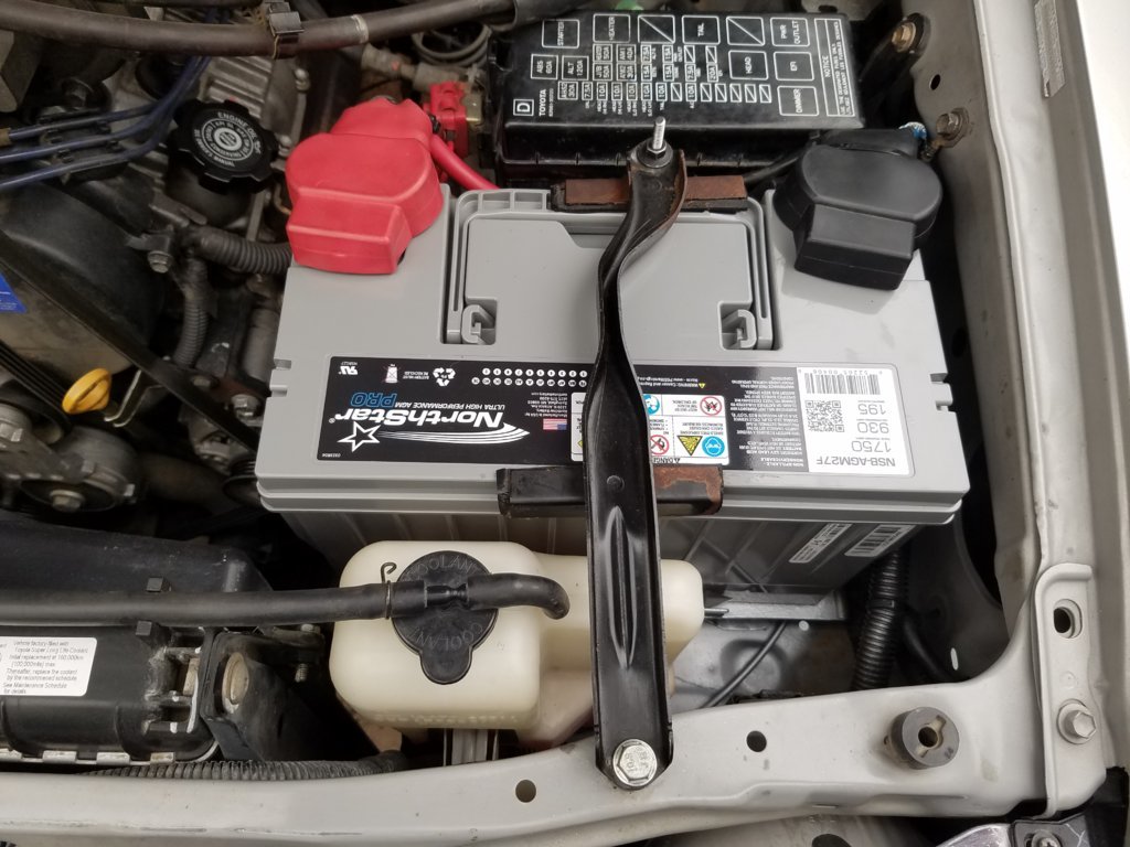

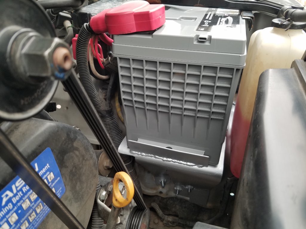

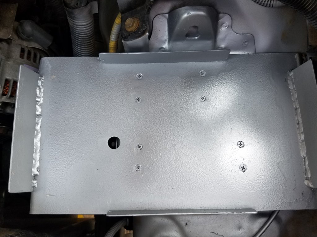

    When I installed a 27F battery, I didn't like how so much of the battery was going to hang over the mounting base. Maybe in time the bottom of the battery or sheet metal would crack.
    I thought this would be a good fix.
    The hole is for locating the air bag sensor bolt.
    The bracket is bent down to strain relief closer to the body mount.
    In the end this mod is not so good. The only plus is more AmpHrs for the winch. The bad is the air bag sensor bolt is hard to get to, the UCA bolt is even harder to remove and I am somewhat locked into double price batteries.
    Here is a test of the Amp Hrs at near 4 years. Jus about where a Group 34 AGM is new.
    Northstar 27F battery at 4 years.pdf

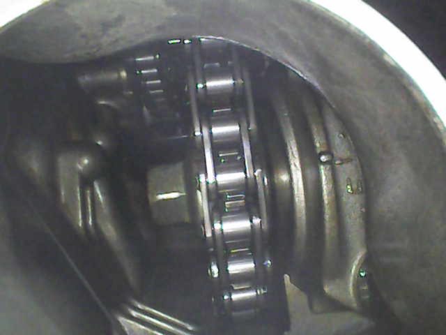

    Trying out a new toy. A fiber optic inspection camera on a long flexible cable that uses my phone to take pictures/video's
    Will find more uses for sure but sent it down the oil filler cap on the truck for a first try. Nice and shiny timing chain after 60,000 miles and regular synthetic changes...
    Correction, that's the secondary camshaft timing chain. The actual timing chain is in the upper left...The slight green tint in the photo is from the light source on the camera head , I am not using green oil :thumbsup:
    Wish oil filler cap was located over the valve train so i could have a look there but it is what it is...
