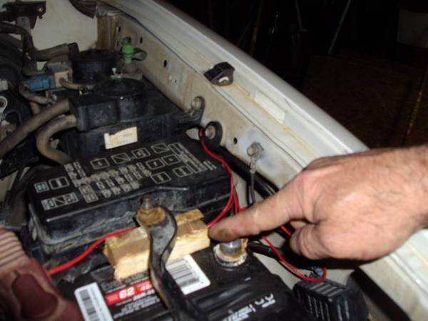

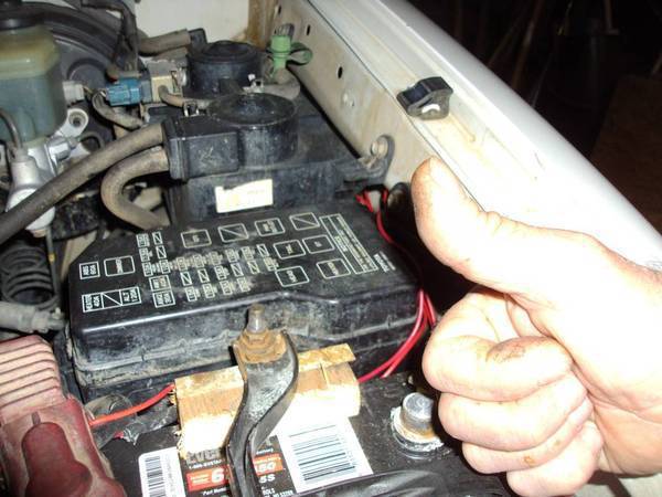

    I had the same issue and fabricated a couple spacers /blocks of wood. I think I just cut a couple pieces from some 1/2 inch ply board and was GTG. A couple spacers should do the trick.

    please post pictars just for the entertainment of it :D

    :facepalm:
    edit:
    oh and f 'dem plastic spacers too... I have an unused one (fits the 34-34/78 YT)
    ...if anyone wants it lemme know
    * the oem battery hold down can be easily modified to work very well
    ...does require some light fab/welding tho' ;)
