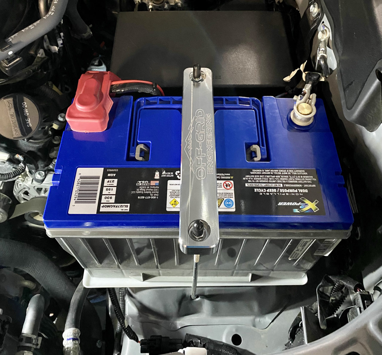

    I am trying out a group 27F AGM battery that I picked up from Batteries Plus (watch for sales and rebates). Dropped it in with a Gen 2 battery tray and an Off-Grid Engineering battery mount. Too soon to tell how life with this battery will be, but it should hold up better than the OEM unit it replaced (especially out on the trail).
    Lots of threads here on the Tacoma charging system and AGM batteries. I hook up my charger every once in a while to play it safe.

    ^That's nice, Burt! Love the "hold down"! Very clean & professionally done. :thumbsup:^
