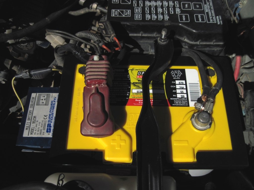

    Here's how I cheated on my extension of the + cable...
    btw... that's a copper buss bar painted black (and after assembly)
    still using the original - neg terminal...
    tho' I have a marine terminal in wait...
    had no real reason to change to that.

    #70777
    4,992
    ^ Thats a pretty nice cheater bus, good idea for stretching out the main.:thumbsup:

    Thanks... it's not terribly bling...
    but does get the job done. ;)
    I even managed to come up with a rubber boot
    protector for the + pos side terminal.
    Covers up the terminal and buss bar for the most part.
    (different then the one shown in the above pic)
    No pictures yet... or I'd have posted that

    had to post pictars of muh booties :p
    OEM boot modified... but old as beans (falling apart)...
    New boot... (black I know)
    tho' I have both black and red...
    chose to modify the black one first...
    to be sure not to booger up the red one.
    Fit so well... I just ignore it's not red ;)
