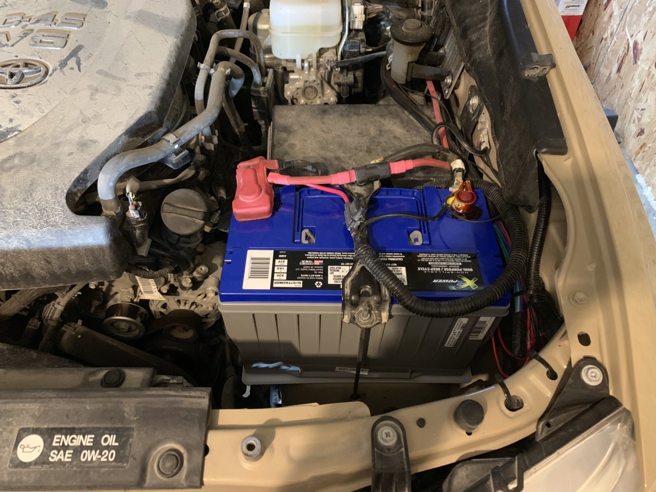

    Mar 30, 2016

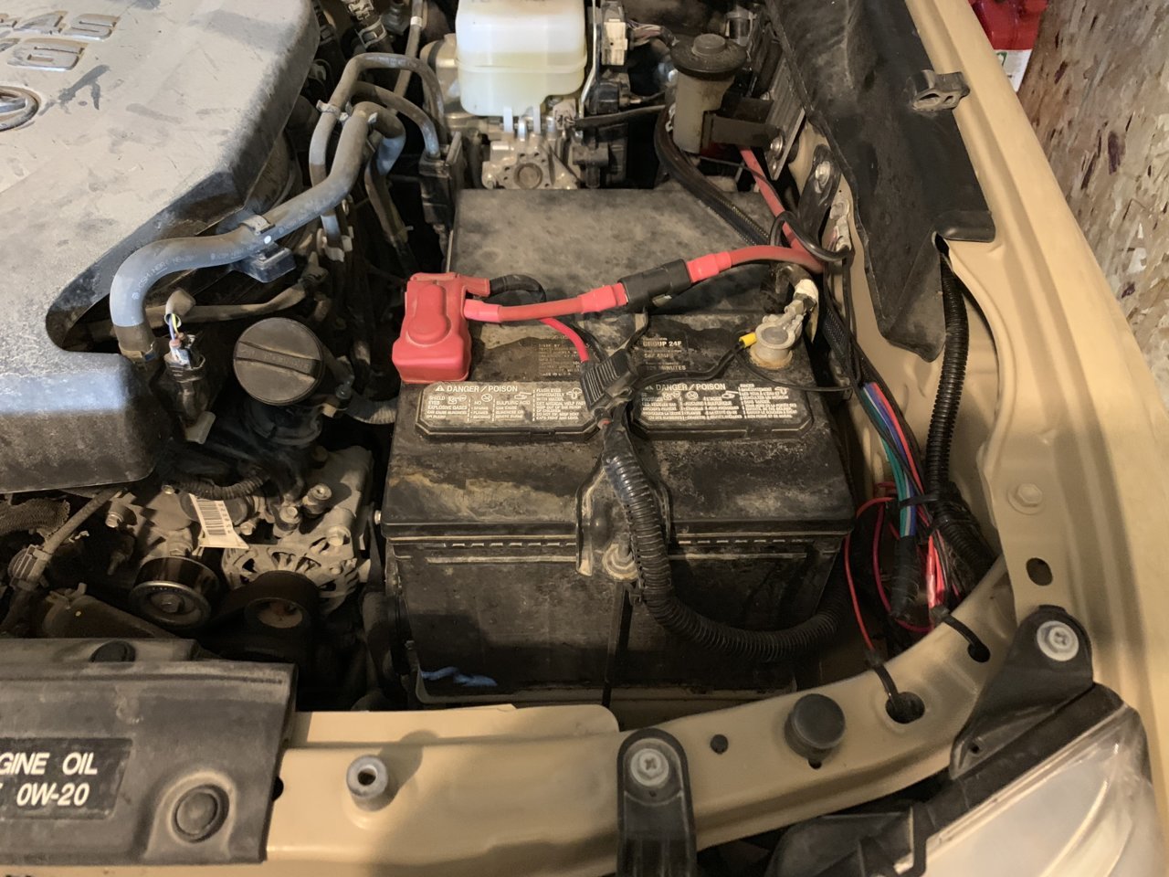

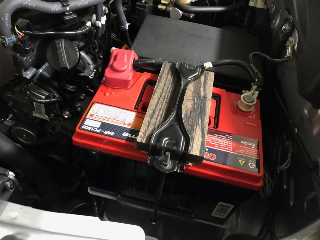

    #182793
    1,034
    Beirut, Lebanon
