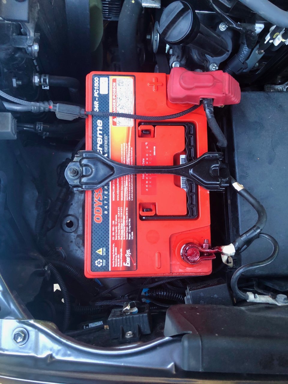

    Not sure where the idea that even with the Odyssey spacer that the 34R comes up short, needing more filler is coming from. The fact is it's a bit taller than the OEM battery... at least in my truck but still fits just fine.

    Appreciate the info and picture.

    Glad to help. I was looking to replace my battery and was pretty set on the Odyssey 34R-PC1500 as my choice. Since I can fabricate pretty much anything I wasn't too concerned if there were little adjustments needed but felt things would fit just fine after looking at dimensions. Sure enough it literally took me 10 minutes to pull, plug & play including cleaning up the battery tray, hold down and coating the negative connection. If somebody were so inclined they could easily run a die do the threaded side of the hold down and forgo the spacer.

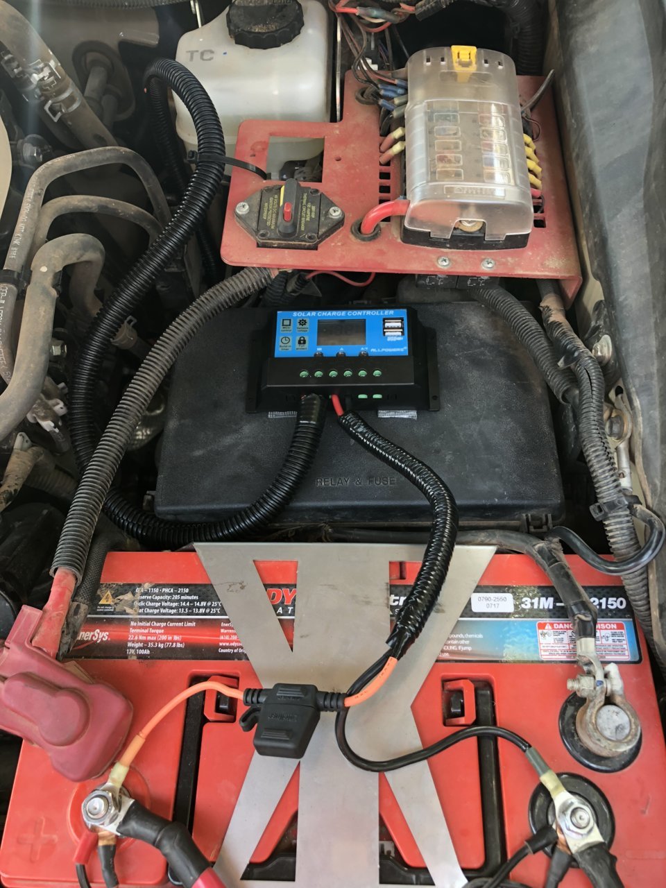

    Toynado
    Toynado Well-Known Member
    Oct 16, 2015
    #166816
    1,393
    SF Bay Area
    2016 TRD OR DCSB Quicksand
    EXTERIOR: Toytec Boss 2.0 Dakar CS047R Leaf Springs Tailpipe chopped Pelfreybilt Front full hoop front bumper w/ Pelfrey fairlead Pelfreybilt Rear standard bumper Pelfreybilt Aluminum IFS, Mid, Rear (exhaust reroute) & Gas tank skids Pelfreybilt Fuseplate w/ 12 circuit fuse block All-Pro Apex Sliders ProComp 7036 17"x9" -6 offset BFG 275/70R/17 KO2's Warn VR10000-S winch Baja Designs S8 light bar & Squadron sports amber pods in front bumper Baja Designs S2 flush pods in rear bumper Baja Designs Squadron Pro amber pods on Caliraised ditch light brackets @rrentrop reflective black tailgate inserts RSI LED's for regular & high beams Prinsu Cabrac Custom Tradesman Truck Top by Access Manufacturing w/ Powertank 8"propane tank mount & Yakima tracks on the roof INTERIOR: Warrior Products door sill protectors Husky Weather Beater floor mats front & rear Coverking arid multicam seat covers in the front Midland 75-822 CB w/ 4' Firestick antenna on C4 Fabrication tailgate mount Consolevault Hondo Garage iPhone mount
    I have a pre bankruptcy Pelfrey
  16. Jan 26, 2019 at 6:56 AM
    #36
    Ducman82
    Ducman82 Well-Known Member
    Apr 8, 2018
    #249837
    300
    jake
    2016 Sand Tacoma TRD
    im looking at replacing my stock battery, and love the idea of a battery with the extra posts...
    Toynado likes this.
  17. Jan 26, 2019 at 7:03 AM
    #37
    Toynado
    Oct 16, 2015
    #166816
    1,393
    SF Bay Area
    The extra posts help. Wish I had an extra extra set o_O
    ..... excuse the dust & dirt
