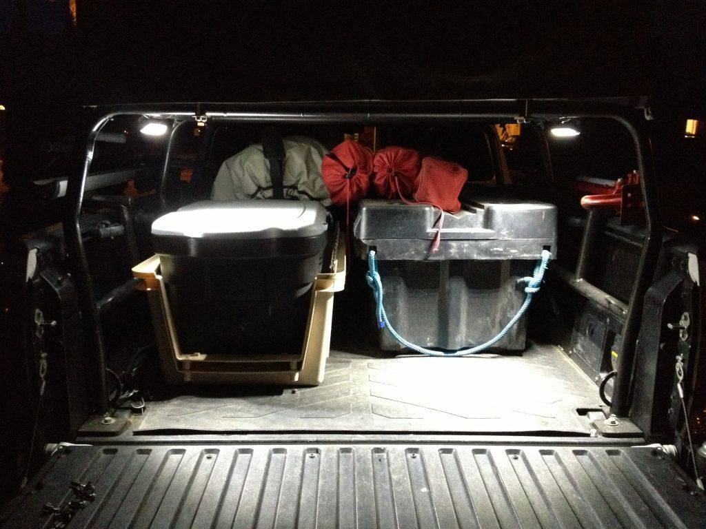

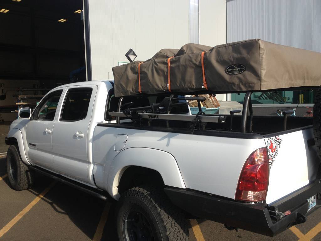

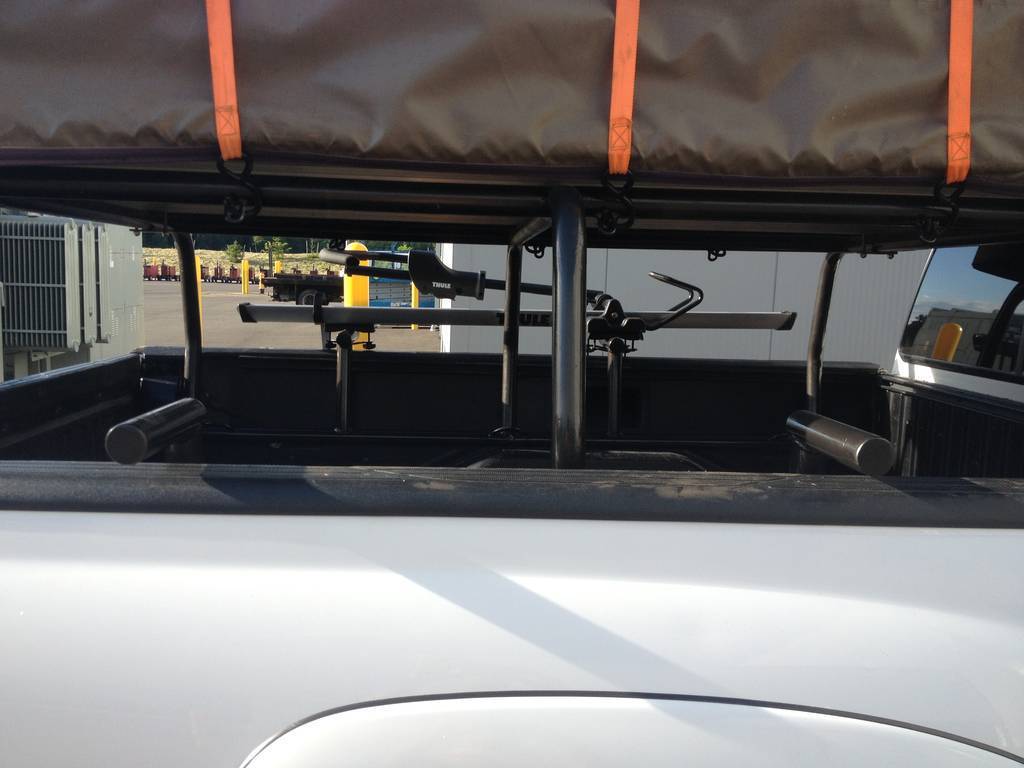

    Here are a few updated pics of the bed rack from this camp season. Added a couple attachment points for mounting my bike rack and hi lift/second bike rack along the bed rails outside of the rack to conserve bed space and provide easy access to the lift with the bed loaded. Also added a few spots to hook the tent compression straps to to make things a little easier to pack up.
    And some cargo/camp lighting

    Thanks man, uploaded a few update pics. Haven't really wanted to change anything about the build yet other than the few additions I made this season. I imagine there will be more things in the future that get added but as for the design and dimensions as a whole I have been very happy with it for the past 3 summers now.

    Damn, didn't realize this went straight into the bed bolts, that's awesome. I like the tie-down rings too.

    Yeah figured that was the easiest and strongest way I could figure to mount it. No new holes in the bed and directly loads the frame rails instead of the bedsides or any other plastic. Dont have to worry about it even bouncin around off the highway :D

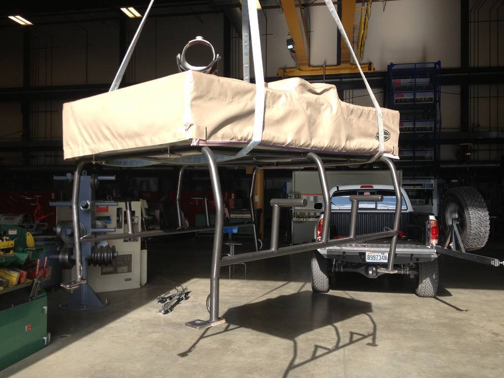

    Where'd you source the tube?
    Great design and fab work!
    Definitely going to bulild something similar.. Like how it doesn't rely on the bedsides to support the weight of the loaded rack.

    Awesome work! Quick question, any particular reason you didn't make it the same height as the cab?

    My extra height was intentional so the lines would match once I get a cab rack system put together.

    Thanks, got the tube from Morse Steel in B'Ham. Carlson Steel is a bit cheaper usually, I'd check them out. I used Morse because they deliver to my work for free and thats where I did the fab so it is convenient and worth the little extra. Its tough to haul 20' sticks of material.
    I just wanted to try to reduce the drag a slight bit by tucking at least some of the tent behind the cab. We travel a lot of miles on the highway typically on our road trips so i figured any little bit would. Not sure it makes a noticeable difference in mpgs. I also like the overall look better personally.
