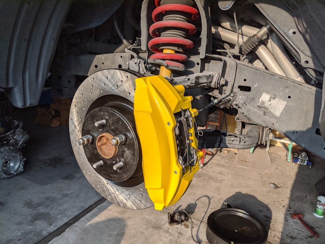

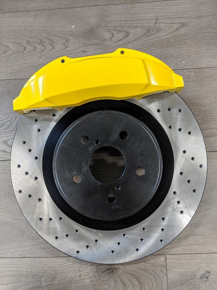

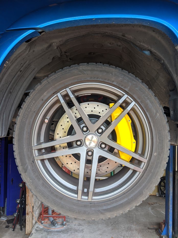

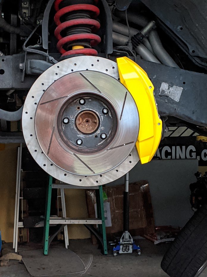

    Now that I've driven a bit on them, and the pads are bedded in, I can confidently say this kit is finished and ready for others!
    Uses any RWD non-sport package Lexus LS460, LS600h, or LS500 (yes even 2020+) 4 piston calipers (K17 casting), and the Lexus IS-F rotors.
    Parts are all inexpensive and readily available. I rebuilt mine after powdercoating for good measure.
    18s are needed, though sadly RPF1s do not fit. Factory X-Runner wheels also fit.
    Fits any 2nd gen 5 lug setup. Working on a 6 lug solution in the future as well. Will likely be able to use 17" wheels with the 6 lug version. Who do I need to talk to about becoming a vendor here?
