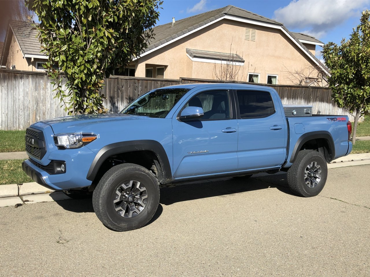

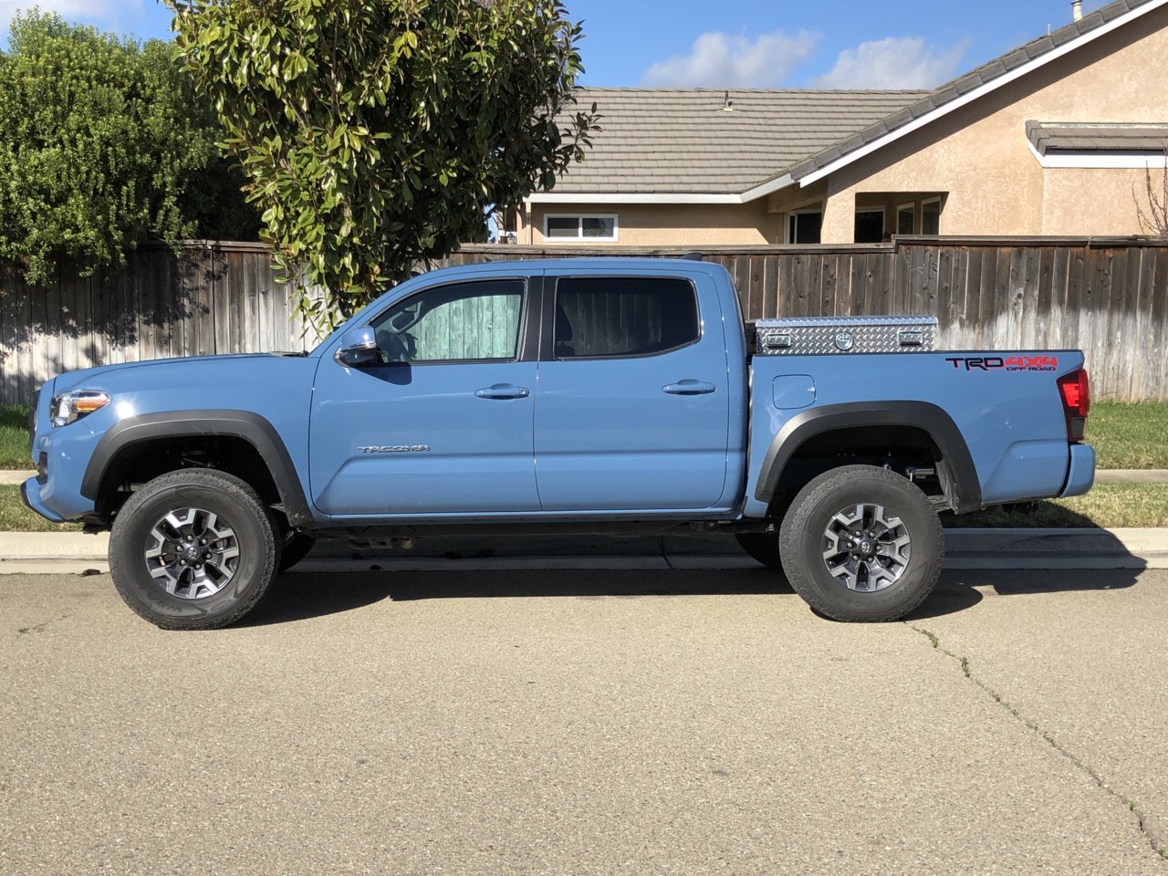

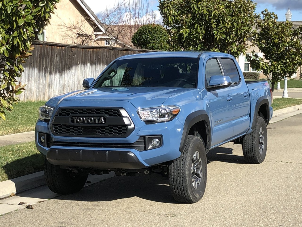

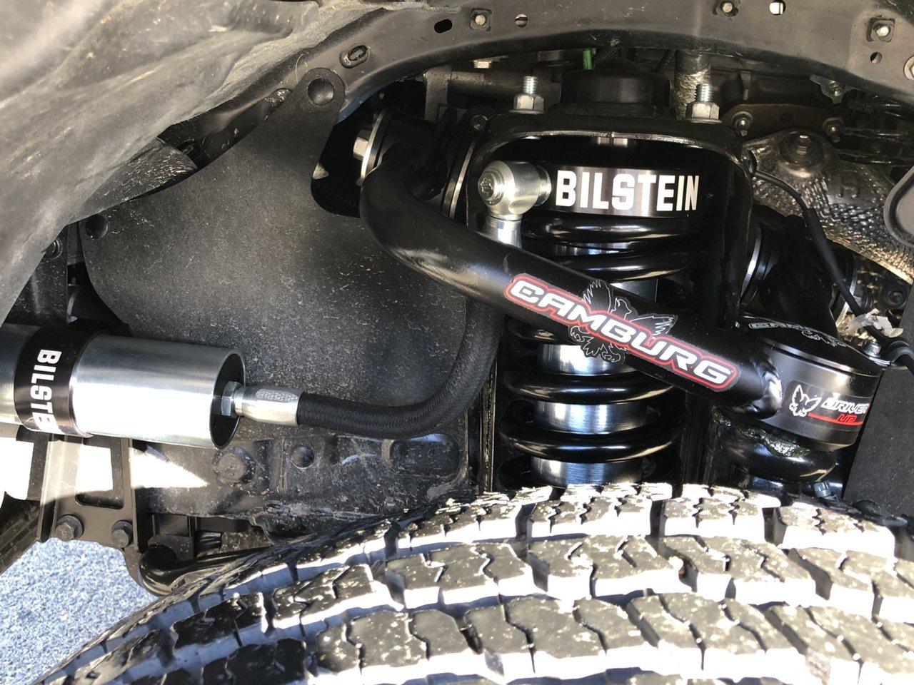

    6880ACD2-1570-472D-A0CA-FC9A23333A7B.jpg C02BB388-55D6-455F-98A0-48FC94028396.jpg 3848BE08-A868-4270-B09F-109210B0896B.jpg E9C4FFAD-7D17-4FEA-A834-3379CF7B8201.jpg First, I want to thank everyone on here for sharing information. I read, read, read and read some more. I used tips, tricks, install guides, notes, recommendations and a wealth of other information provided by the users here. THANK YOU ALL!
    I installed my new suspension by myself over the last two days: Camburg UCAs, 8112s, Wheeler’s AAL and 5160s. No carried bearing drop or 3 degree shims. I got about 1 1/2” in the front and 1 3/4” in the rear. I wanted to adjust the coils for more lift and tried two different kinds of spring compressors but neither worked. The problem was that the claws were too big to grasp the coil without hitting the shock body. Due to the size of the shock body, to compress these springs properly you really need an industrial three prong spring compressor. I went to multiple shops and they couldn’t do it either without fear of screwing up the shock. Finally, the last guy convinced me to try the setup as designed by Bilstein and see how it rides at an 1 1/2”.
    I’m tired... it was a lot of work on the ground for my 52 year old paratrooper beaten knees —mostly because I was figuring out and thinking about what I was doing and how I was going to do it as I went along. Second sides went a lot faster. Tomorrow it goes in for an alignment. I test drove it and so far, so good. I can see that the camber is off and it pulls ever so slightly to the right. But I have not noticed any vibrations at any speed. I do hear a what sounds like a loud tire which I assume is part of the alignment being off. The ride is AMAZING. It’s more firm, planted, stable and handles better. You do feel the road a bit more, but in a good way. Finally, these shocks really shine at speed. There are a set of railroad tracks on a lonely country road near my house that has a deep dip, a steep climb, a deep set of ruts with metal tracks in them and a steep drop with deep pot holes on the down side. If I hit this crossing at 55 in my TJ, you’d a thought the suspension was being ripped apart and the wheels were come off. Anything over 60 sent it into severe death wobble. No bueno. I hit those same tracks with my Tacoma at 60, 70, and then 80 and it went over it without spilling my coffee (in a ole’ skool cafe mug...no lid). Simply amazing.

    Thank you for the review! It's always so hard to compare suspensions by "the seat of someone elses' pants." But yours really helped. :)
    Lol I can empathize about the knees, once I turned 40, all the hard landings and equipment I lugged about seemed to come back to remind me I'm not a young man any more.
    I can't wait to get the 81XX's on my truck.
    I assume the 1 1/2" was at the factory setting for the shock?
    I thought with only 1 1/2" lift UCA's were not needed?

    Got the alignment done by a local shop that has 40 years of experience and does custom work. They had the spring compressor I needed, but I guess the tech I talked to was feeling lazy on Saturday. Anyway, the numbers I got are:
    LF RF
    Camber .5 .4
    Caster 2.8 2.8
    Toe .02 .02
    I think those are good although Caster is out of factory spec, but just barely. I think factory spec is 3? Since I only went up an 1 1/4”, I would have thought that the Camburg UCAs would have given me a full 3 degrees of caster. I can’t believe how sensitive the Tacoma suspension/drivetrain is to changes in height/lift.
    Edit: I just looked at my before caster numbers and it was positive 4.1 on both sides! The tech dialed the caster BACK to try and get to factory specs which is very low caster... while 2.8 is fine per Camburg, I think I’m going to try a different shop next time.
    The vehicle now drives true and straight. Steering feels like stock. Still no vibrations. Ride is fantastic and well worth it.

    Additionally, I called Bilstein Technical Info and was told that 8112s CAN be adjusted while on the vehicle and under compression. Per Bilstein, remove the wheel from the vehicle let the suspension fully droop, and make the adjustment.
