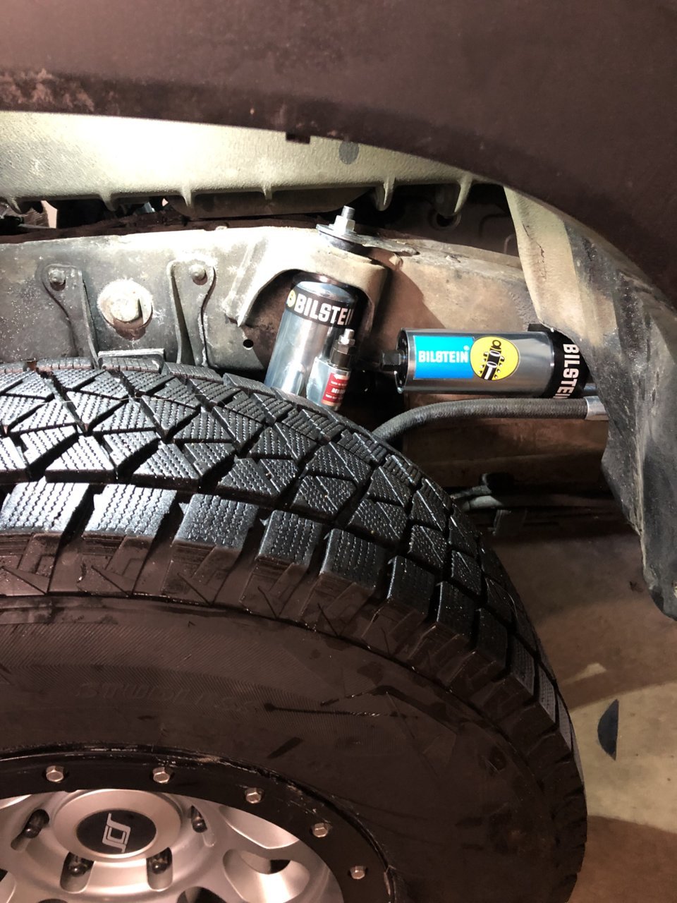

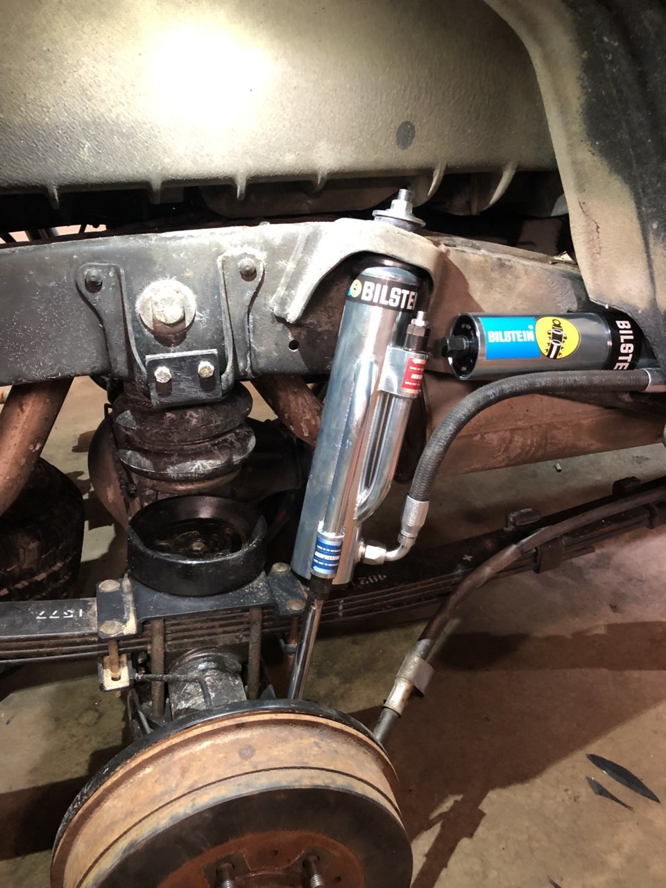

    @yotafiend
    From your pics I see the elongated hole on the spring seat is incorrect. Per the directions it should be facing inward. Page 5

  12. Mar 4, 2019 at 8:32 PM
    #392
    Arrieta578
    Arrieta578 Well-Known Member
    Nov 28, 2018
    #274098
    391
    2019 Tacoma DCSB OR Calvary Blue
    Absolutely correct.
  13. Mar 5, 2019 at 4:11 AM
    #393
    yotafiend
    yotafiend Sup Dawg!
    Oct 20, 2018
    #270002
    167
    Detroit, MI
    2024 SR5 DCSB 4x4 Underground
    TRD OR Wheels Falken Wildpeak 33s C TRD OR Struts Trailhunter Skid Toyota Mudguards Toyota Integrated Dashcam Toyota Rocker Bars CH Ceramic Paint Coating Costco 91 Octane
    Trying to think if this really matters or is it pure cosmetic.
  14. Mar 5, 2019 at 5:59 AM
    #394
    Imphedup
    Imphedup Trout Addict Whitetail Killer
    Sep 8, 2015
    #163750
    589
    CHAD
    LOWELL,MI
    2017 DCLB OR
    Have no idea? It was just fresh in my mind from my install Friday night.

  15. Mar 5, 2019 at 7:29 AM
    #395
    Arrieta578
    Nov 28, 2018
    #274098
    391
    Was thinking what would the purpose of that elongated hole be? Then it dawned on me... if you were to adjust those coilovers under load, there is a possibility that you could extrude the the aluminum threads. However, that elongated hole could allow you to lube the threads while adjusting and later degrease them, thereby preventing damage to them as they turn.
