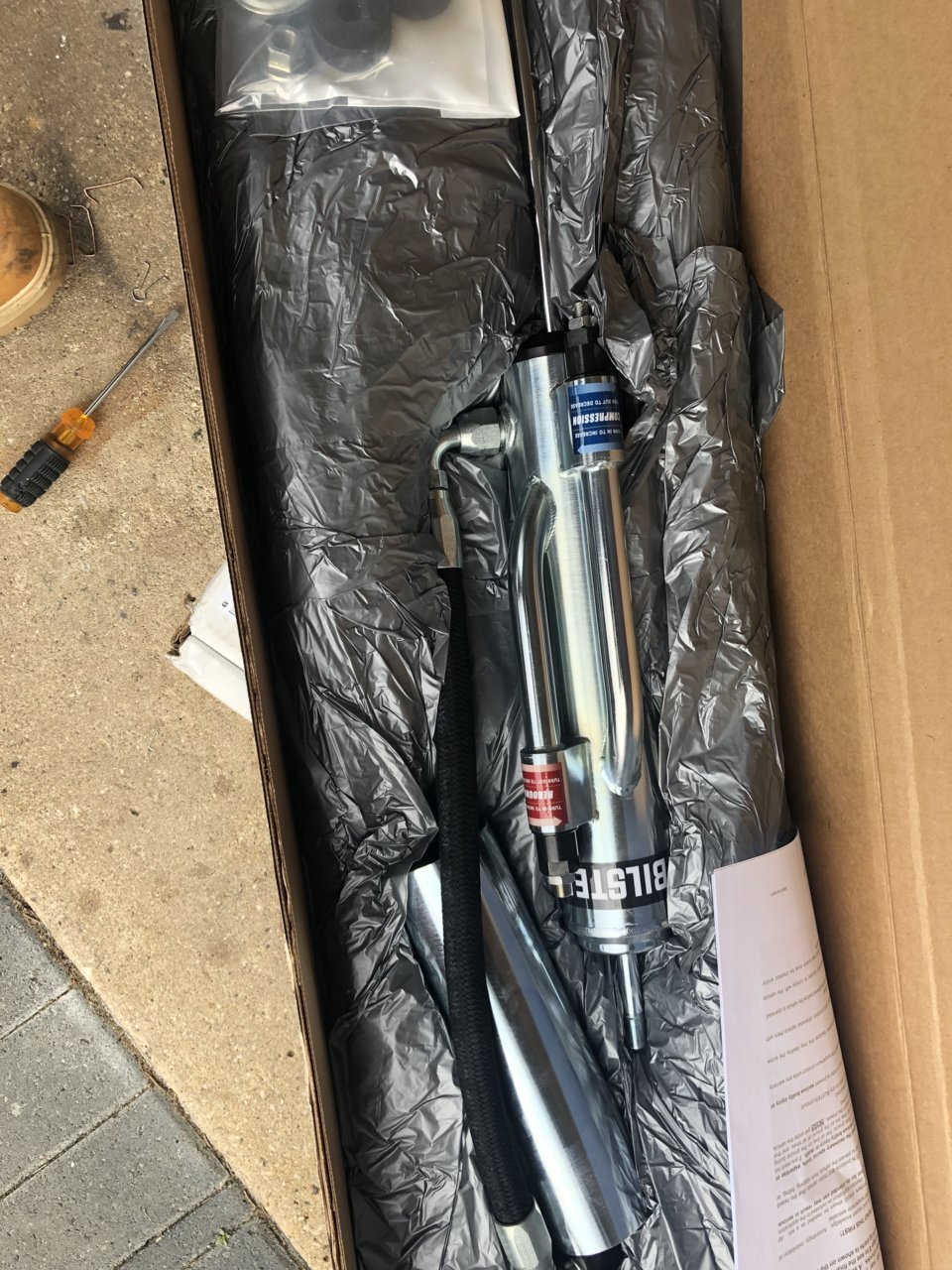

    Got the rears delivered today Now just need to install everything ED334BA4-1888-4AD4-8E1A-E4B1F5B39353.jpg 9587126A-777E-47BA-B333-45D51926995B.jpg

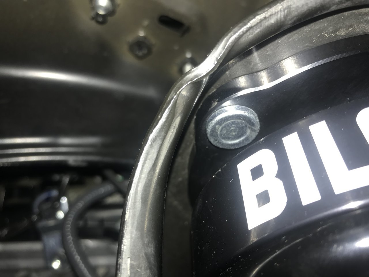

    Install ??'s - Has anyone seen the front 3 upper mounting bolts start to pucker? ... As per the Bilstein instructions, bolts should be torqued to factory recommended 47ft-lbs.
    Before getting to that torque, I noticed the bolt shaft start to pull up on the flanged part that rests against the shock...

    Please post the picture of your situation.

    See the inner portion of the bolt is pulling inward.

    What did the Bilstein distributor say? Have you emailed Bilstein directly?

    I'm hoping those pieces are "serviceable" press fit and if there is a defect it can be removed and replaced somewhat easily.
