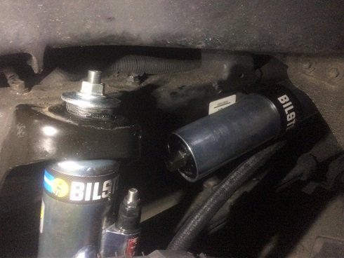

    Back shocks and shims are in, last piece of the puzzle (I hope) is the rear leafs which should be in next week...
    With the external bypasses and those huge reservoirs these things look sick!

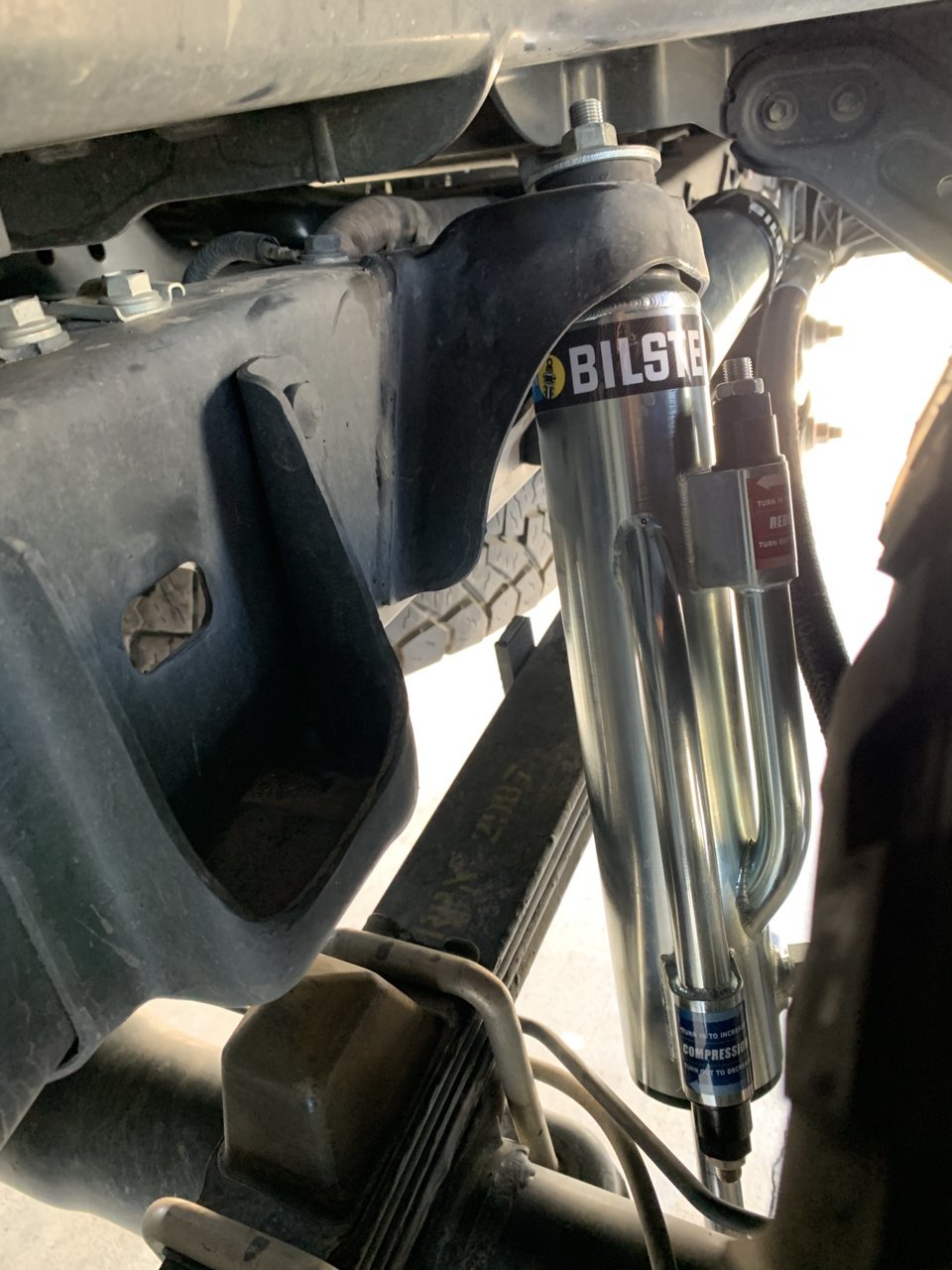

    My Icon leaf pack hasn't arrived yet....
    and I'm not installing the 8112's 'till this Thurs....
    But I could not wait and installed the rear 8110's with just the stock leafs....
    Holy Shit what a difference!
    Even just on potholed roads the ride is sooooo much better, accelerating on a baffed out corner, or on a area where there were potholes after potholes... with old shocks rear tires were jumping and jouncing all over the place, now it like it's a normally smooth road.
    I know I say roads for these comparisons so far but to put it in perspective... those lowered fart can muffler civics with 1" sidewall do not drive these "roads" twice.
    I did not think, there would have been this huge a difference with the stock leaf pack still in it!
    I had taken a Pro on a test drive a few months ago though the same area...
    NOT EVEN CLOSE. Rear end was not as controlled or smooth as what I experienced today.
    And I have not fiddled with the adjustments yet, that was how they came outa the box.
    Not doing the "rail-road" crossing test while I have the Warn semi hidden bumper on, with the stock shocks, lol don't want to pop them or bottom out hard.
    Of course we have a pic or two..
    Old and "Busted" vs.the New hotness...
    I didn't even bother taking the rear tires off when I did the install,
    lol that would have tripled the work, of this easy install,
    and it was starting to rain so I had to take a quick pic.
    Oh I can't wait for the fronts to go on now!

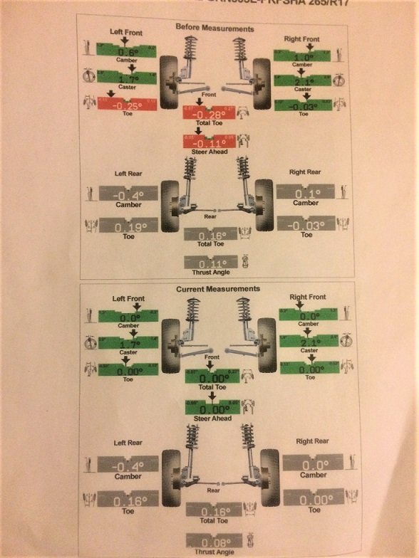

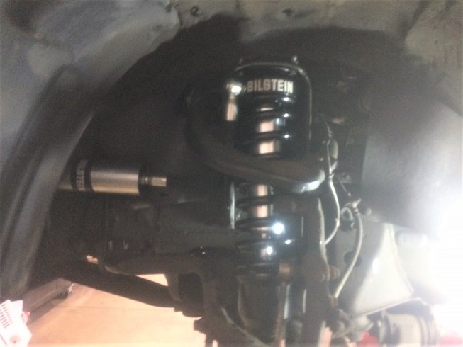

    Fronts are on...
    Rear leafs will go in after I take some measurements on them..
    Yeah, Amazing is a good word.
    Balance, control, smoothness....
    Puts this vehicle in a completely different snack bracket....
    Need to take better pics,
    measurements ...but I was having too much fun.
    But the install went smooth.
    Toyota Techs did a great job...
    Even the Alignment, they hit the #'s I requested, dead on...
    More "testing" this weekend.
    But for off-road it's going to be no contest, not even fair, comparing to the Sport shocks...

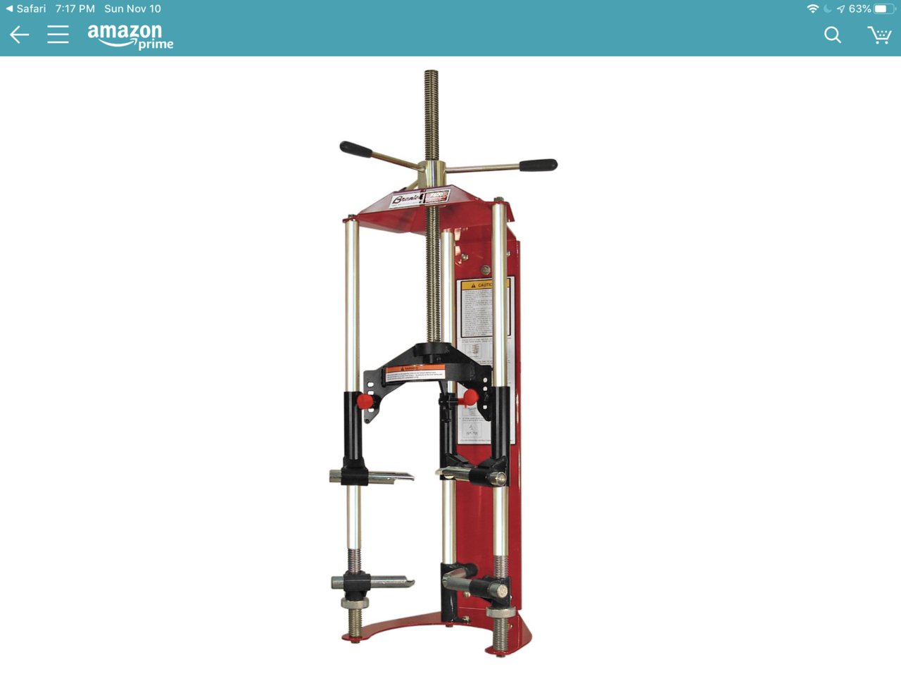

    In my experience, a rented spring compressor or home unit isn’t going to do it. The problem is the coils are too big and the spring is too tightly compressed for a DIY spring compressor.
    You need a unit like this:
    Using the process I described, you should be able to adjust or compensate for your unintended lean no problem
