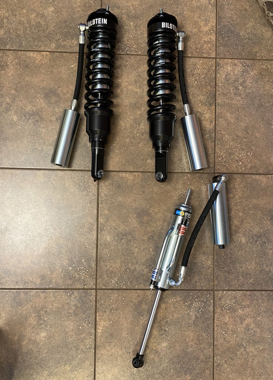

    Fronts just came in today. The pictures really don't do them justice to just how freaking big they are. Waiting on rears and leaf kit now.

    Tocamo, 71tattooguy, SpensirG and 3 others like this.

    Beef!
