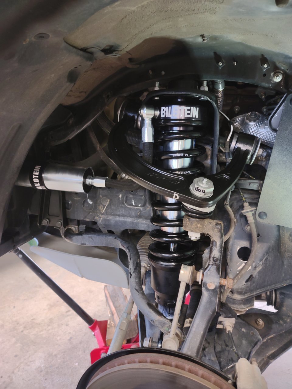

    I have a question for y'all 8100'ers:
    I have the chance to set ride height on a friends' wall-mounted spring compressor, I have Mobtown recovery hitch, TRD skid, Rago LCA skids, and Mobtown sliders. I would like to still have some OEM rake with the Deaver Stage 2 rears.
    What should I set the front coils at? I know that out of the box is .6" lift.
    Thanks!

    max them out to the full 2”, and if you’re a third gen, bump to the 650# coils as well. I left mine at stock (1.5” with 600# coils), and I have a bit too much rake imo.
    edit: should mention, I’m on the deaver u402 stage 2s.

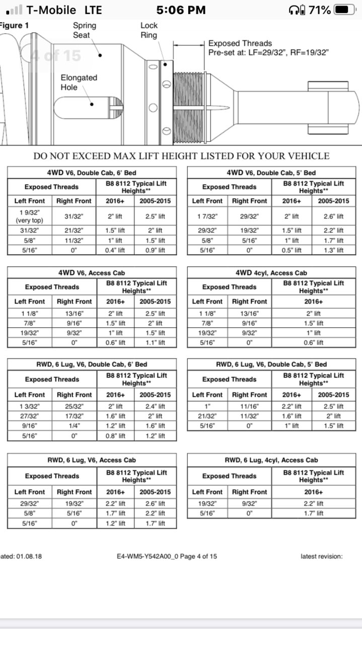

    My set was 2.2” out the box. I needed them set 2.6” so I wouldn’t rub. I had 2.75 on my old set up so I lost some lift. Since I’m maxed out for my truck at 2.6” and I’m riding on 285/70/17s I rub my fenders and have fully stuffed my tires into my wheel well. I need external bump stops to keep from hitting the inside of the wheel well. Oh and this weekend I discovered I stuff my rear tires into my fender so I got to trim some.
    2.2” gave me some rake that was noticeable by everyone since I used to sit level.
    https://www.bilsteinlifts.com/wp-co...nstallation-instructions-E4-WM5-Y542A00_0.pdf

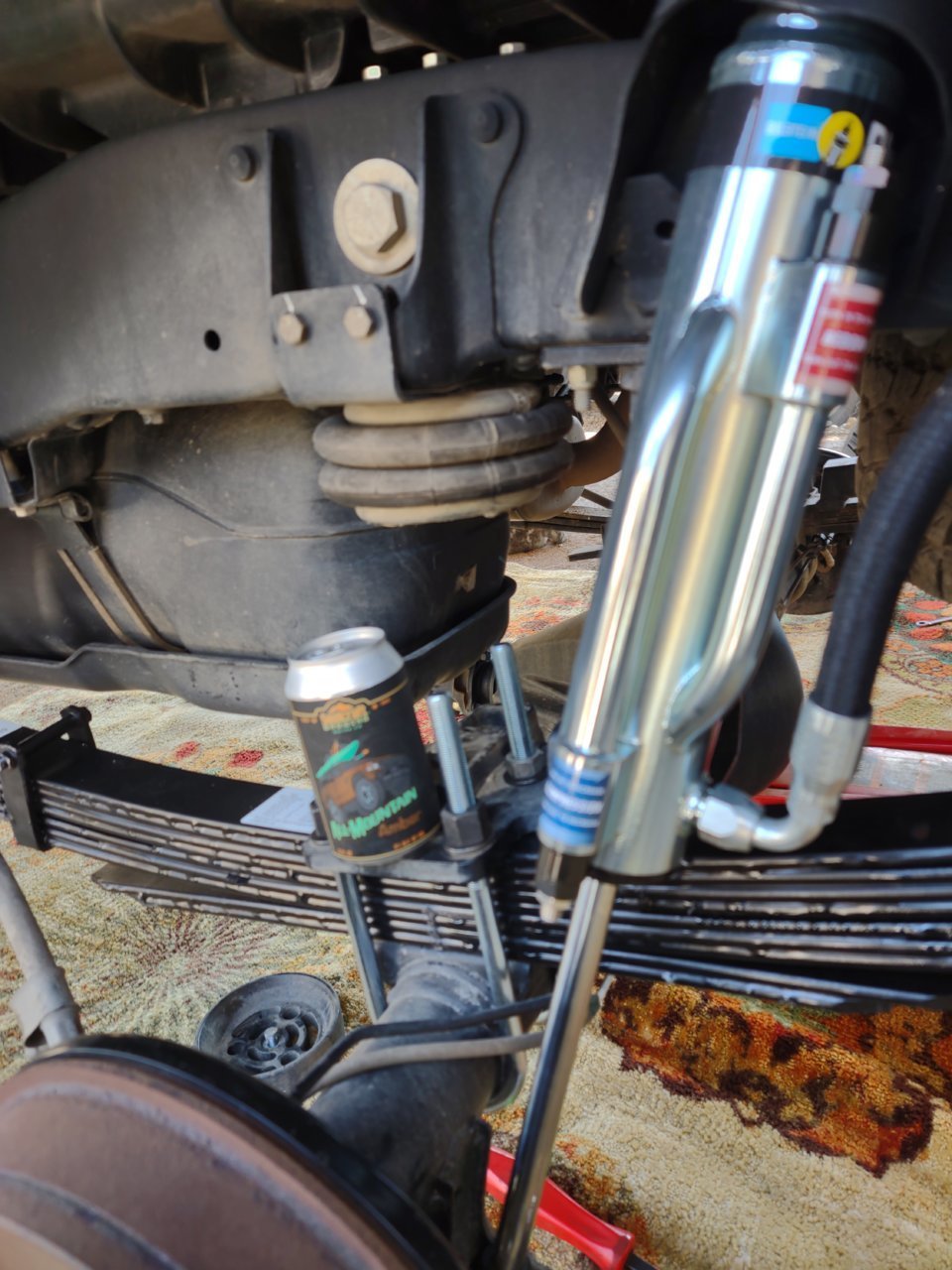

    Bilstein 8112+650lb coils, 8100+Deaver Stage II leaf pack, SPC UCA, DuroBumps, Mobtown 0* sliders W/fill plates, Mobtown Recovery Bar, Radium PVC & CCV Dual Oil Separator Catch Can System, Snugtop Hiliner Sport, ATH bed Stiffeners (cuz bottle openers!) + front corner tie down, Badger plates for Firestone airbag + Relentless U-bolt flip + Daystar cradles, TRD Pro shift knob, TRD Exhaust, HPS Silicone intake tube, Green Filter, TRD Intake Air Accelerator, 265-70-17 Toyo Open Country ATIII on TRD 17" Rockwarrior Cold Forged wheels, TRD alloy front skid, RCI Aluminum transmission & transfer case skids. Much Meso awesomeness, FreshMexicanTaco TacoGarage Camera Controller + DDM, 67 Designs cradles, Banks Pedal Monster + iDash gauge, WarFab Sheridan hitch skid, Ricochet LCA aluminum skids, Rago lower rear shock guards, FN Koning Countersteer 16" spare, OEM T4R 90105-14104 coilover lower mounting eye bolts
    I installed the 650s with 32mm threads showing on driver side and 24mm on passenger side.
    I don't work in fractions.
    Dirk Diggler and TXpro4X4 like this.
    Full squish!
    8AD721E7-2034-4FC1-99AD-3DE804C8F33B.jpg 415216FE-992B-4B6B-8F10-FA22E88CB234.jpg
    I did not get a rear shot with the U-bolts trimmed and the Daystar cradles installed o_O
    Hot damn are these plush!
    Big thanks to @runnin4tacos :thumbsup::thumbsup:
    The ride quality is superb! Driving on dirt roads, double track, technical double track I have no more head shake, front end diving, rear end bottoming out which was the characteristics of the stock suspension with the extra weight of the sliders, skids, shell, etc. Street manners are calmer.
    For the damping adjustment of the rears, I will increase, “clockwise”, rebound and may decrease, counter clockwise”, compression.
    The fronts Do audibly click/clack under movement, which Bilstein states with the installation paperwork.

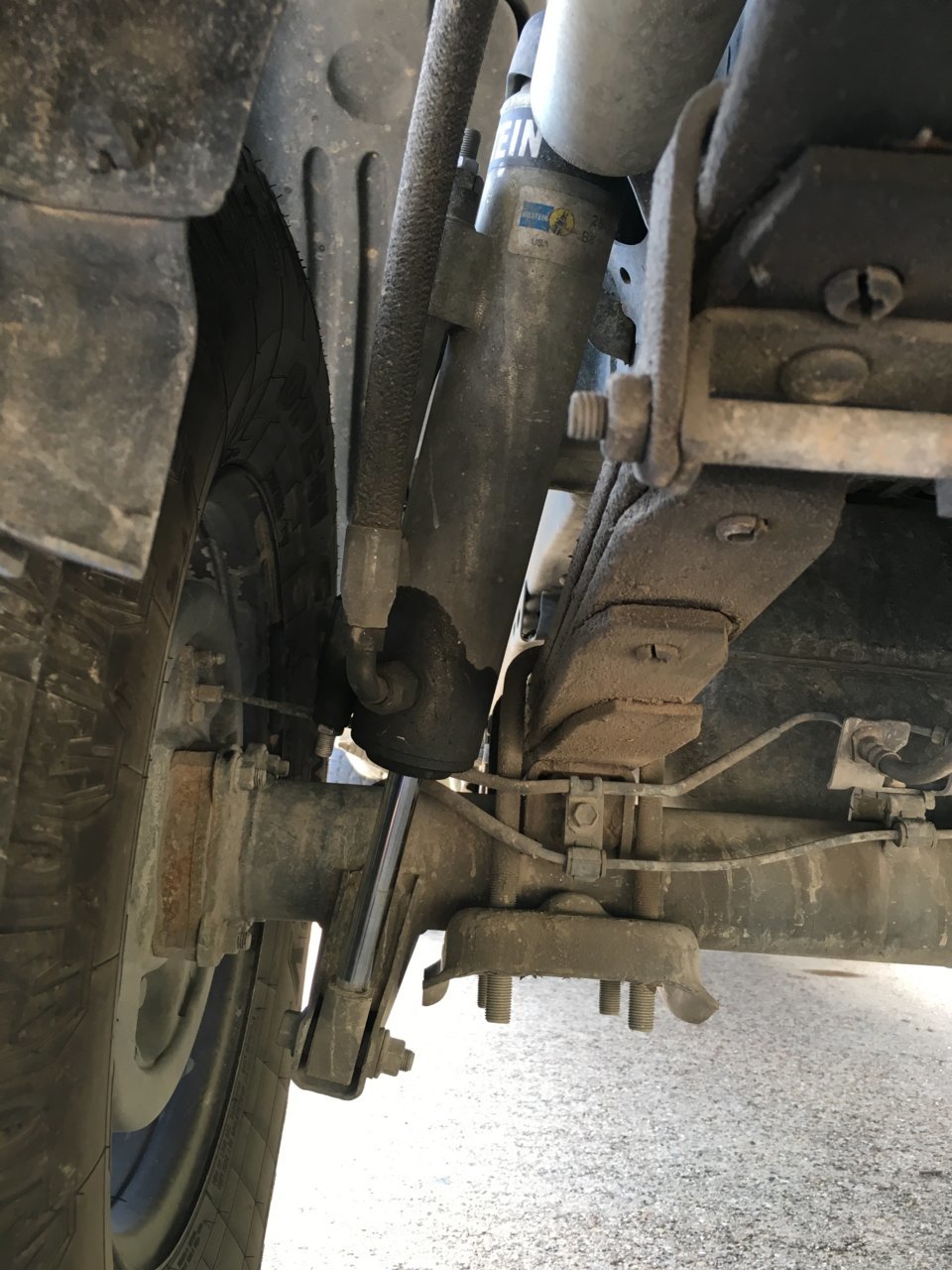

    D83A124F-9D11-448A-A598-93F30D2B3B19.jpgOk. I think I broke it smh. Its was totally my fault. I’m running 8112’s and 8100’s with Icon RXT stage 1 leaf springs. I had 51,260 miles on that setup when the damaged occurred. I’m new here, not sure if the photo of the blown left 8100 will be clear. I also broke the bottom leaf and will post that picture as well if this one comes out clear.

    50k is time for a rebuild.
