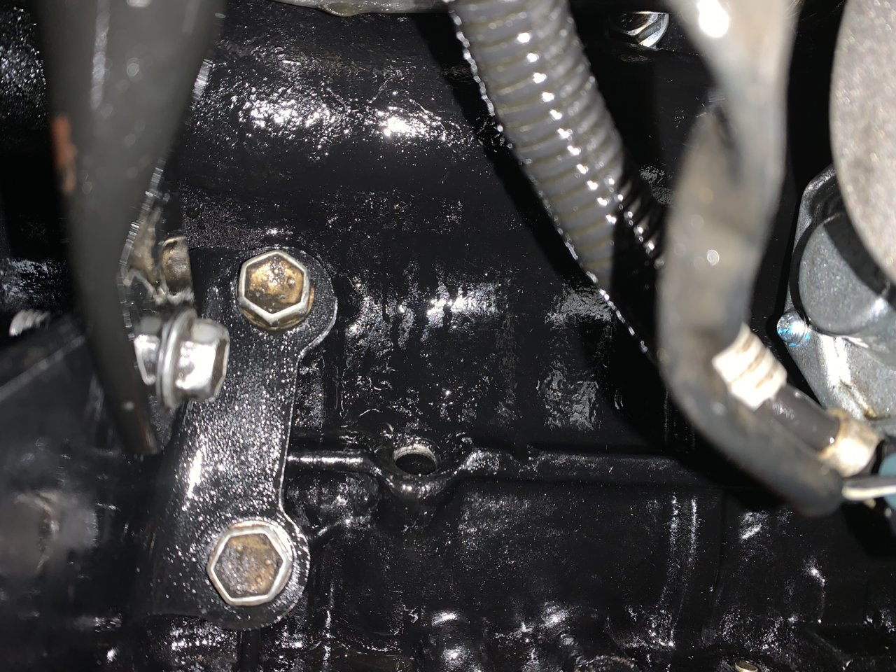

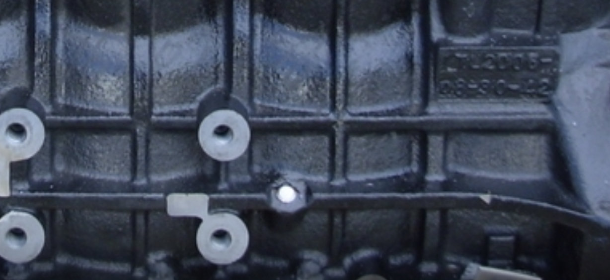

New block. But leaking oil from this hole. What gives?
Discussion in '1st Gen. Tacomas (1995-2004)' started by Mtb_mafioso, Dec 6, 2021.
  1. Dec 6, 2021 at 9:48 PM
    Mtb_mafioso
    Mtb_mafioso [OP] Well-Known Member
    Jul 2, 2019
    #298146
    48
    Got a new block and it was missing several things. Managed to outsource and find most of em. Except this one. Just turned it on for the first time and I’m leaking/ spraying oil from here. When I turn it on it sprays out of the Hole. From the looks of it, there seem to be threads and it’s about 1” away from the engine mounts. but don’t know what it’s called and how deep the bolt would be.

  2. Dec 6, 2021 at 9:49 PM
    Bishop84
    Bishop84 Well-Known Member
    Dec 17, 2015
    #172494
    11,676
    Oil pressure switch?

    Maybe knock sensor. Check engine light on? Any unplugged wires?

    @Superdave1.0 no all of these listed on the diagram are solid. No leaks or nada. But I had the same issue with the coolant drain plug on the passenger side of the block. A small bolt was missing on the block itself so I had to go to the junkyard and luckily found it. I don’t know how lucky I’ll be or if that engine block is still even there

    You don't have your old engine block for reference? Are you leaking oil or coolant?

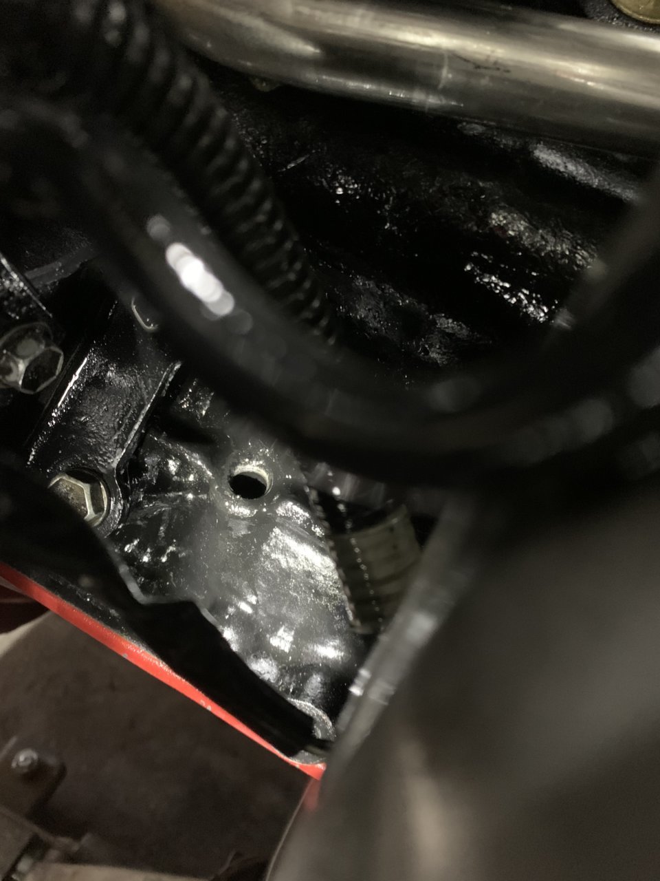

  11. Dec 6, 2021 at 10:35 PM
    Mtb_mafioso
    Jul 2, 2019
    #298146
    48

  13. Dec 6, 2021 at 10:54 PM
    O'Silver_Taco
    O'Silver_Taco Well-Known Member
    Aug 26, 2021
    #375390
    3,990
    MD
    98 Dlx Sr5 ext AT Rwd
    3rz to 2Rz bebuilt block and new heads
    Toyota has been making 3rz blocks since 1959...
    .....there's no tellin how many appendages this supported over the decades..
    as far as I can tell that port is not used on tacomas 95.5+....

    No real clue but a hole for a dipstick? Especially for a different application?

    @O’silver_taco yeah man this block was missing so many Lil bolts here and there. When I checked the video from when I removed the block I couldn’t see anything there. So maybe this is from a 95

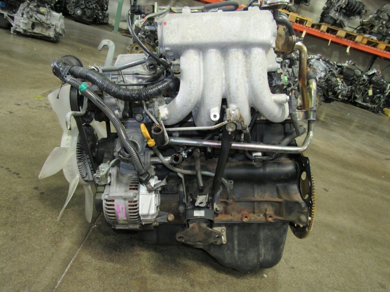

  17. Dec 6, 2021 at 11:22 PM
    #17
    O'Silver_Taco
    Aug 26, 2021
    #375390
    3,990
    MD
    I think thats it......I've seen a JDM engine swap with the dipstick on that side....
    instead of in front timing case.....it was very odd looking compared to what we/re use to...
    the taco owner complained how it didnt give an accurate reading......
    I'll see if I can find that thread here from about 2 mo ago....

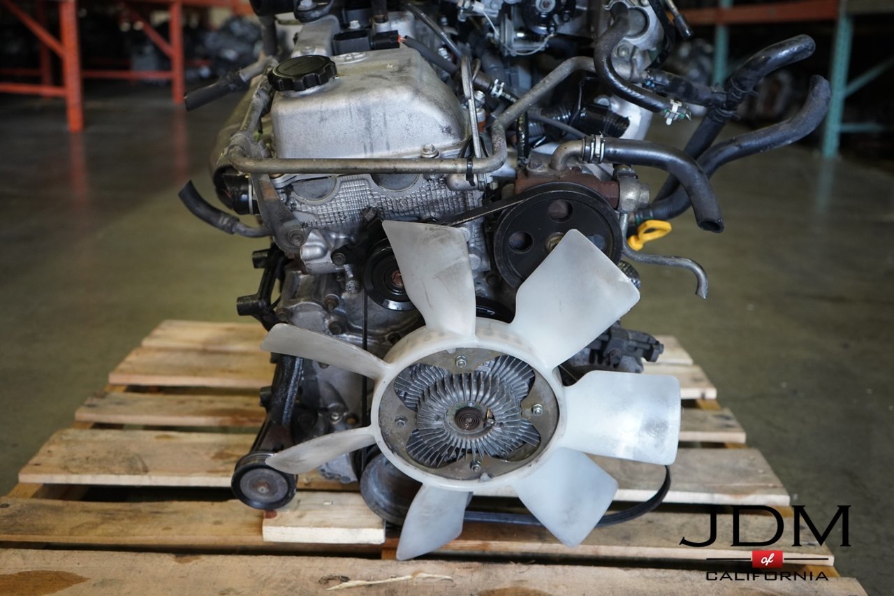

  18. Dec 6, 2021 at 11:36 PM
    #18
    O'Silver_Taco
    Aug 26, 2021
    #375390
    3,990
    MD
    So...you got a reman JDM block.....
    most likely from the millions of Hilux's sold overseas......
    the asians pull these out and put in the 2.5 diesel thats more popular than the gas ones.....
    outside of US regulations......and americans wont buy the zero pep diesels here...
    You should be able to get a plug ... its not under pressure....and its not below oil line....normally just a tube there with o-ring on the JDM's....
    I'd do a temp fix.....and then figure something better......
    maybe start a new thread asking for suggestions ....now you know what animal your chasing....
    If it was me carefully de-oil....JB weld a tight bolt.....

  19. Dec 7, 2021 at 7:01 AM
    #19
    se7enine
    se7enine MCMLXXIX
    Apr 18, 2013
    #102322
    23,443
    Reno, NV
    There are two dipstick holes on the 3RZ blocks. The t-100 has the dip stick in the front and the tacoma has the hole you have on the driver side. It's just a taper plug that you put in there. I used a rubber hose and a bolt to fill mine.

    so many remanufactured blocks come missing all sorts of plugs you need to look at things a little closer.
    What else is missing??
