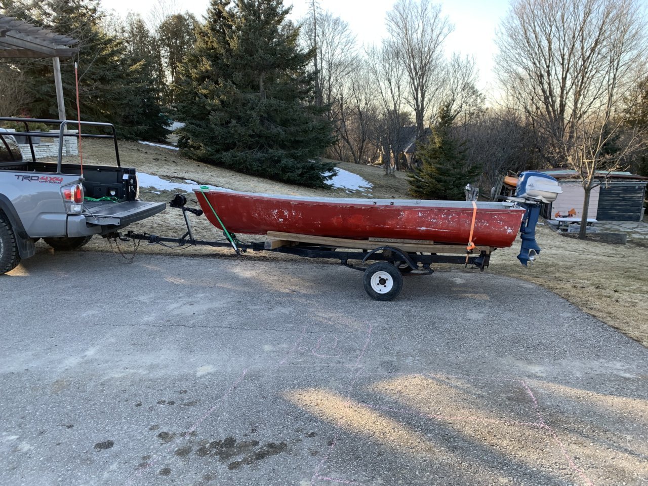

    Good evening folks! I just picked up a new to me fibreglass fishing boat. Boating is new to me so I’m unsure of the correct terminology. But I noticed this afternoon that the square wood panel, behind the checkers plate, where my motor mounts to is rotten. The bolts all look seized too. Can I cut the these bolts and easily pull the wood apart and replace everything or is it more complicated than that? I can get a better picture tomorrow in the day light. This is the only one I have so far. 12ft fibreglass with 7.5 hp evinrude.

    Its a big job but yes, you certainly can!

    its not that big of a job as it is a PITA, and fyi that area of a boat is the transom......

    On a glass boat that is a pretty big job. I just did one last year.

    It’s called a Transom. Take some pics of it and we can help you more.
    Depending on the type of hull the transom is really hard to replace, it’s fiberglassed into the hull. For a boat that small you might be able to just swap the plywood.

    I can tell you one thing replacing a transom on an aluminum boat is easy. Its a real pita for a fiberglass boat. Just patching dings, and bubbles in a glass hull can be tedious.

    Really depends on the boat. My Starcraft SF140 would require about 140 fully bucked rivets to be drilled out and bucked back. That's a long weekend right there.

    So definitely fished out some more money. Glass boat seems to have more issues/bad vibes that I’m willing to take on. Swapped for a 10ft aluminum. My next question is.

    Imo, replacing a transom on a glass boat is better left for the experts. Its a major job. I've restored a few old boston whalers. when it comes to fiberglass, and gelcoats i leave it to them. I'll do all the teak wood components, chrome, and controls, plus any outboard engine work.

    Many glass boats when old aren't worth the powder to blow them to hell. Their hulls develop bad cracks, dings, and worm holes/blisters that penetrate the gelcoat requiring countless hrs of labor. If their not too bad you can do minor patch up work fixing them. Chances are you won't find the gel coat color to match the existing color of the boat now without doing the entire boat over.
