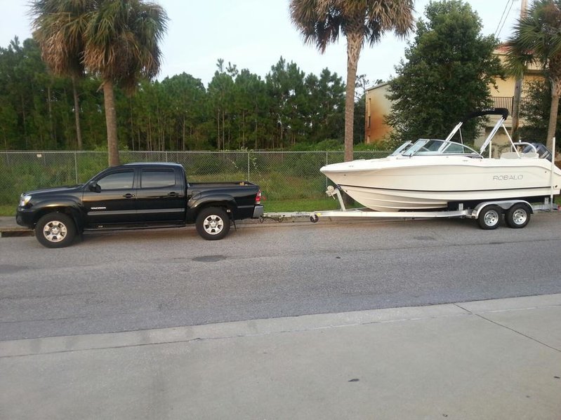

    I just took delivery of this boat and trailer on Saturday. The weight listed is 3,400 lbs with motor and I have an aluminu double axle trailer with 4 wheel surge brakes. I will get it weighed soon. For guessing purposes I dont think its much over 4,500 and and at most 4,700lbs loaded, light fuel. I live in NW FL and it is flat and straight.
    Issue: The truck will not go above 60 mph and stays in 4th the whole time. Sometimes it holds 3rd above 3,000 rpms when accelerating. It pulls it out of the water no problem at all in 2wd.
    I know I dont need to be going above 60 but it should be able to.
    Any thoughts? Thanks

    Keep the truck in 4, not D. With that load you don't want it trying to get 5th.
    I would think you'd be able to get 65 or so in 4th, but if it kicks down to 3rd it'll hold it. I found it won't shift back to 4th until it can switch to 4th and lockup the converter.
    I'd get that thing weighed, I bet it's a bit heavier than you think. And factor in any gear and extra passengers too!
    People get so wrapped in the max tow rating from the MFR, but there's a lot to that. You should really be looking at the gvwr, and where you stand on that.

    What you should look out for is the torque converter unlocking/locking. When the converter unlocks the transmission temp climbs quickly.
    You can tell the converter is unlocked because it'll kick down a couple hundred RPM, but not a whole gear.
    I preferred to keep the truck to 60 or below in 3rd, which would keep it under 3500rpm. If it wouldn't shift to 4th when I hit 60 I'd usually just slide the shifter to 3 until things leveled out.
    I hauled a 22', ~3800lb travel trailer through some pretty hilly terrain and usually I could keep it in 4th until I hit a long hill or 3-4% grade. Granted you're pulling more, but it's flat and I would think the boat would have a bit less aerodynamic drag than a TT.
    Regardless, what you described is normal for the truck.

    Just had my boat and trailer weighed, 4,720lbs. Dual axle aluminum trailer, Boat with fuel and motor. It is a couple hudred over what I figured. I am getting use to it trailering.
    My question to all you fine folks is do you think this much weight will cause problems in the future or should the Tacoma handle it? Trailering on flat road roads, no trips over 40 mile each way. Maybe an occasional trip of 75 miles away.

    If that's all you tow I would do it, it'll be fine. Keep the transmission in 4 and I'd stay under 70. Maintain the truck at earlier intervals, especially the trams and rear diff.
    Everyone seems to suggest relocating the rear diff breather if you're submerging the rear axle.
    The trailer has brakes, right? Stopping would be a concern with that weight.

    Do you have the factory tow package? If not, I think you're pulling too much weight - especially in Florida heat.

    Owner manual states not to tow in over drive.

    Thanks all. I do have the factory tow package and the trailer does have brakes on both axles. Because of the longer tounge I don't have to submerge the rear end. It stops pretty well. I took the
    Bimini off to go out in the gulf today. It trailered a lot better. I use tmy Taco to commute and tow the boat and that's it. I am less concerned now. I will tell you milage is not good.

    Oh. You were pulling it with the Bimini up? That's like running with a parachute on your back :)
    I think most Bimini tops are rated for around 35 mph too....

    I had it up not opened. I really was suprised how much drag ot does cause. Even while on the water I noticed a difference today.

    I'd definitely keep it in 4th, but you should be able to go above 60 no problem. Not that I recommend towing at high speeds, but the truck not being able to break 60 doesn't sound right. Might want to make sure the brakes aren't dragging if you're still having that problem now that you've removed the bimini.
