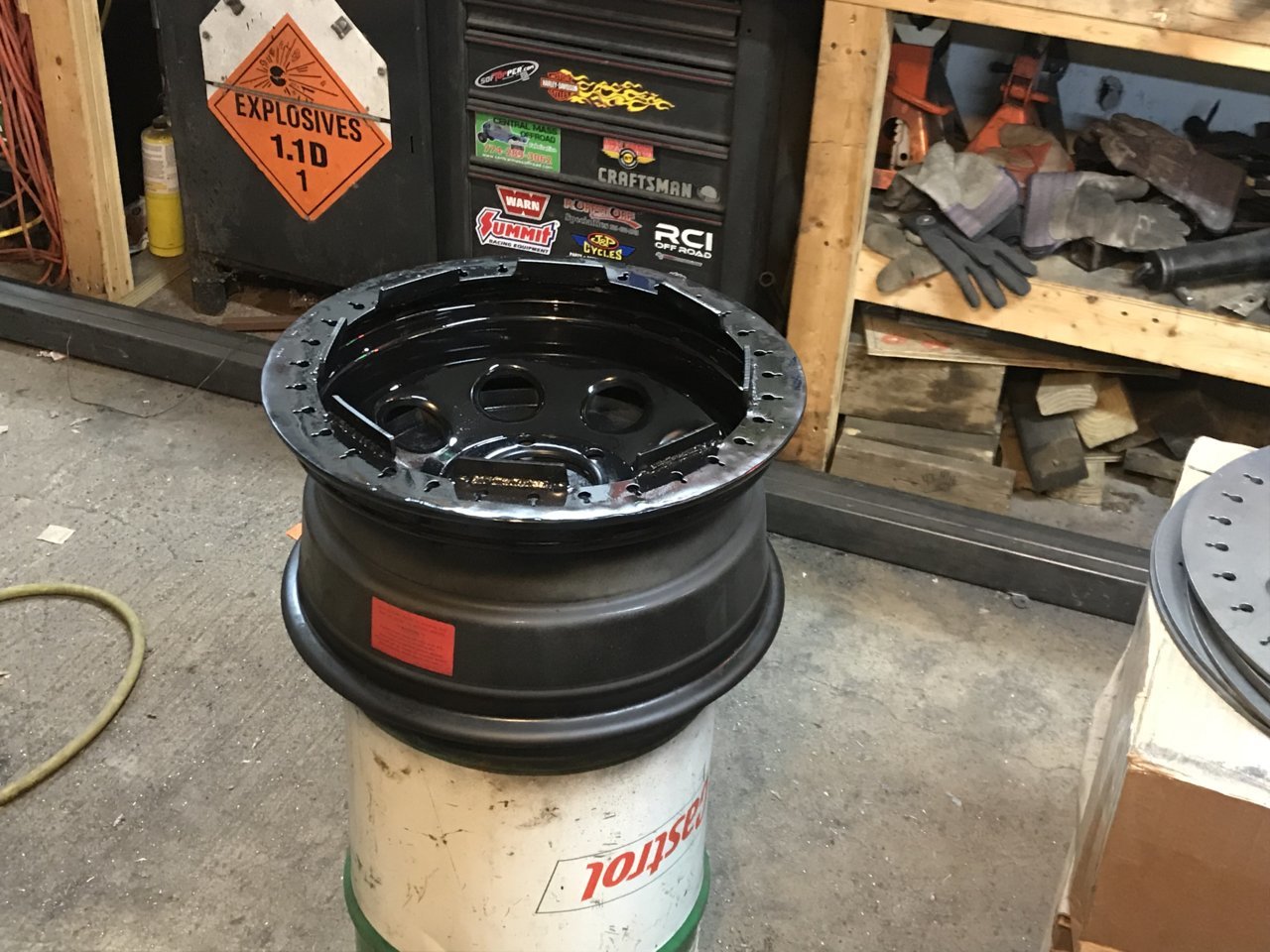

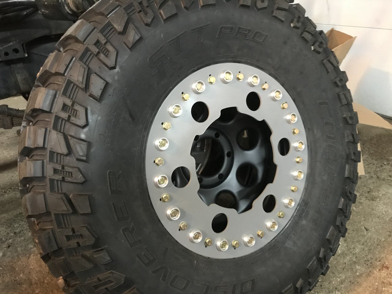

    Alright, with brand new 37” Cooper Pros, I have 11.25” of ground clearance under the lowest point of the 60.
    So you can compare apples to apples, its 6.25” from the center of the axle tube to the lowest point on the center section.
    Anyone feel like measuring their stock rear from center of the axle tube to lowest point on the center? I’m curious.

    Don’t have the measurement for you, but what wheels are those? Rock rings look beefy

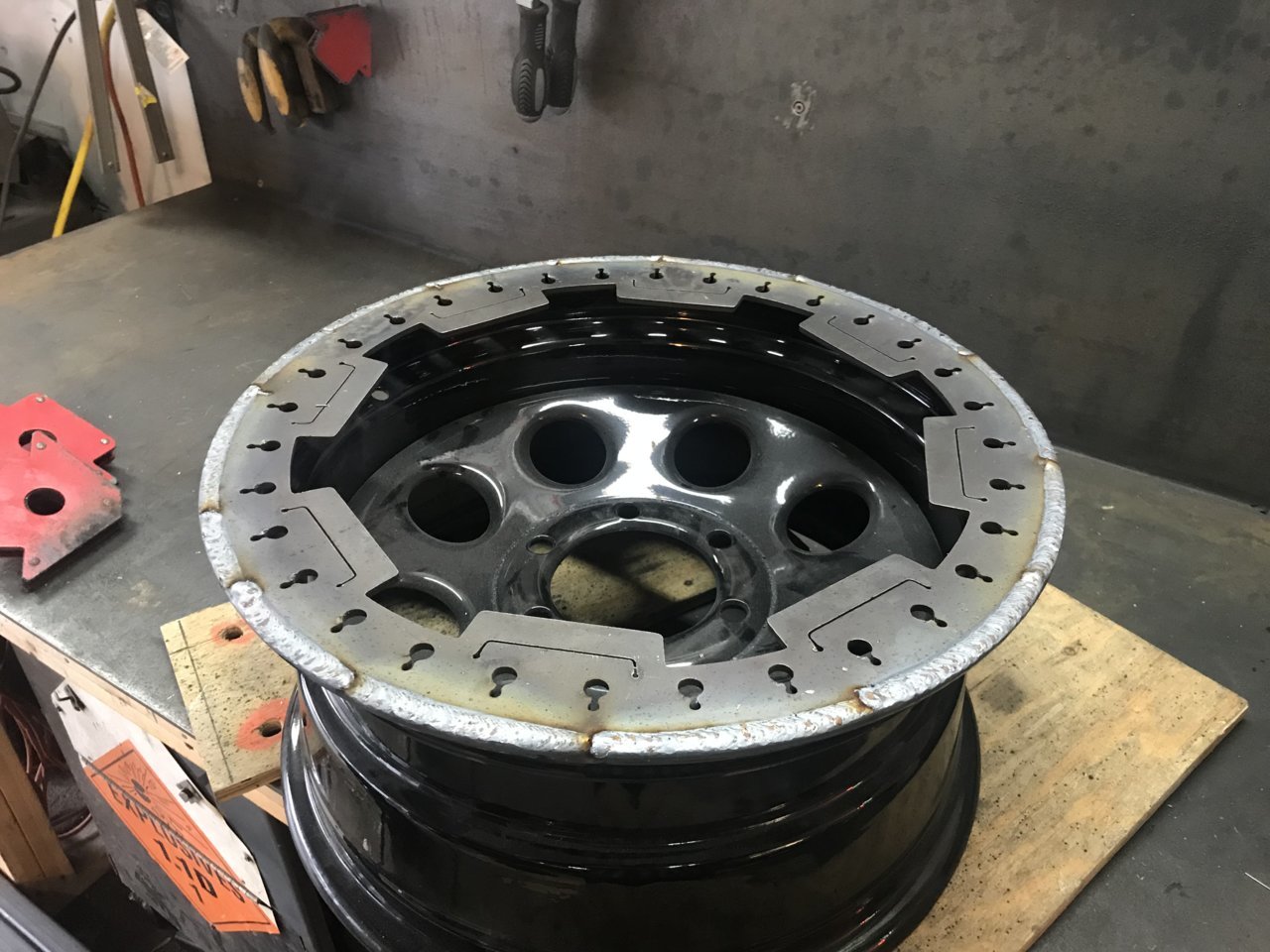

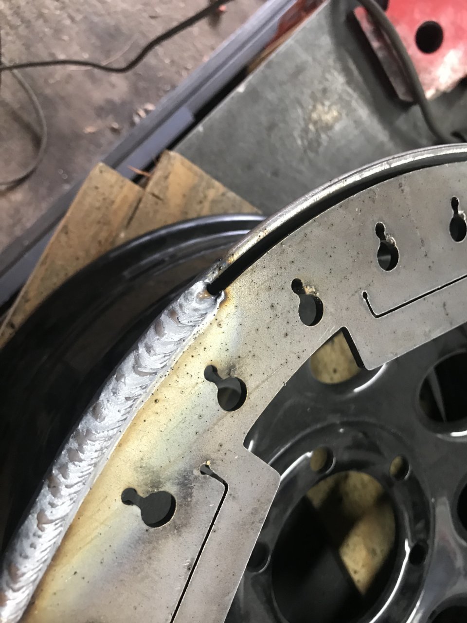

    They are beefy. They’re Jegs brand 17” steelies with TMI weld on beadlocks. Both the weld on ring, and the bolt on ring are 3/16”. You CAN get them 1/4” but I thought that might be a little over kill. And they’re heavy enough as it is.

    They’re 17” Jegs steelies with 4” BS. 3/4” spacer to JUST clear the front calipers to be more precise.

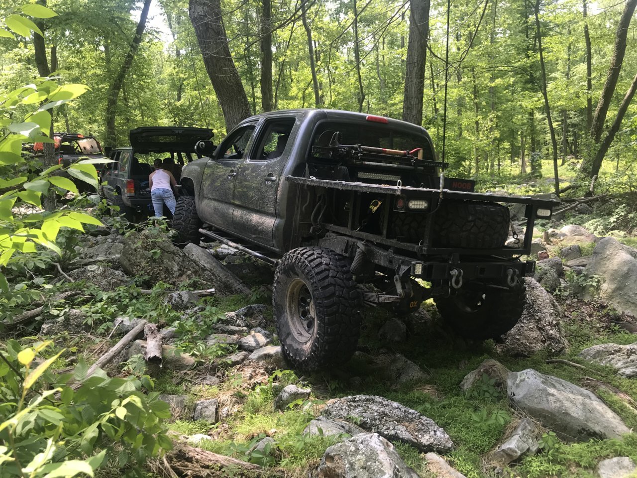

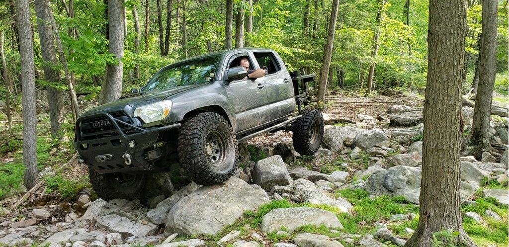

    Just figured I’d bump this thread. Now that I have a few trips on the 60, I can say that it, and the OX locker, are performing flawlessly.
    Best of all? I haven’t broken it yet :D
