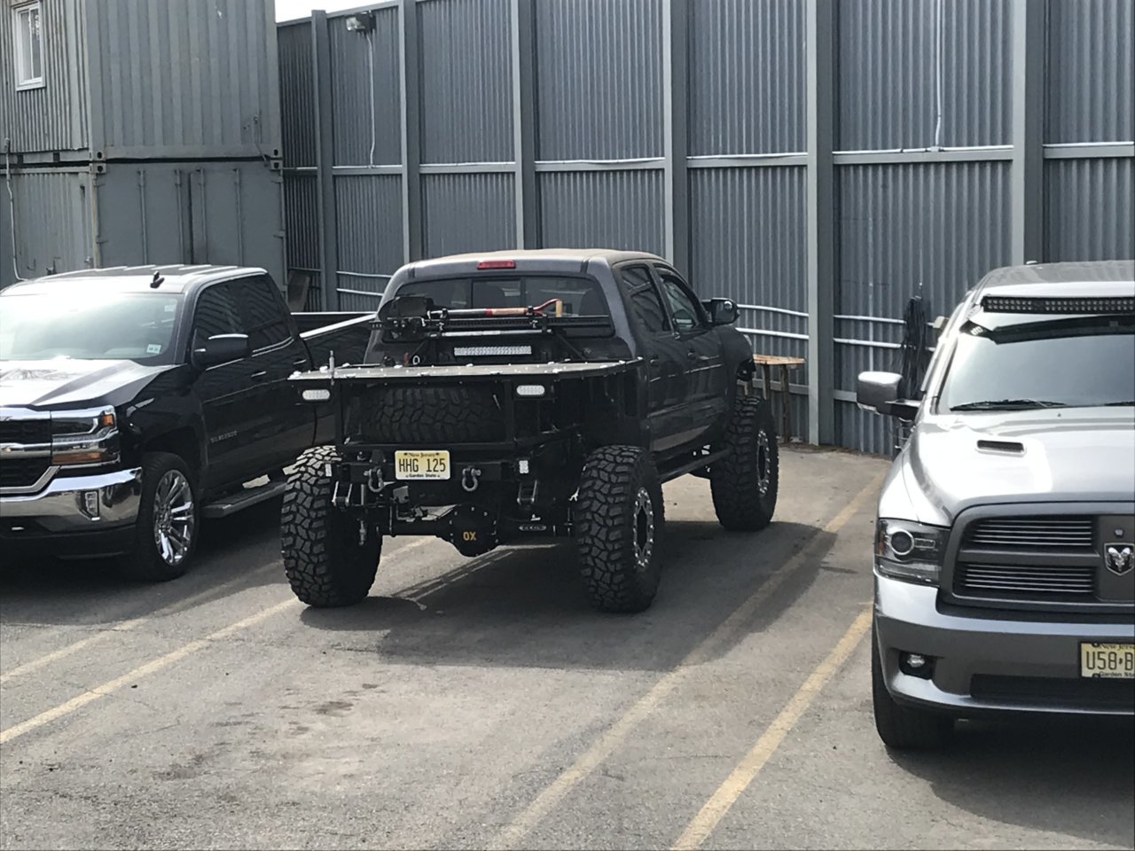

    That’s another bonus of the 60. The OX locker is awesome.
    But, if I weren’t breaking rear diffs like they were disposable, I would not have spent the money on the 60 either. The supercharger, traction bar, and 35s were just too much for the 8”. Add 37s to the mix, and I knew I needed to upgrade.
    And don’t get me started on leaking ARBs... I sent both of mine back multiple times. If the front leaks again, I’m going to a Harrup.
    Or, another 60 and OX :D
