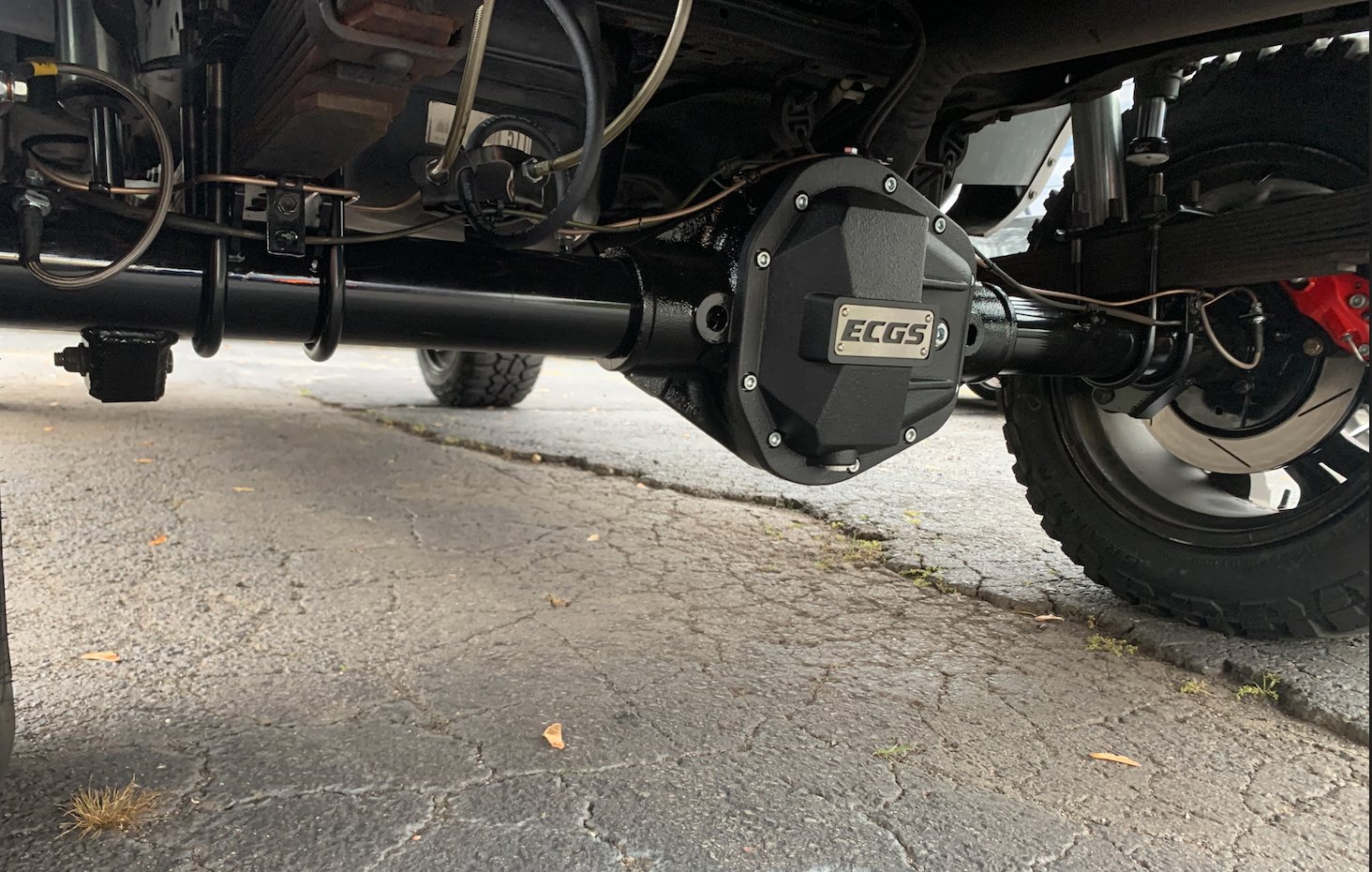

    Installed the ECGS Dana 60 rear end 2 months ago and very happy with it so far.
    ECGS was top notch with customer service and they went above and beyond to quickly resolve an issue with my front end (changed over to 4.88 gears so exchanged clamshells).
    I also installed the StopTech disc brake kit (BBK in front as well). I was worried about DTC's regarding disabling the OEM traction control or braking system but ECGS assured me it would be compatible & it was. they even installed the rotor, caliper and emergency brake on the Dana 60 before shipping it.
    The truck drives great, definitely feels heavier and the MPG's aren't great but its a truck. The reason I went for the Dana 60 bc I cracked the OEM rear axle housing messing around in the snow last year. My local garage welded it back to drivable but it needed to be replaced. Looks like the OEM rear axle housing is a weak link so took the opportunity to upgrade :)

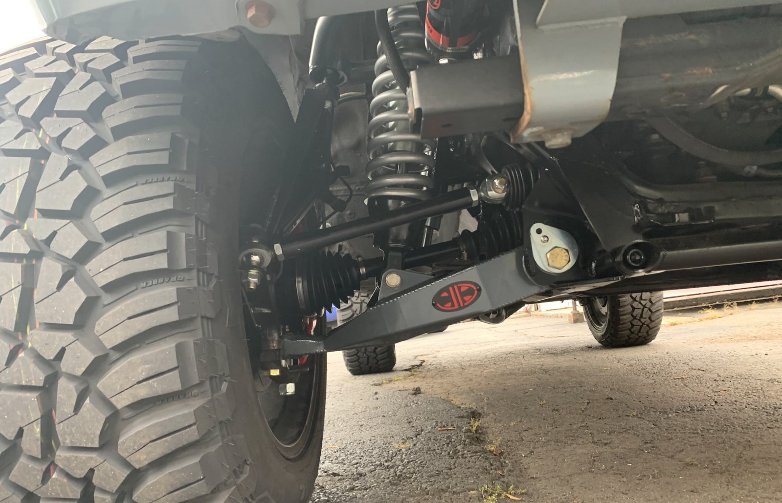

    Definitely a solid rear axle and I was considering it. I went with the ECGS Dana 60 since it was more compatible with the OEM ABS using the SOSPerformance StopTech BBK kit/brake cylinder mod/emergency brake.
    If my truck did more heavy off-road use the JDFab floating axle would be the way to go. It looks indestructible.
    I have JDFab the 2.25" kit with LCA frame. They make some of the best kits out there.
