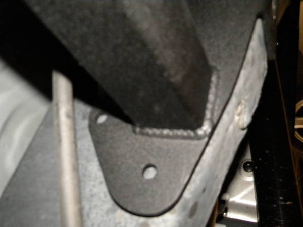

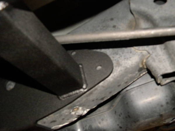

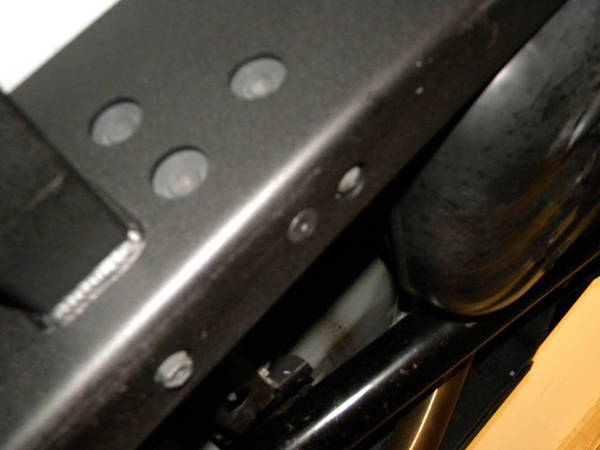

    OK so i got to bolting these things up today.
    Here is a better shot of the recessed bolts on the bottom
    they sit completely flush, pretty trick...
    Here is a shot on the truck, I used spray bedliner in a can, and they came out nice
    I do have some questions. I would say they are 90% installed. I need to take them off and drill the top two holes from the front leg, I tried to do it with them on, but I ended up breaking a self tap screw, and gave up on those for today. I understand those, I assume a right angle drill will fit up there. I will need to go pick up one more screw
    here is a legit question. There are 4 bolt that go through the side of the frame, three being existing holes. at the back of the plate there is this
    and this
    Which hole do I use? or both? the top hole it so close to the bar, that I couldnt put a washer on it ( I had the same issue on the front most hole on the drivers side). I am going to mark it so I can drill it when I take them off to fix the front leg.
    They are good enough for steps now, but I want to make sure they are rock solid....

    Justin,
    You do not need to bolt both of those holes up. Just use the rear most hole to drill and mount your bolts. We have now eliminated the top hole as it was used for an access cab, but the rear most hole is universal from an AC to a DC now.
    Let me know if you have any other questions. We are working on the instructions this week and should now be going out with any new orders for the Rock Sliders!

    you have to drill 4 holes in the bottom of the frame on each side, and 5 holes in the side on each side. it uses 3 existing holes on each side.
    not huge holes either, so if you have a sharp bit and keep it oiled, it will cut through pretty easy.
