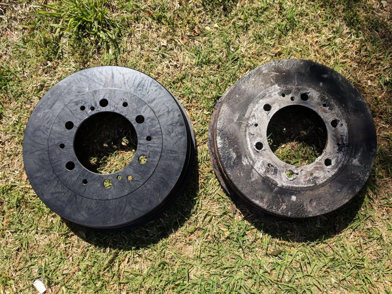

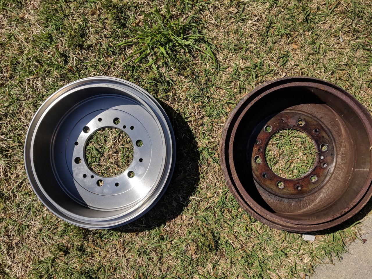

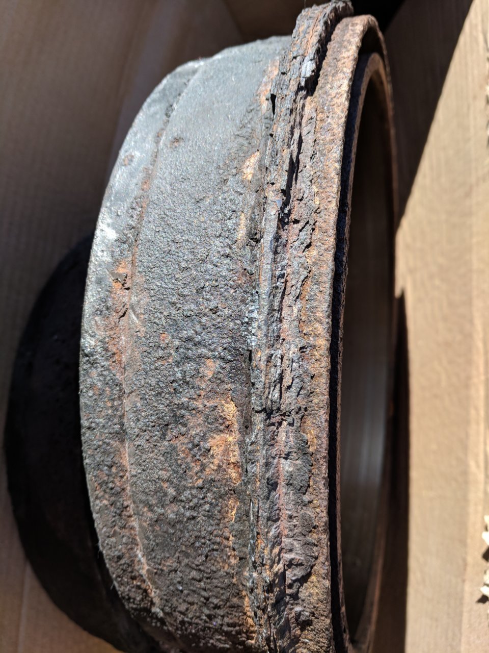

    So I did this today. Glad I did. Everything was shot, not just the drums. Cracked pads on 1 side and missing pin on the other. Word to the wise. If you live anywhere they salt more than 7 days a year, bettah check yours at 100k miles. Mine were just shy of 130k. They were so bad that when I tried to pry them off the rim of the drum just flaked into pieces. It's not just about pad thickness.IMG_20180420_104812.jpg IMG_20180420_104730.jpg IMG_20180420_104719.jpg

    Replaced all the springs too. Star adjusters & cylinders were good, but if there is a next time, will do them too.

    Paint the new drums, to keep the rust at bay.

    Drums and shoes and springs and maybe cylinders are on my list this summer. Don’t believe the posts that say ‘back in my day I used to get 150k miles or whatever’ mileage without touching the rear stock brakes, without issues. It is misinformation. Maybe the truck still stops safely but it’s not a very pleasant driving experience during most stops.
    My front brake job last summer (75k miles) on this truck was the first time ignoring the rears on any vehicle (following that guidance) I’ve ever done, and it’s also the first time I had brake-feel issues start to occur in the rear. I’ll stick with complete brake jobs from now on for this truck just like any other vehicle I personally would drive.

    Agree with @mbrogz3000 the truck was braking "fine", but without a pin in the front shoe it was waiting for disaster. It had apparently rusted and fell out somewhere along the line. As they say ignorance is bliss. Would definitely check them at certain intervals. Even if they brake fine. I'm really glad I did. Appreciate all advice on this thread.

    Might as well powder coat the drums. Holy smokes his were bad!
