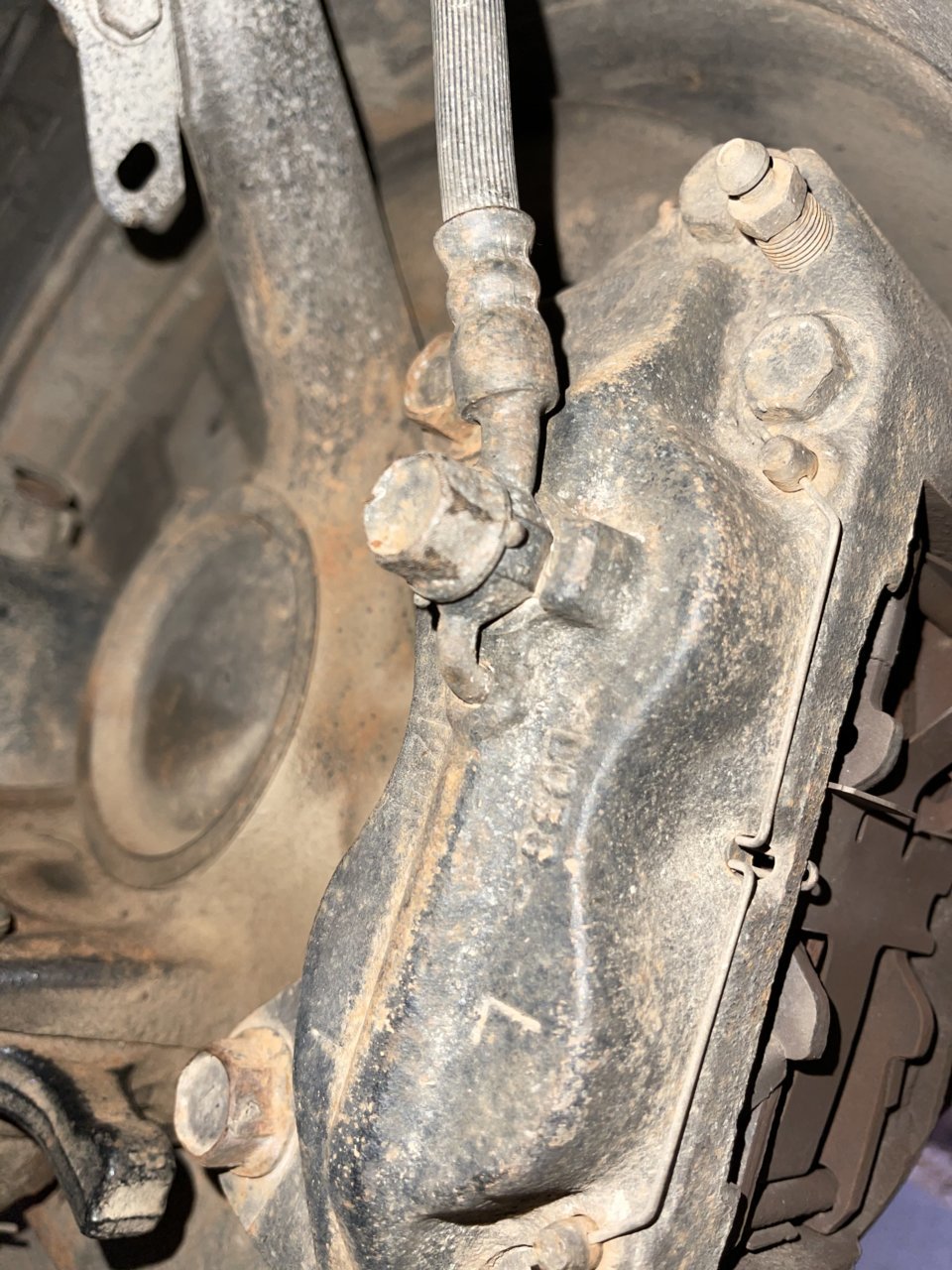

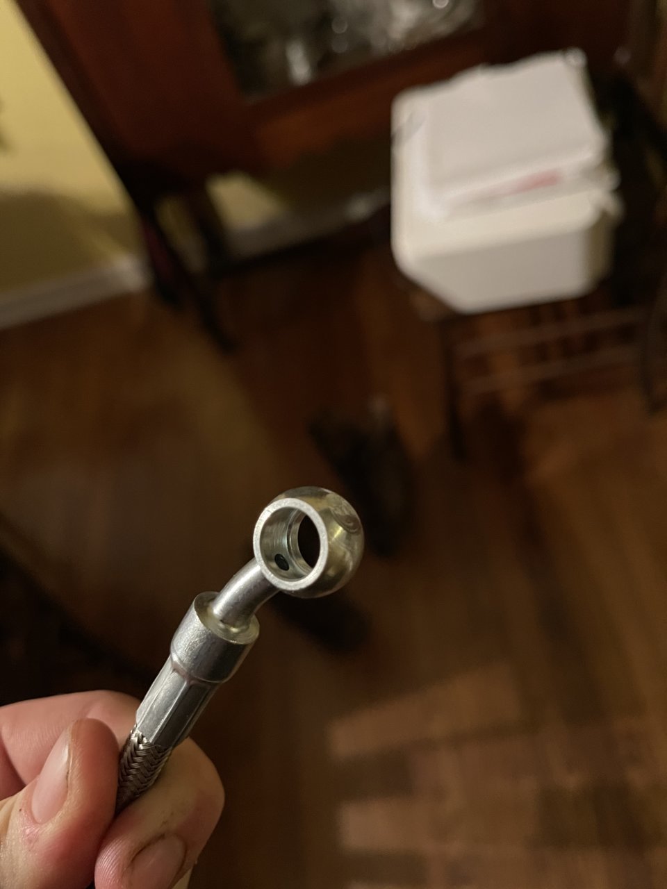

    So I bought these brake lines from
    Wheelers, and I notice the stock line has that little “line” coming off of it. The new ones do not. Is that “line” for fluid or to line it up, I am not really sure.
    I don’t want to go ripping the old ones off and these don’t work.

    Dont know the term but it helps hold it in place, no fluid in the tab

    It just keeps the banjo fitting from rotating while you are tightening the banjo bolt.

    I think 'banjo positioning tab' is a reasonable term.
    Gets the line in the right spot and holds it there. Good to have, but not required.
