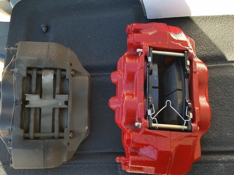

    The brakes are not the best on my 99 tacoma and I will be putting mud tires on soon. What are some good brakes and their prices?

    Tundra big brake upgrade or gtfo lol

    I did the Tacoma power stop set a while back. Not sure why I didn't do the tundra upgrade. They work great however, and it does not feel like I'm missing any breaking power. I liked it so much I did all four wheels (calipers, rotors and pads) on my Accord. Only trick is following the break-in procedure. Follow the instructions or the pads may squeal when breaking.

    Supercharged, AEM FIC/6, Meth Inj, ION Alloy's, Radio & Phone steering Wheel controls,Fabtech AAL, Billie's wrapped with 880's , Tundra big brake conversion, bully bars and Pioneer DDin Stereo/dvd with exterrnal usb ports. 290K and going strong.

    Worked out well for me. Great stopping power.

    does this fit with 15'' wheels

    No

    16" and up.
    It is completely worth it! Stop like you never have stopped before.

    Even with 16's, fit is not guaranteed. I've read about a few people with fit issues. Some people end up with wheel spacers, and some even grind the caliper a bit.

    I purchased reman calipers from NAPA and gave my old ones back as cores. No questions asked. New rotors also.

    I'm not exactly sure why, but ONE of my wheels doesn't fit with the Tundra Brake Upgrade and I have the exact kit from Power Stop. Passenger side works great (it's CLOSE), but it does all fit. Drivers side... No dice. I even called Power Stop to ensure they were the 13WL casting, but it doesn't fit on the driver's side. I literally tried everything I can think of- to include re-installing- but it still didn't work. I ended up ordering SpiderTrax wheel spacers so we'll see what happens when I get those on. They'll be in on Monday, so hopefully the truck will be done (at least for the time being)...

    Are you sure that kit came with 13WL calipers? Those characters should be stamped right on the caliper?
