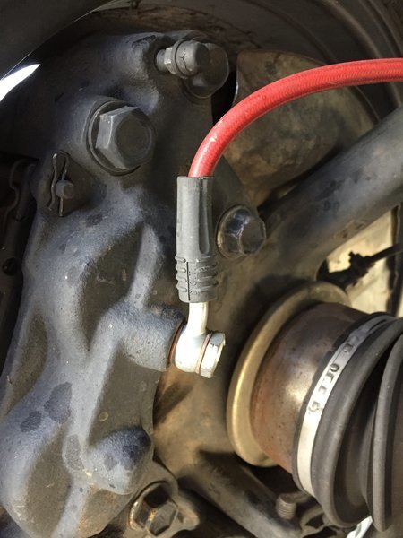

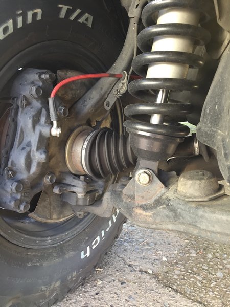

    does anyone know if the 13wl will work with wheelers braided lines ? knowing that they have a banjo bolt instead of a hard line.

    Worked for me. I have that exact set up. Same picture, just a little different angle

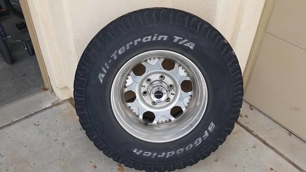

    Hmmm.. Wonder if these will work with tundra brakes. Found these 16.5x10 centerlines for sell. $450.

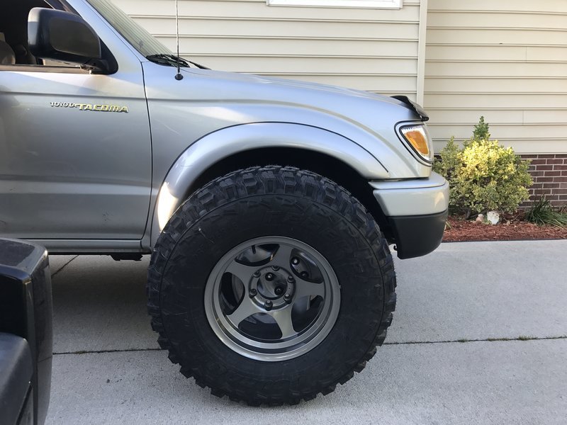

    Jordan
    Temecula, CA
    2000 Xtra Cab 3.4L PreRunner TRD
    Happy to report no fitment issues with the FN Five Stars. I am getting more pedal travel than with stock brakes though, which makes them feel soft but not unsafe. Hoping the brake feel gets better as I break them in more.

    Can't wait to see em. Considering getting these in the future.. Tired of researching the old school rim and fitment. Might be time for some modern wheels I guess.. Ha.What size tires are those?

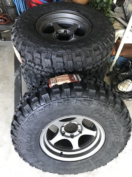

    hmmm interesting. ya now im wondering how the pedal feel is going to be. But im sure you feel the difference in stopping power compared to the old setup i hope? also wheels looking good man! going with the Napa remans since they come painted black to match the black lug nuts i got and i think it'll look good with the gunmetal version of our wheels.
    ill be sure to post pics as well once i get them on. Im not sure what size tires @Mugen is running but im running Federal Couragia M/T's 285/75/16 theyre just under 33's. I believe they translate to 32.9x11.1?
