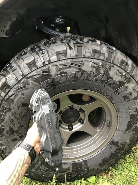

    MurkEm
    MurkEm Well-Known Member
    Apr 29, 2017
    #217664
    110
    Rocky
    2002 Lunar Mist Taco DBL Cab 4x4
    Toytec Boss Lift, Total Chaos UCA, OME Dakar Leaf, FN Wheels 5-Star, Federal Couragia MT's
    these are 16x8 -25 3.52 BS wrapped on 285/75/16 tires
  2. May 24, 2017 at 9:51 PM
    #42
    ThunderOne
    ThunderOne Well-Known Member
    May 20, 2009
    #17473
    10,043
    Mitchell
    Nashville
    1ST GEN OR GTFO
    Toyota NERD
    Damn. They looked massive sitting next to your truck like that lol

  3. May 24, 2017 at 10:00 PM
    #43
    NightProwler
    NightProwler Well-Known Member
    Nov 12, 2013
    #116470
    3,506
    Harlan
    Maricopa, Az
    '01 Prerunner, '16 trd4x4, '03 cbr954rr, '03 rc51
    Ha I was gonna say that too. Looked like at least 295. Wondering if I could fit those or maybe 305/70's since I have 33" now. Doubt I'd fit 315 tho.

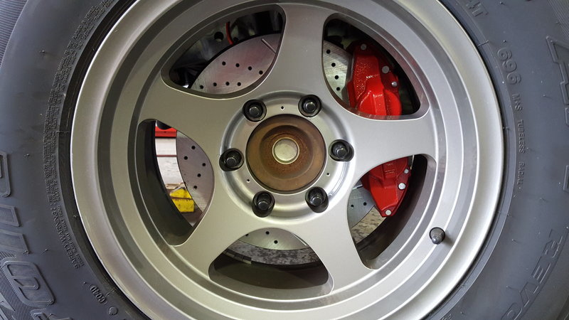

  16. May 26, 2017 at 5:26 PM
    #56
    Mugen
    Mugen Member
    Apr 13, 2014
    #127607
    12
    Jordan
    Temecula, CA
    2000 Xtra Cab 3.4L PreRunner TRD
    I'm getting more used to the pedal feel now. They definitely more capable in terms of stopping power than the stock brakes. When I first fit the new wheels and 265/75R16s, I sometimes wasn't sure if the truck was ever going to stop when I was pushing hard on the stock brakes, haha. The Tundras feel like they will stop as hard as you can push the pedal. I imagine with your tires you will notice the difference even more.
    And yeah, I think anything would look good with these wheels! Still can't stop staring at them!

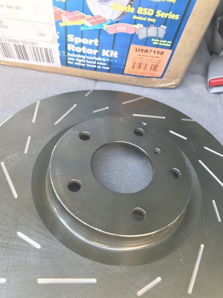

    update.
    I'm all ready for the brake swap for this weekend. but come to find out EBC packaged the wrong brakes. right serial number on box but the rotors only had 5 lugs and not 6lug. which was a huge disappointment so now I have to get a response back from their sales manager for a solution.
  18. May 27, 2017 at 5:48 AM
    #58
    mechanicjon
    mechanicjon They call me "Jonny Stubs"
    Dec 2, 2016
    #203828
    10,149
    Jon
    Scottsdale Arizona
    04 Taco SC 4dr SR5 TRD Prerunner
    Supercharged, AEM FIC/6, Meth Inj, ION Alloy's, Radio & Phone steering Wheel controls,Fabtech AAL, Billie's wrapped with 880's , Tundra big brake conversion, bully bars and Pioneer DDin Stereo/dvd with exterrnal usb ports. 290K and going strong.
    That bites
  19. May 27, 2017 at 5:52 AM
    #59
    MurkEm
    Apr 29, 2017
    #217664
    110
    Rocky
    Ya But nothing I can do now but wait. Should have received an email yesterday since I pretty much contacted them when they opened since the east coast west coast time difference but still haven't got anything back.
