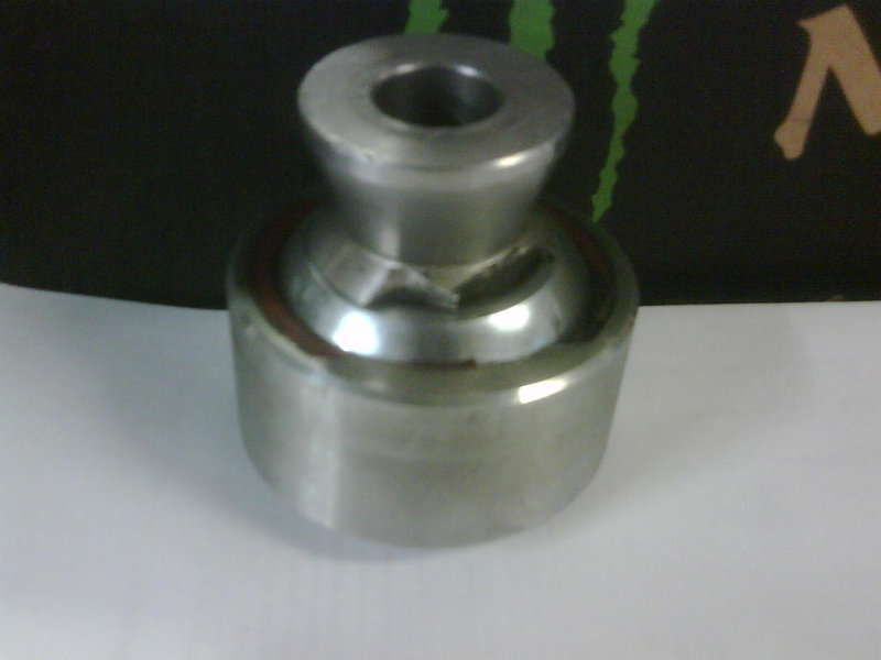

    Well, that was the easy part of the install. My tech f up a sleeve for the uniball and it ended messing up the actual uniball. I had to buy a new one and had it pressed in. From that experience, make sure you bolt the uca to the spindle first, then bolt the bushings in that back.

    Did he ruin the machined insert that goes in between the uniball and high mis-alignment spacer or the actual high mis-alignment spacer itself?

    Here's a pic from my cel

    Oh ouch. You should of just been able to buy the single spacer though I believe. You shouldn't of had to buy a whole new uniball.
