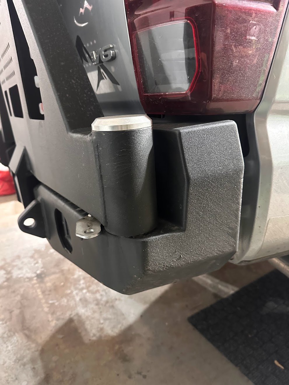

    So I purchased a new rear bumper (A Expedition One Dual Swing), and when I put it on there were no spots to add the rear blind spot radar sensors (one left and one right).
    It's very thick metal and even if the sensors could be mounted on the inside of corners, I doubt the sensors would work through it.
    I'm wondering if anyone has come across this issue and had an answer to somehow add the sensors back? I am thinking of trying to make some enclosure and mounting externally on the bumper in a somewhat similar position.
    Any helpful suggestions would be appreciated.

    You have to find a bumper that is compatible with the BSM. Because 99% are not.

    More like 99.99%.
    I think Apogee Offroad was working on one, but I think they're the only ones.
    There was also a bloke on here, trying to integrate them into his taillights (like Ford), but that was all custom work.
    The rest of us just ditch the BSM sensors and turn our heads to check for traffic.

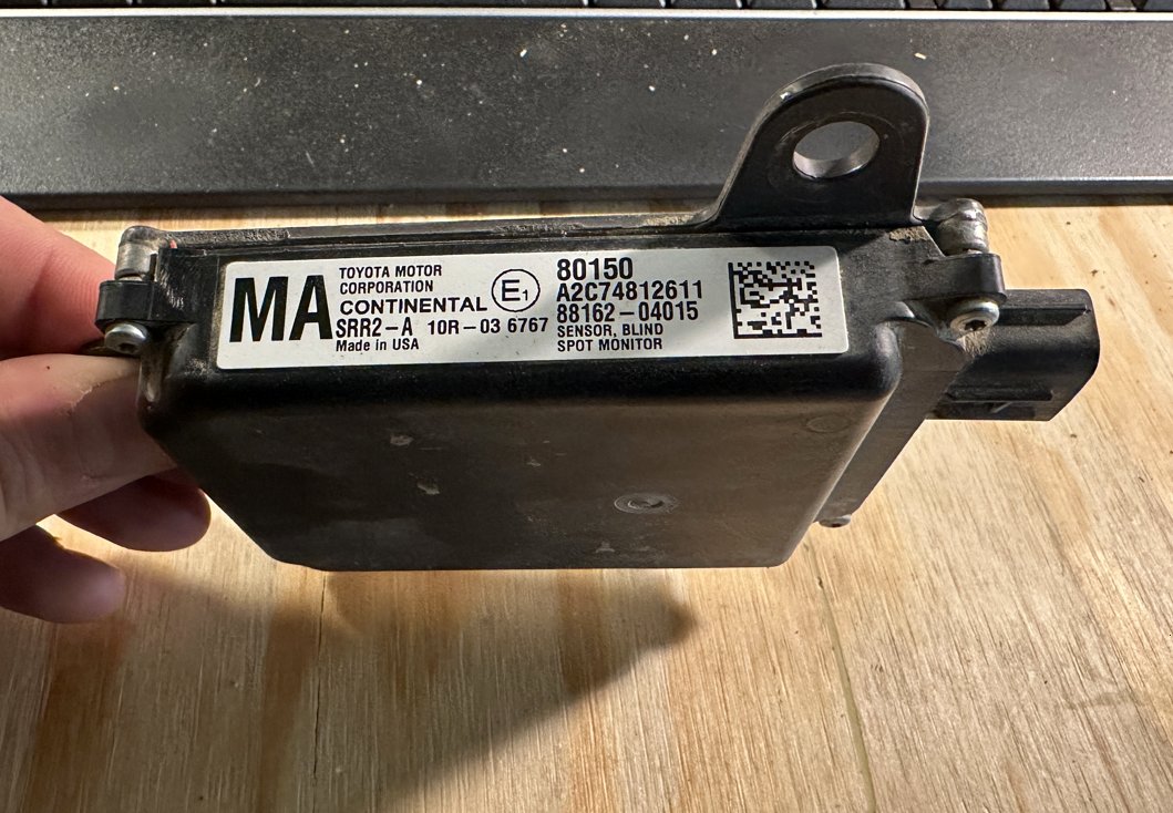

    Apogee, buckstop and 4wp are the only 3 I’ve come across and I’ve been paying close attention
    The sensors in question are blind spot monitor radar sensors that don’t function through metal and have to be mounted at a specific angle below the taillights (or behind the rear wheels at least) then calibrated

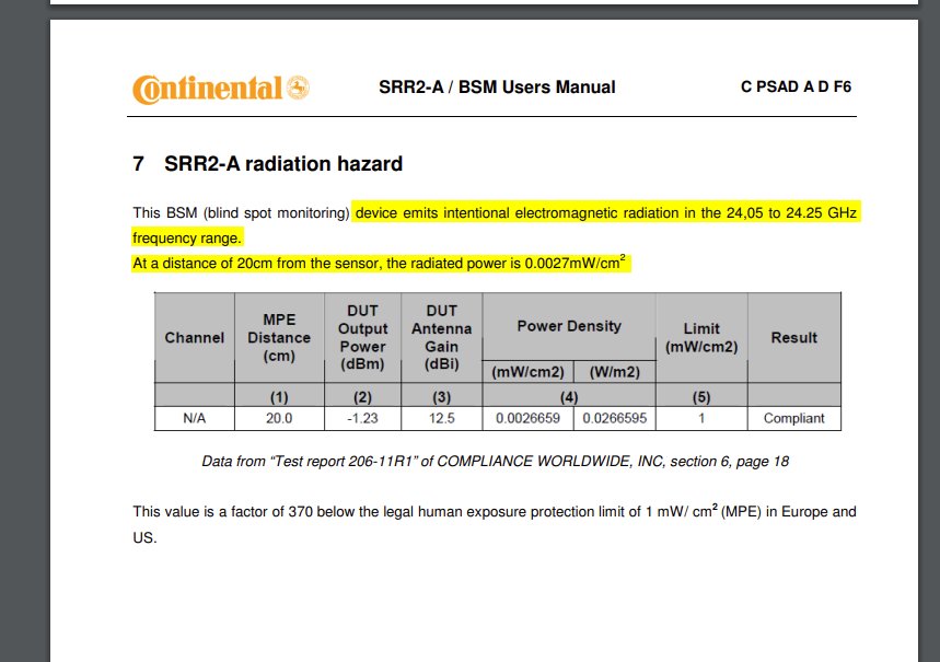

    Good info in this thread. Apparently our 3rd Gens are equipped with a Continental SRR2-A 24 GHz Blind-Spot radar sensor (fccid.io link to manual + attached) that emits radiation in the 24.05 to 24.25 GHz range and emits 0.0027 milliwatts per centimeter squared (not very much which is why the only bumpers it works with have plastic or composite covers that the signal can penetrate).
