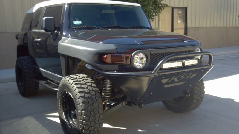

    it's a KR Fab Custom bumper.
    looks kind of like this one:
    obviously for the Taco... haha

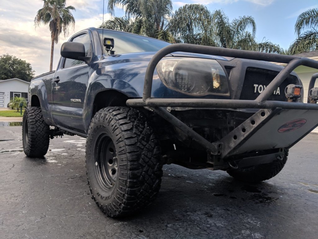

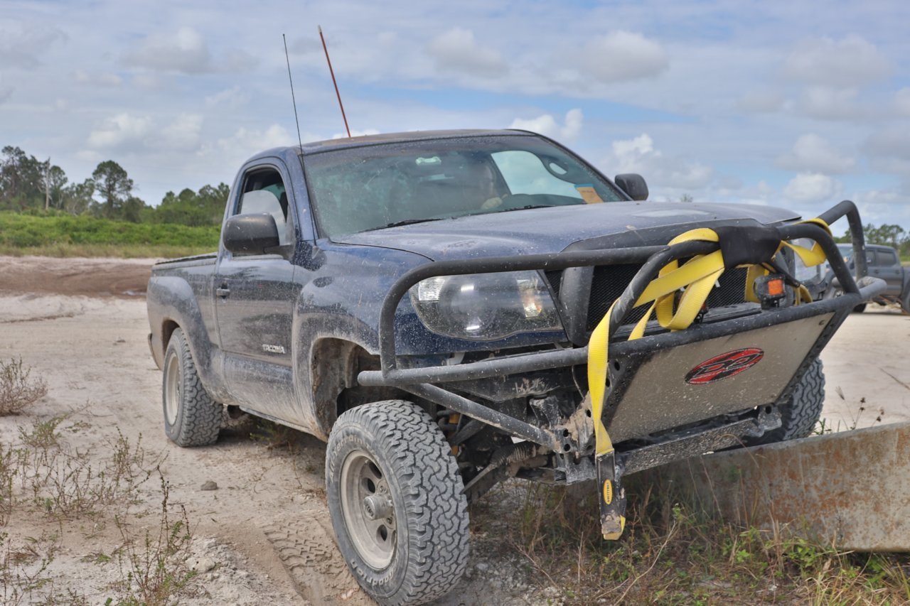

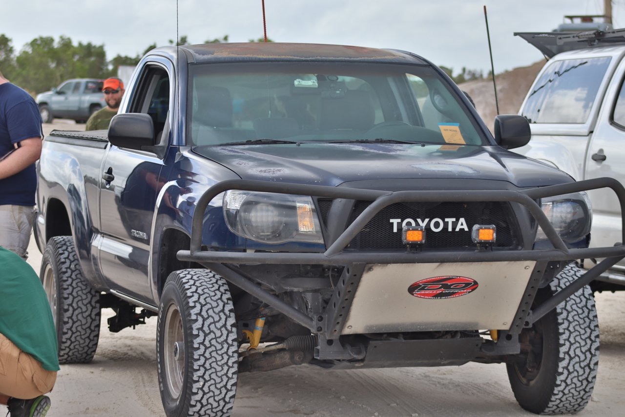

    This was with 29's. I would suggest changing out your front to Bilstien 4600.
