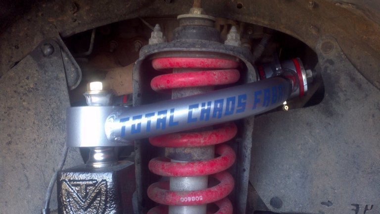

    This was a total failure on my part... I cut too far into the sleeve... :mad: :(
    So the wife told me to get new uca's for safety... didnt want to spend the money but had to.
