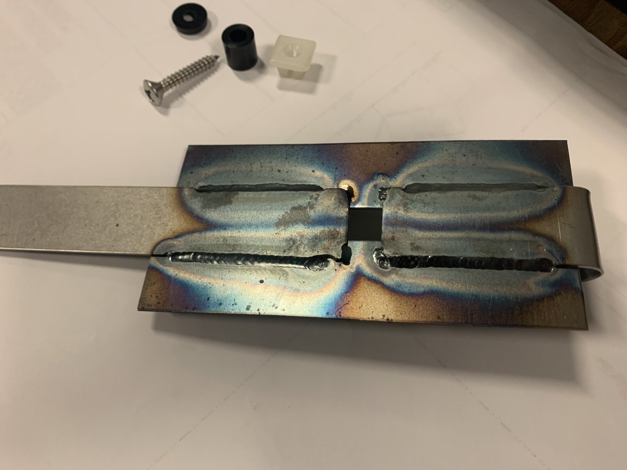

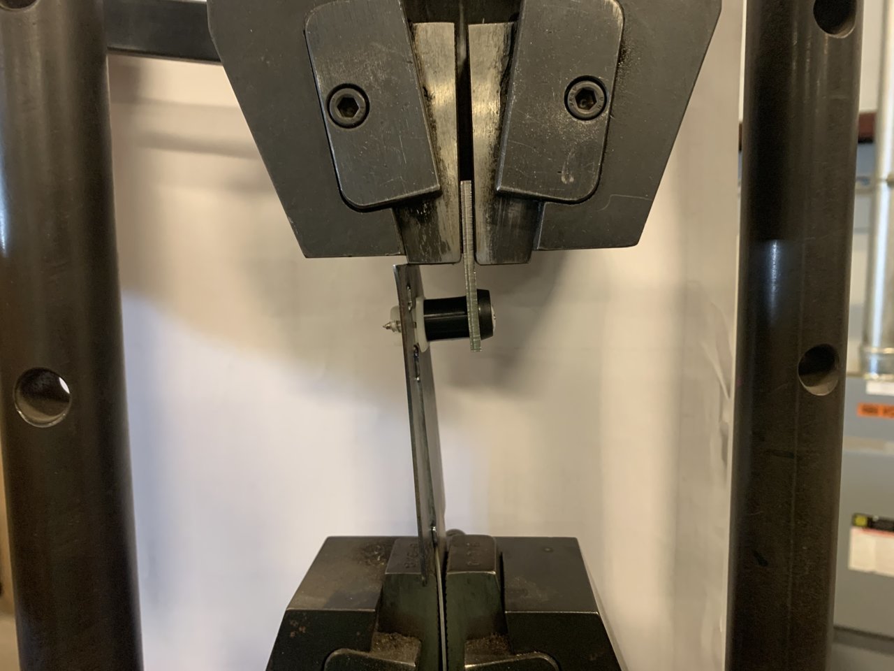

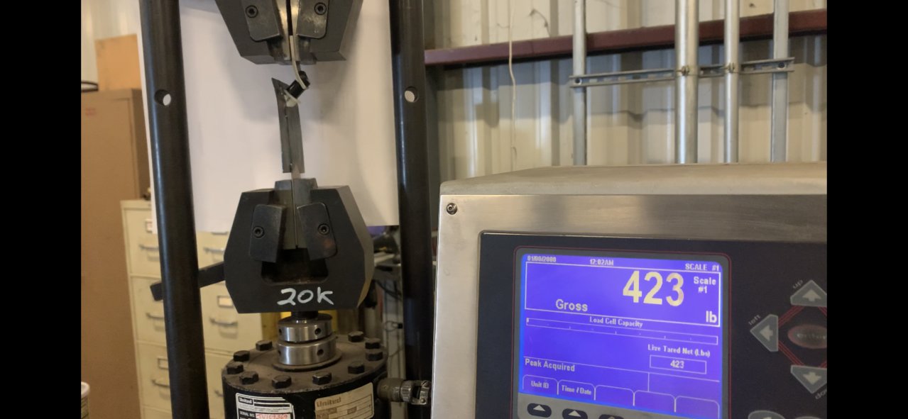

    See photos. Nylon snap nut fits in factory square hole. Performed tensile strength test for hardware that comes with overhead molle rack. Built model to match square opening of factory grab handle holes. One single mount pulled at 423 lbs before failure. So the rack with 4 mounts is plenty strong. Nylon nut just pushes into factory hole. No rivet gun needed.

    i performed tensile test of the mounting hardware i supply with the rack. 1 anchor point by itself pulled 423 lbs before it failed. the metal around the mount is what failed, not the hardware. so with 4 anchor points it is safe to say it will hold a lot. I will hang weights from it and give you a number when that is complete.

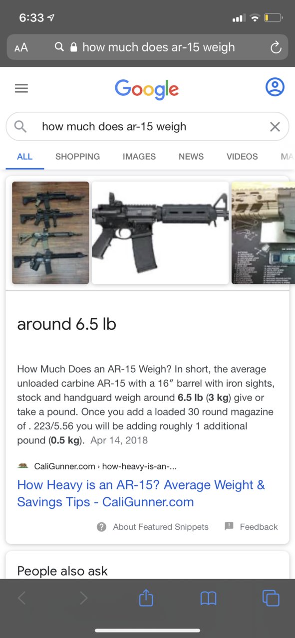

    150D2E24-456E-4DD3-AA0E-36B446420982.jpg D3249AD0-BAAD-43E1-A906-A7A785B7528E.jpg Guaranteed to hold 50lbs! I hung a floor jack right in center with no problem. So with weight spread out I have no doubt it will hold much more. An AR-15 weighs about 7lbs, so get ready to hang 7 rifles or 2,000 bandaids!

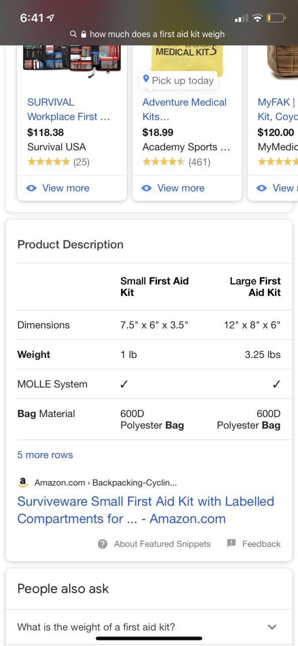

    01562D8A-E94F-4CE3-B603-D574F6007391.jpg Scratch that, you can hang over 15 first aid kits.
