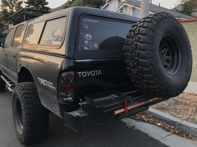

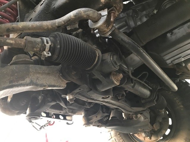

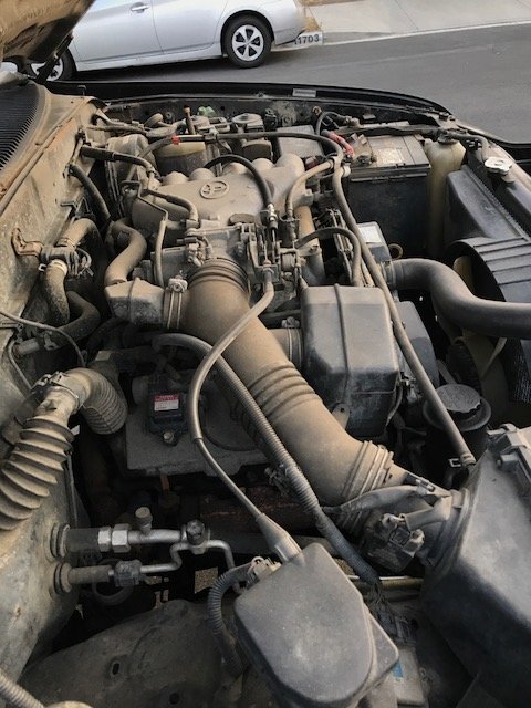

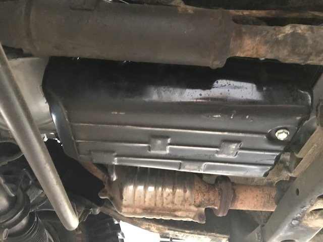

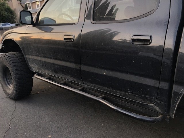

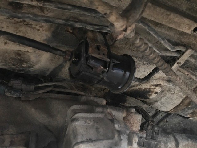

    Added some Pics.

    Thanks Dalandser for the feed back. Pics above in original post.
    We started at $9.8k and came down to $8k.

    All I can say is the California trucks look so much better
    All it took was one winter and the surface rust was every where.
    In the Great Liquid Brine Belt of the Northeast
    dmurph20[OP] likes this.

    THis car started in Kentucky, then TN, now California but has been all over mountians in midwest, CO, UT, AZ, MT, etc.

    The rust based on the pictures doesn't look bad but the guy definitely used the truck (maybe you're planning on using it for same purposes). I would assume its been buried to the hood in water (snorkel) and been flexed out (trimmed bedsides). This isn't a bad thing depending on how the owner took care of it. Just be careful buying someone elses toy and expect that an offroad modded vehicle will most likely need some kind of work done. Seems like a fun toy for 8000 and I admit it looks like a blast to take camping and it is a tacoma so the miles aren't necessarily a bad thing. Just don't be caught in a position where you can't get it smogged and registered because the codes are costly to take care of.
