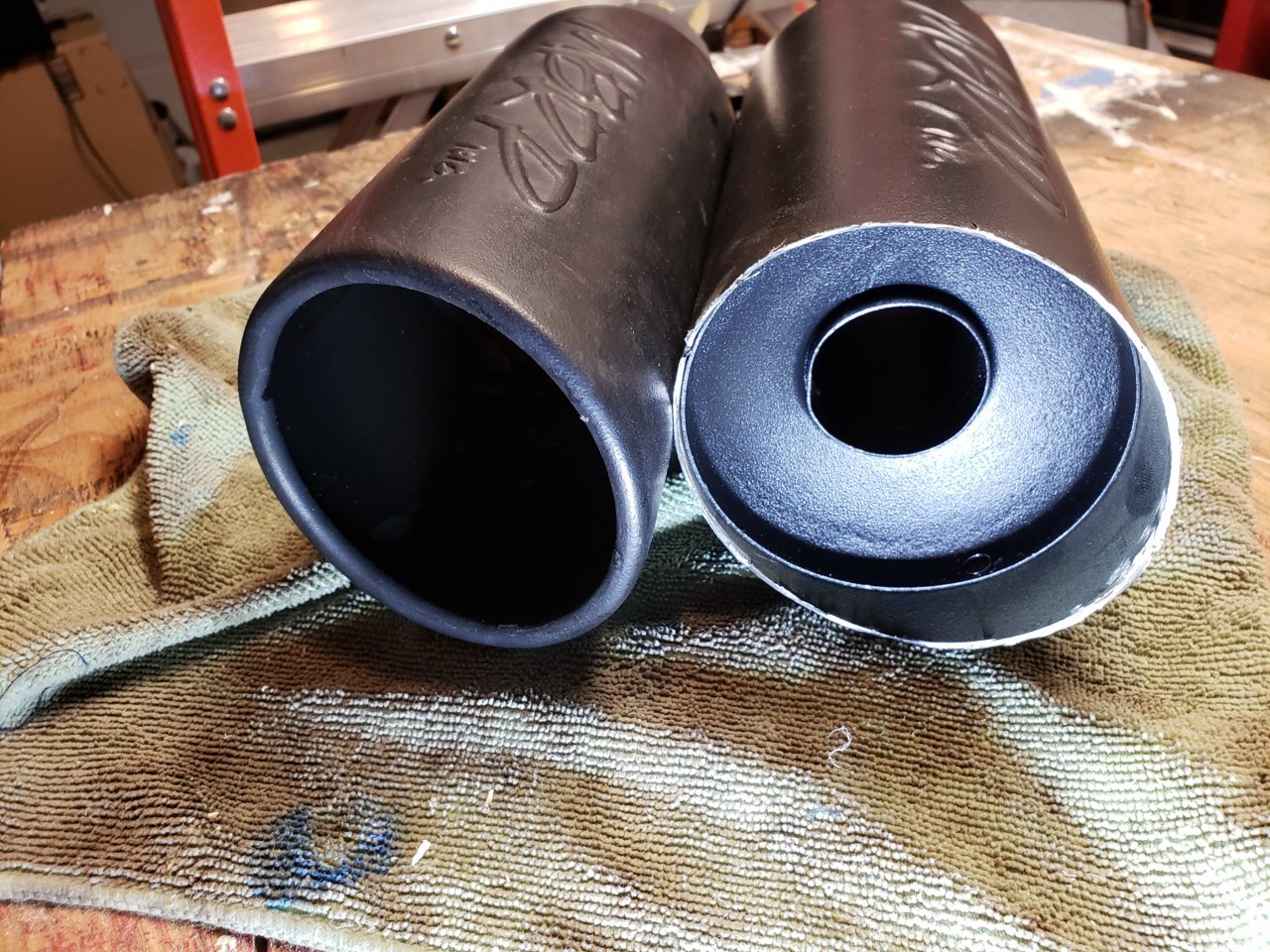

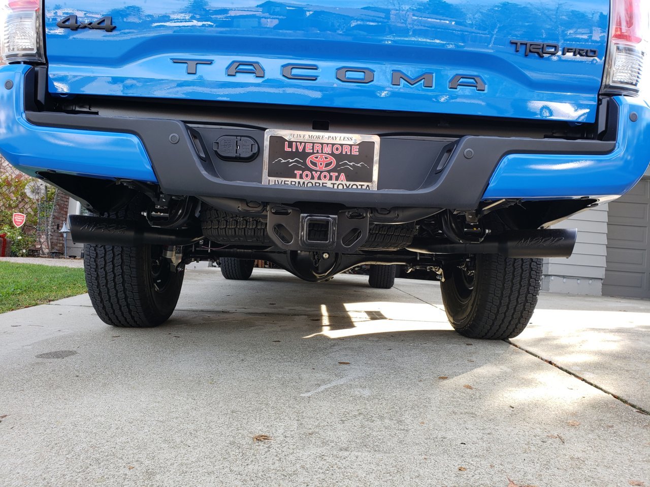

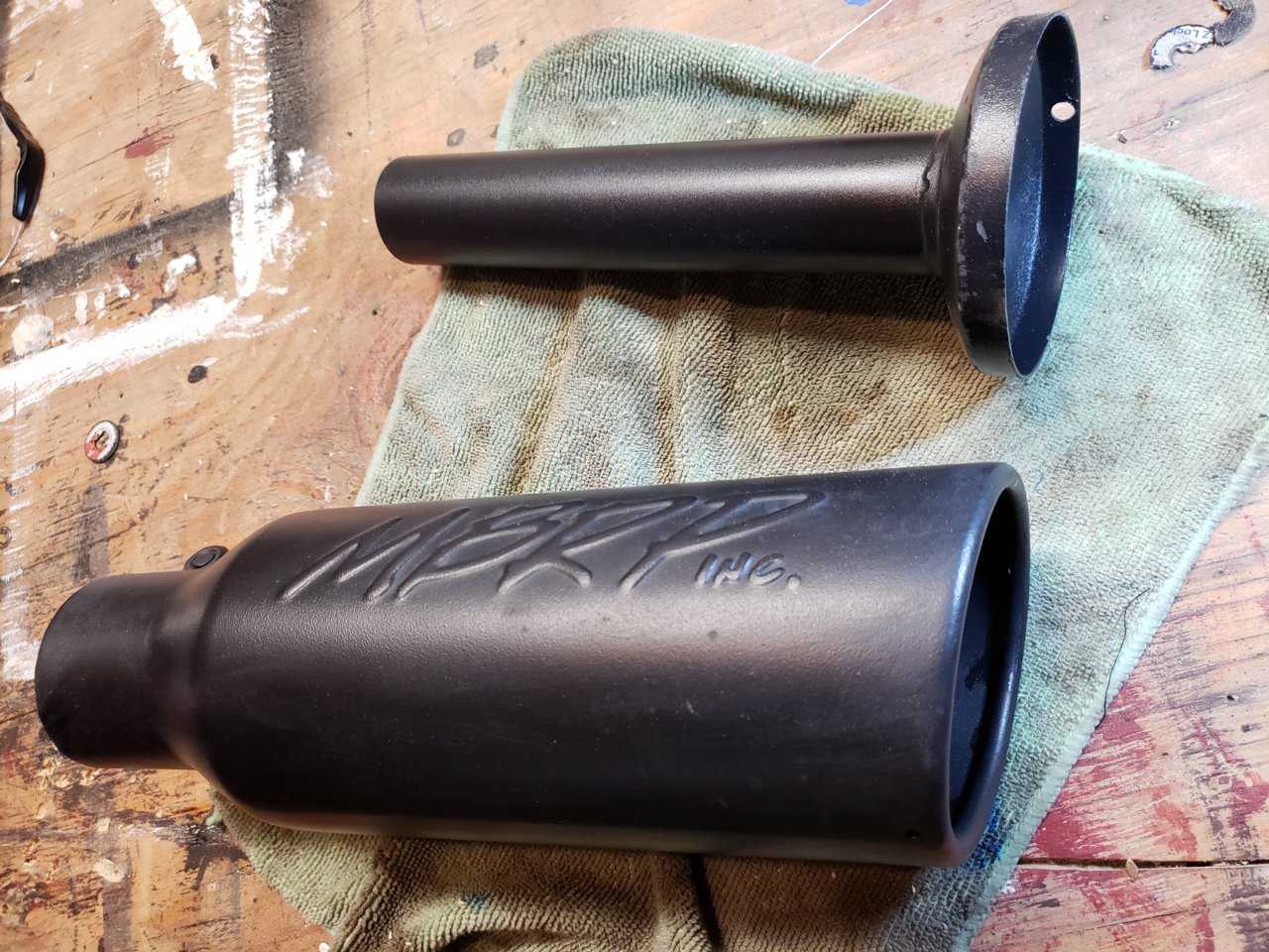

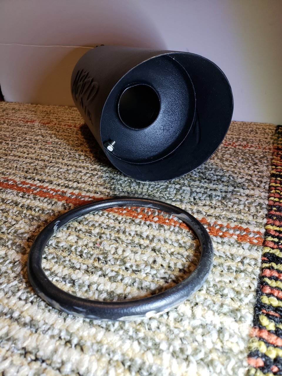

    So.. I did this.. sure is quiet that's for sure... drone sound is significantly reduced though or close to non existant t!! IMO.. It is way quieter but glad I still have that deep rumble sound on the MBRP dual exhaust. No Flowmaster here...
    Will pick up a db meter to check the before and after...
    In order to fit the diffuser/silencer I had to dremel cut the flanged ring around the the MBRP exhaust tip which is 3.9 inch and the silencer was about 3.8 inch. NO RATTLE!. perfect fit!!

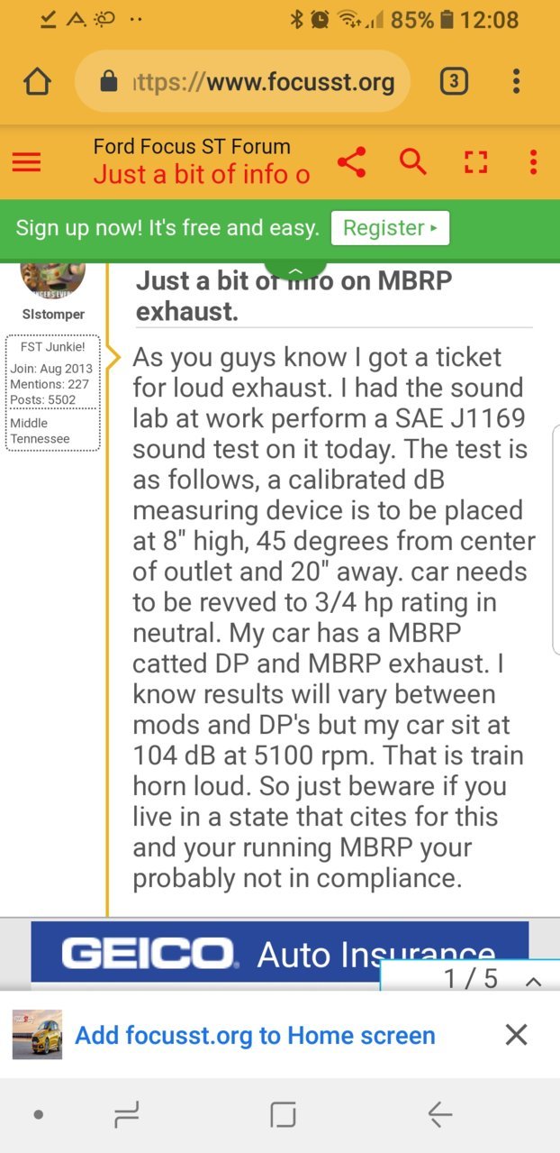

    Added: MBRP exhaust sound db from another forum..
    https://www.focusst.org/forum/focus-st-guides/33744-just-bit-info-mbrp-exhaust.html

    But a fellow TW member in the MBRP exhaust thread guided me this option. It kept sound below 95 db level without sacrificing the growl IMO. And the site said, "Not only does the DC Sports Exhaust Tip add a sweet spot to the appearance of your vehicle, it also gives it a resonating growl at higher RPMs."
    DC Sports EX-1011B Black Muffler Tip https://www.amazon.com/dp/B00GMNL36E/ref=cm_sw_r_cp_apa_i_i.itCbPPA12MX
