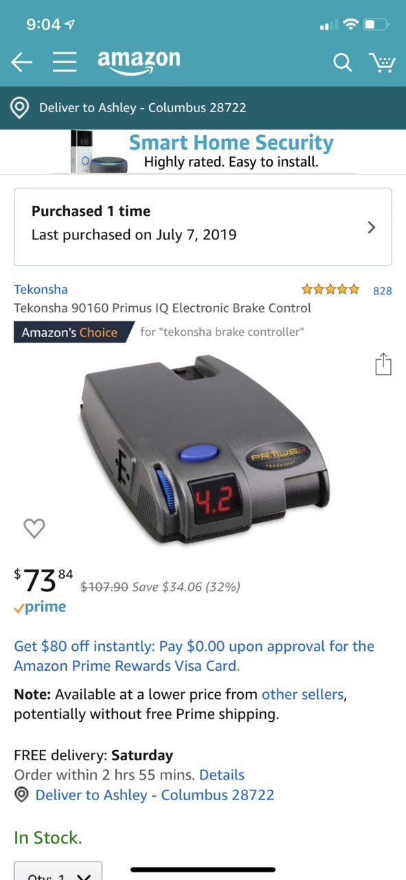

    I’ve read on here a lot about brake controllers but does it really even matter? As long as you have one what’s the advantage to the 150$ one over the 75$ one?

    @evansdmax For what its worth, I just went through all of this and settled on the tekonsha P3 brake controller. I have to start food plots and a bigger trailer and equipment had me scratching for a solution. Got the plug and play harness and was installed, done in 10 minutes. Not sure if there a cheap proportional controllers out there but I went this way rather than a time based controller.

    i went with the lower model one... will throw it on Saturday

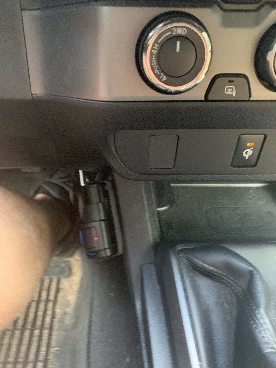

    Got the trailer brake controller put in not a real good spot for it but it will work!!
