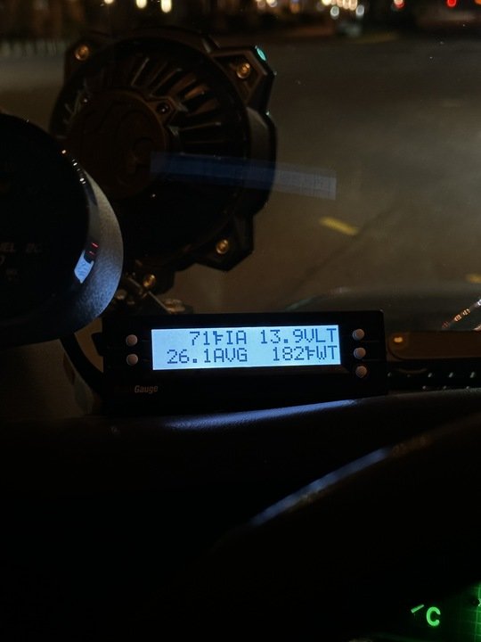

    To close the loop on this discussion, here is a photo of some vital metrics while test driving last night. These metrics are from driving about 6 miles total around town.
