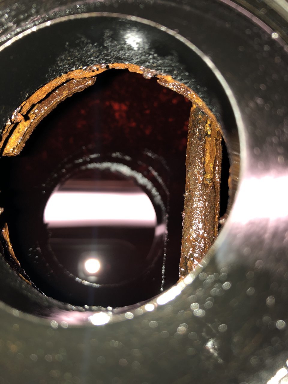

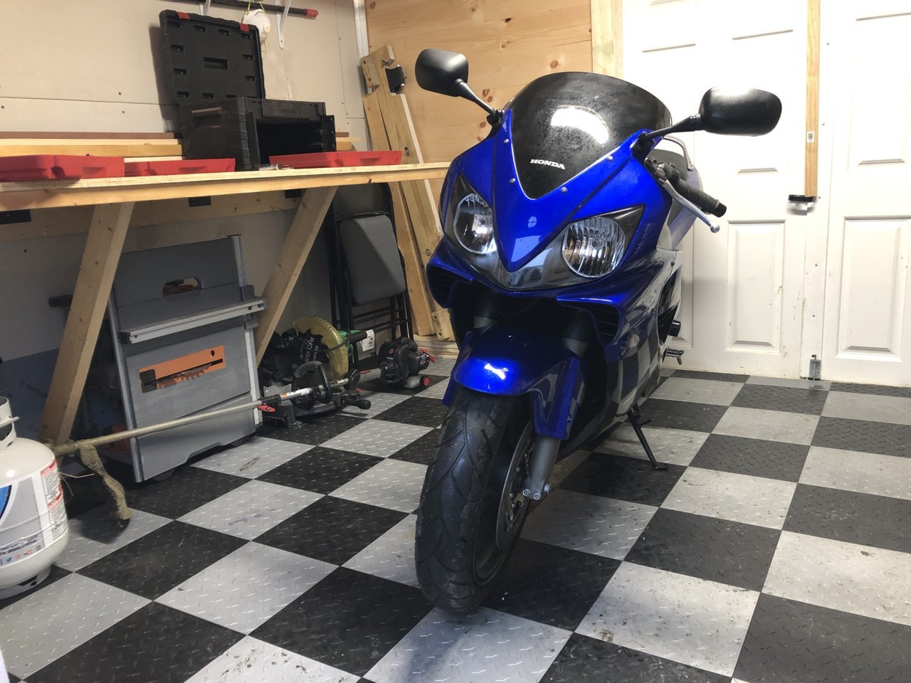

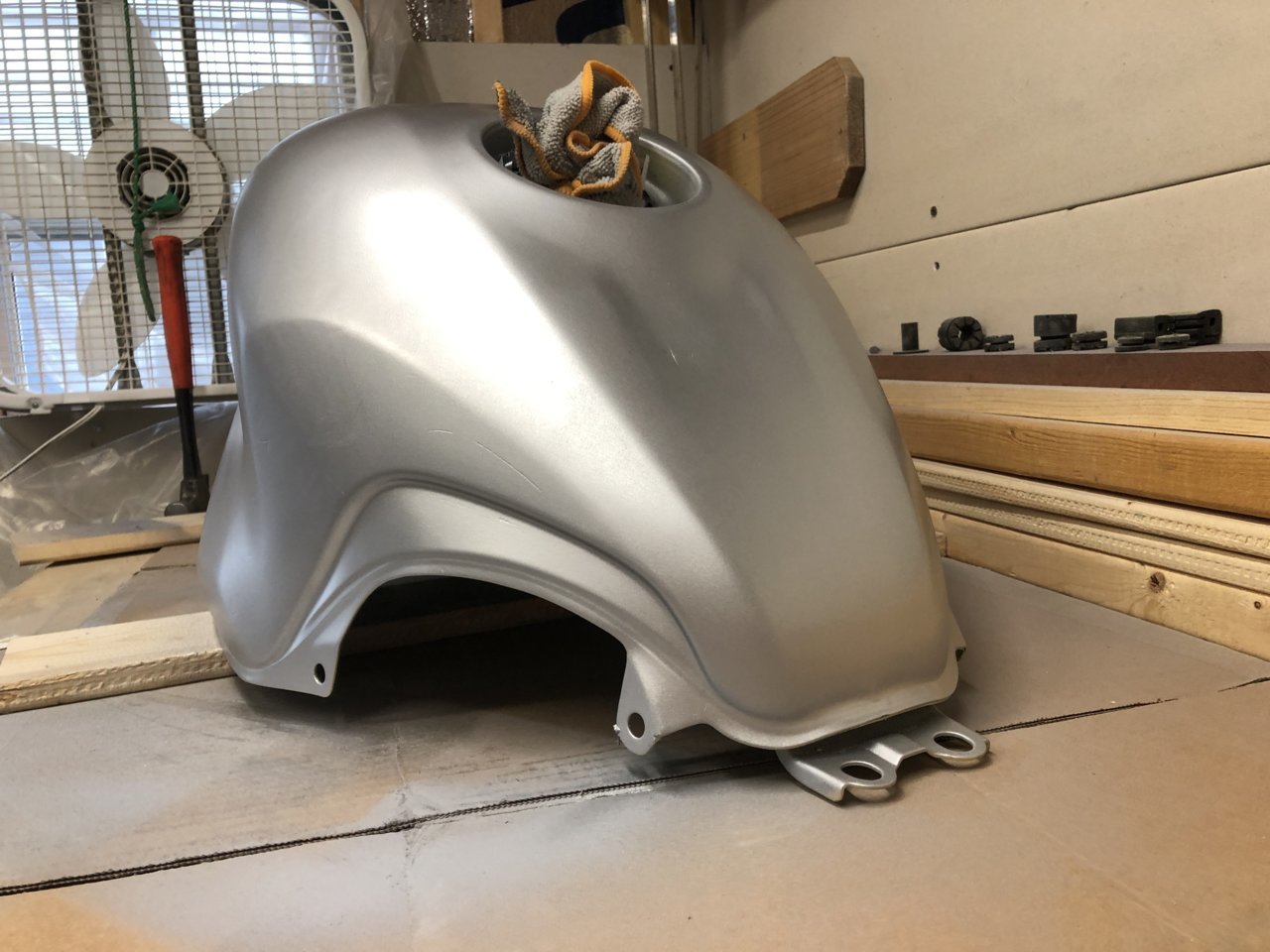

    I've been looking for a project bike for a while now and finally found it! Just picked up a 2006 Honda CBR600 F4i with 8700 miles on it. When I picked it up it was not running, but the bike was in overall great shape. While talking to the owner he told me that the bike has been sitting for over a year and would not start. I opened the fuel tank and wow, that smell! The fuel tank was almost full of rancid gas and the tank was a rusted as it could be without leaking.

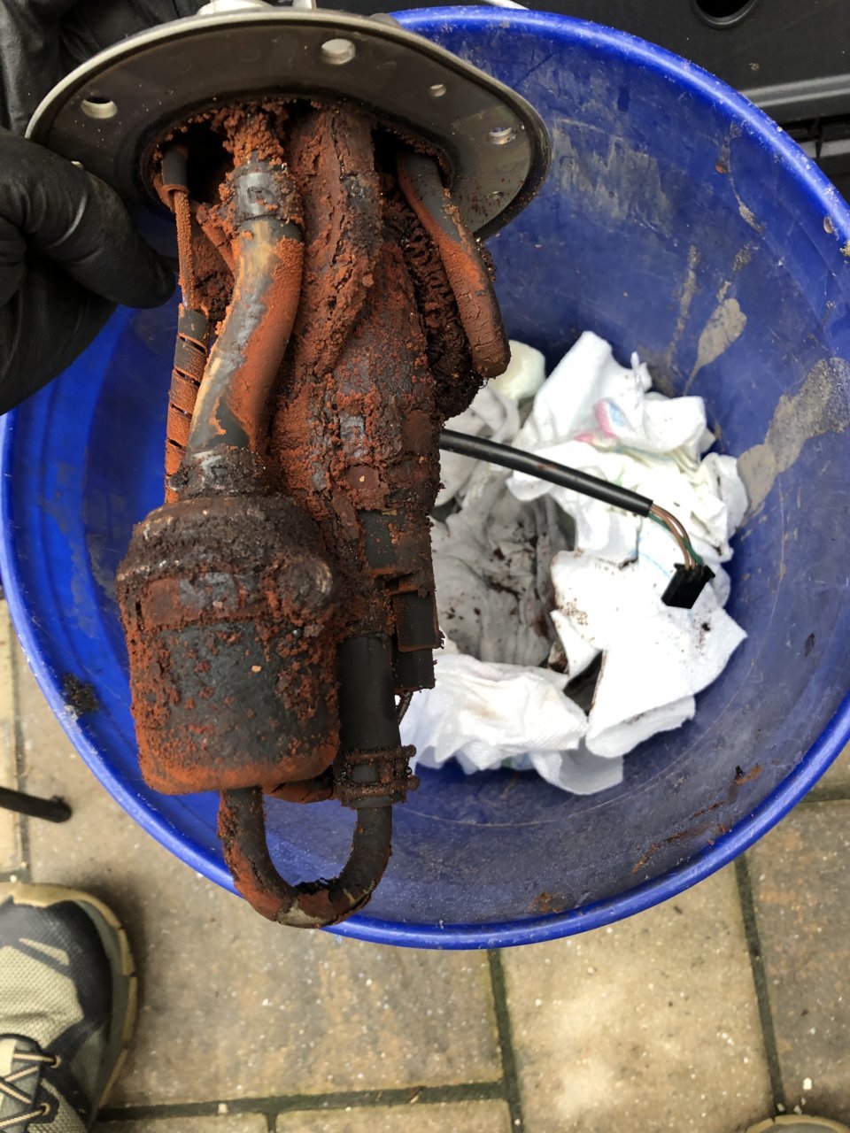

    My thought was, that this must be the problem so I took it home. Drained the fuel, pulled the fuel pump (inside the tank) which has a fuel filter. To my good luck I disconnected the fuel line to the fuel rail and the back flow was clean gas.

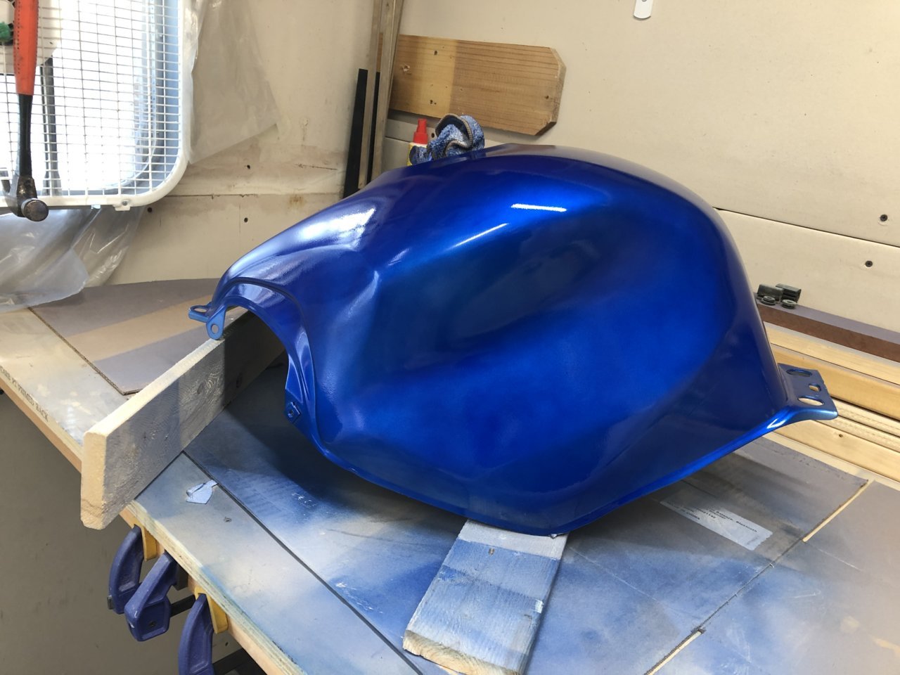

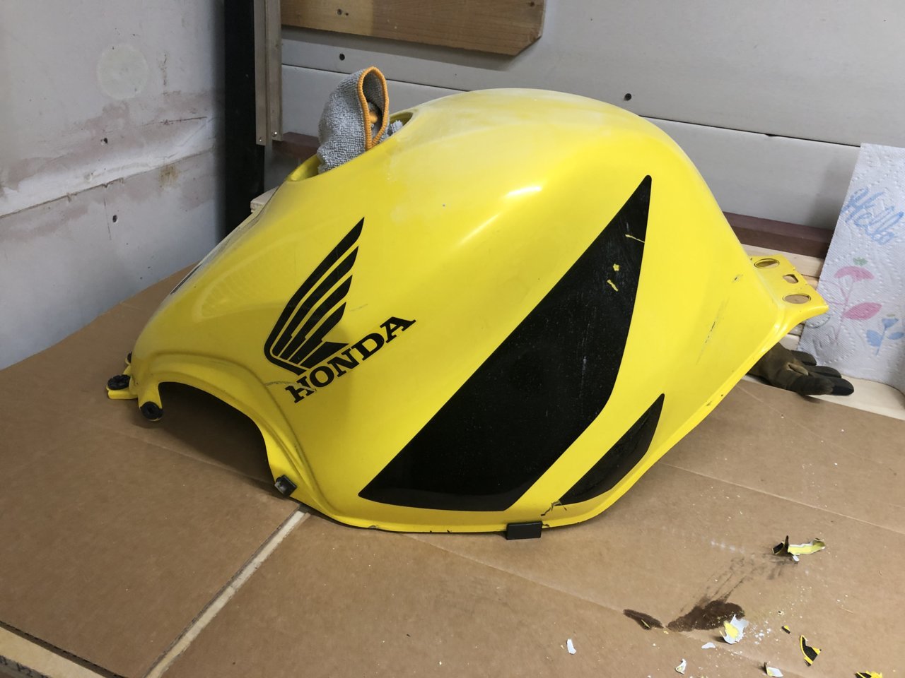

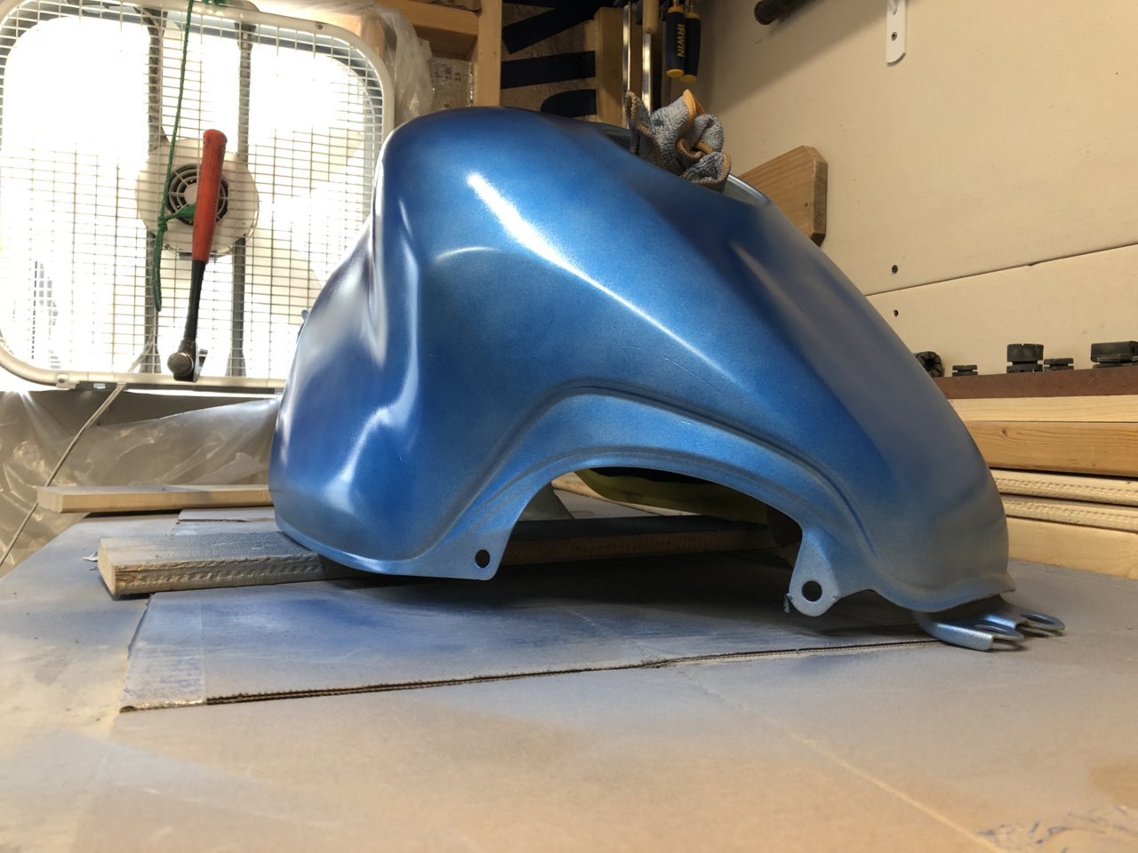

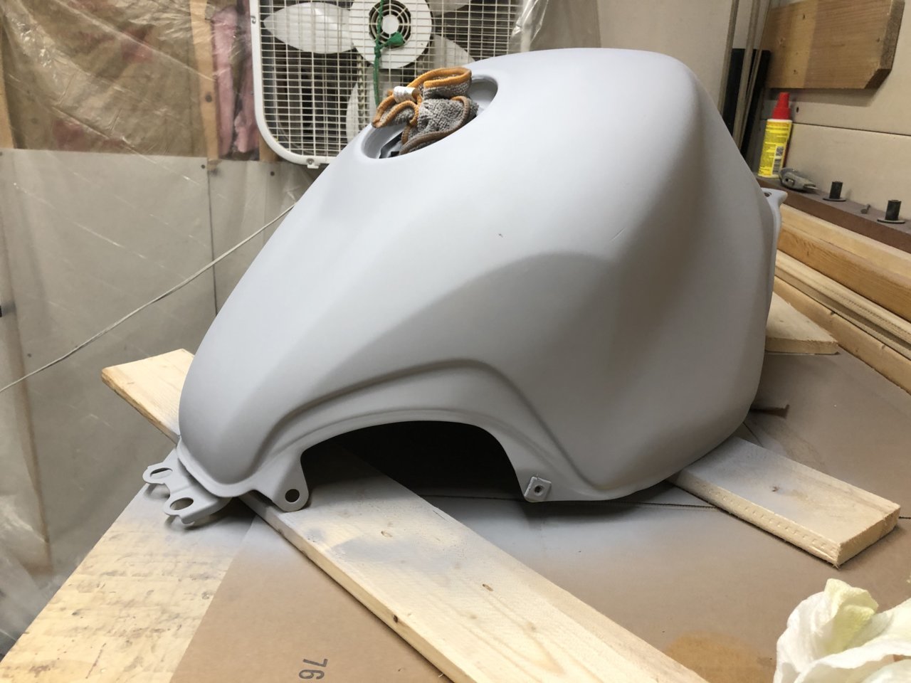

    Long story short, I ordered a new tank, painted it, put in a new fuel pump and it started up like a champ! This was supposed to be a winter project. It only took 6 days to get it up and running. Guess I need another project.
