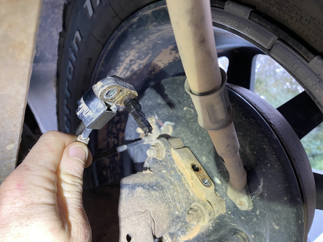

    I'm having the same deal going on with my 3rd gen right now. C1404 being thrown. Nice thick black gunk with some specks of metal shavings.
    Even if I unplug the wiring both wiring harnesses, I'll still get C1404 ('Malfunction in Rear Speed Sensor LH Circuit') along with C1407 and C1408 for open or short in the circuit.
    Based on both of these it's got to be a bad wheel bearing, right? I'll check voltages at the pigtails in the AM, but seems like I've got the wheel bearing blues.

    Given what I've learned recently, and the trash I see on your sensor like on mine, I'd wager a yes. Seems like a bearing to me

    Alright so I'm really lucky I didn't run the wheel off. Half the balls in the bearing were metal shrapnel. I can't believe it held together. Impressive, really
    Axle is back together, new brakes on both sides. For the first time in 3 years I don't have any lights on the dash. It's a miracle :rofl:
