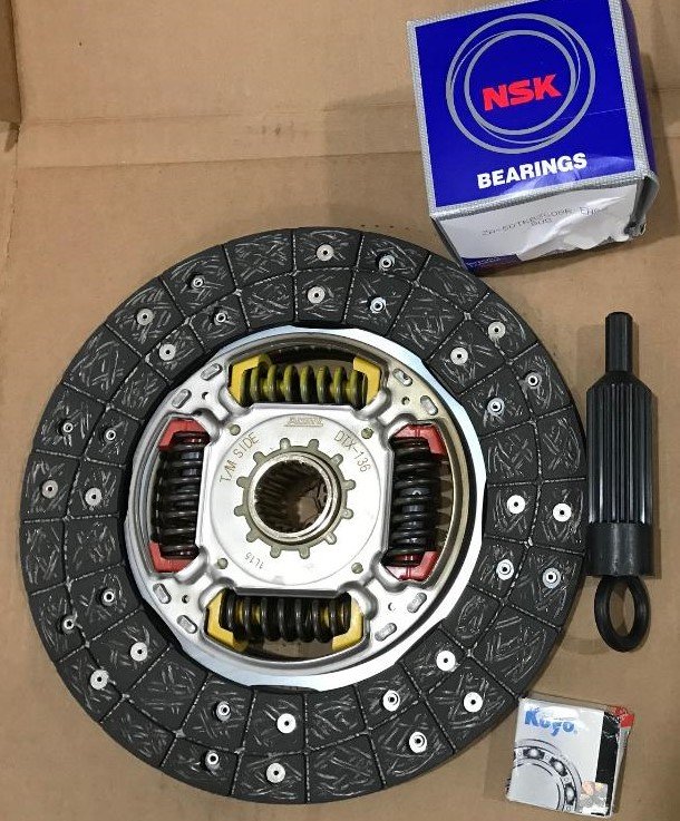

    The T/O bearing in the AISIN CKT-040 clutch kit I put in my V6 Taco last summer was an NSK JAPAN bearing, same as the original OEM Toyota T/O bearing it replaced. That is one of if not THE top-shelf JAPAN T/O bearing for the V6. Mine is quiet and super smooth. And same as you, I went with a new LUK flywheel and new OEM fork. Sure sounds to me like you did it right. Good luck with your problem.
