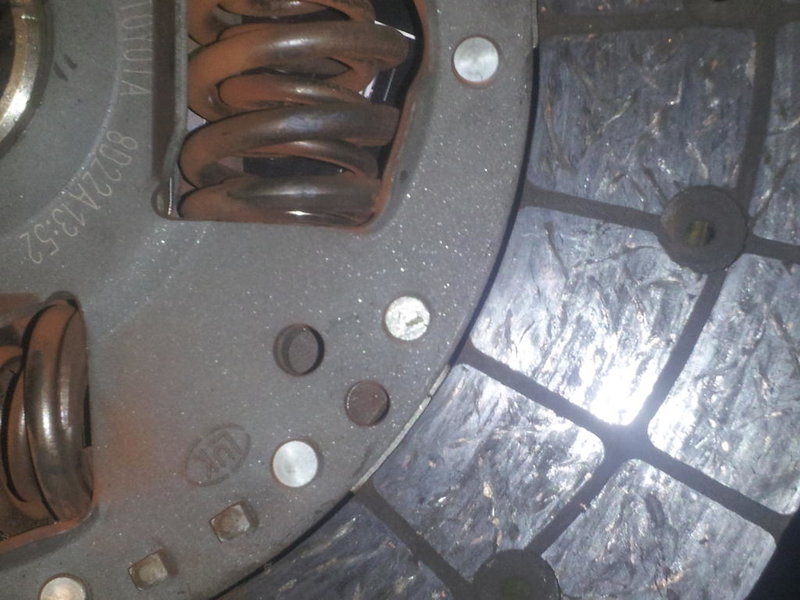

    It's high. Shop around. $350 for labor plus parts. I've used "perfection" clutch kits from AUTOZONE. I'll tell you what, they work well and last. (about $110) They have a stronger pressure plate and resist glazing over like the original LUK brand. There was still a lot of material left on my disc, but it slipped like hell. I'm sure that there are better, but not near this price.

    If that clutch plate is glazed, and slipping, but still plenty of material, then my money would be on a bad pressure plate.

    Yeah, I always thought that it was too easy. The design of this new plate is different and the push to the floor is about 40% stiffer. I like the feel much better than the stock set-up.
